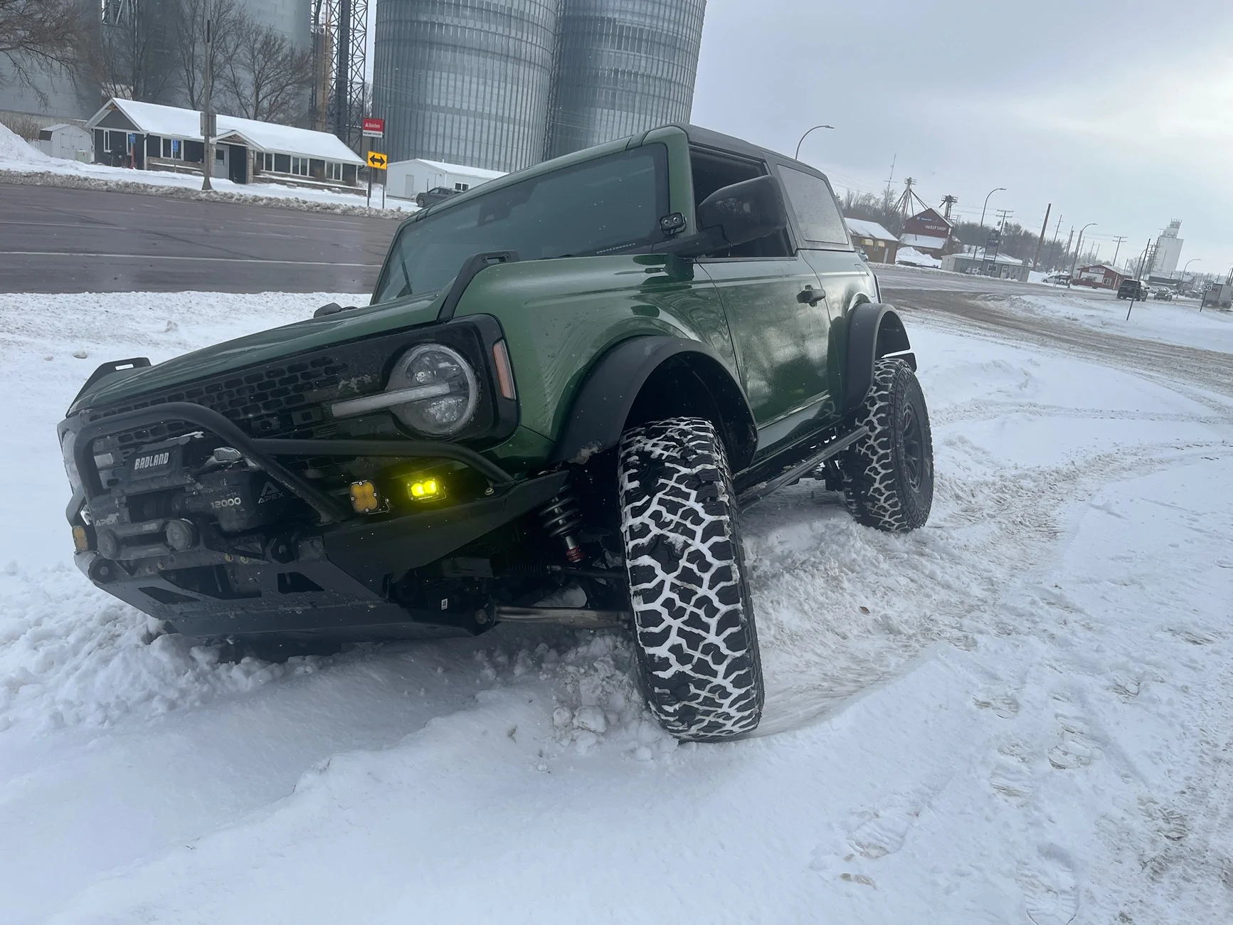

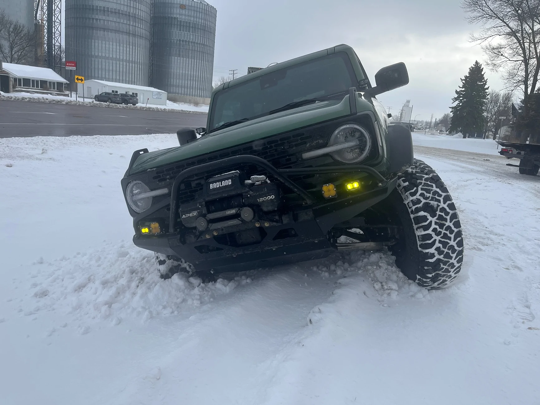

Just drove from CO to MN and back for some family business. Can confirm the Bronco signature LED headlights are prone to icing over in true MN style winter conditions.
Also, just for fun I’ll add this ancient proverb….”Never trust a Minnesota ditch in winter”.
Ha ha ha. I pulled over at a gas station to fill up, then decided to park out of the way so I could go inside and use the restroom. I saw what I thought was a flat section of ground and thought “oh I’ll just park there”. So yeah…that was a fairly sizable ditch that the wind had filled with snow. The flat light got me. I knew I was boned immediately. Put the truck in park and suddenly I realized there was a tow truck guy sitting in his truck right next to me. I looked over and he waived, and we both laughed. 10 mins later I was back on the road. This is why I always carry cash. Ha ha ha.
