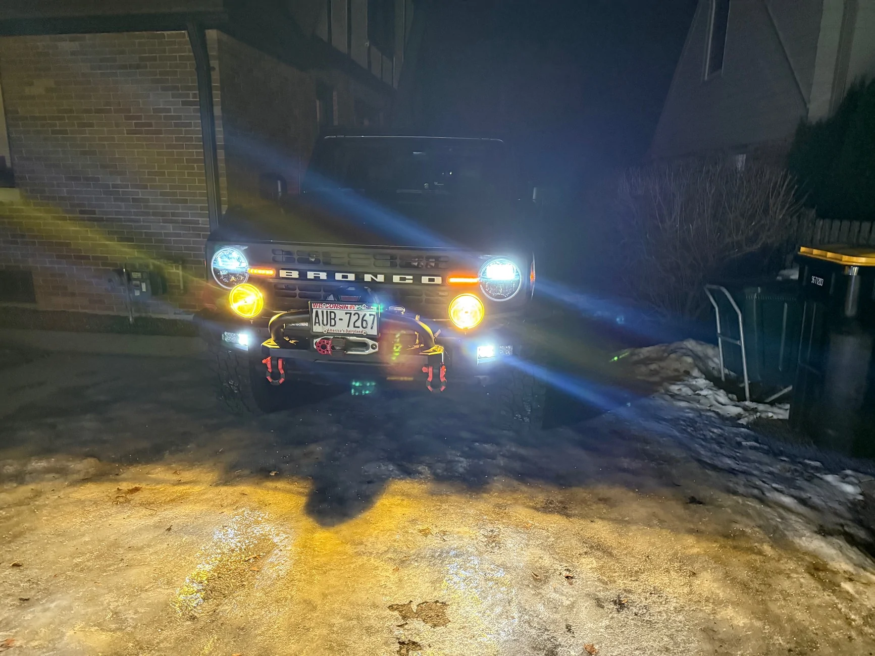

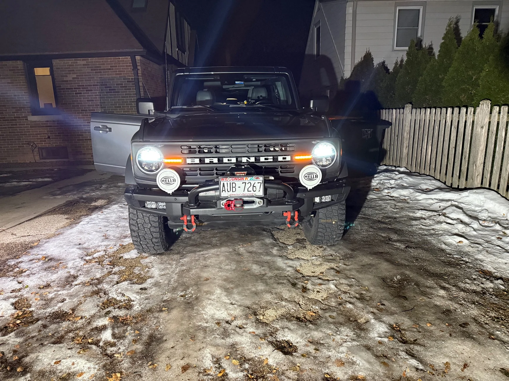

Solved for now. I used Aux switch 2. I made my own harnesses using Mil Spec Tefzel wire, 12 AWG to the bumper, 16 AWG to each light. Wrapped the harnesses with spiral wrap with an additional outer layer of fiberglass sleeve (on the portion outside the engine compartment) for appearance. From the bumper forward I zip tied to the FP winch cables. DT connectors at the lights.
