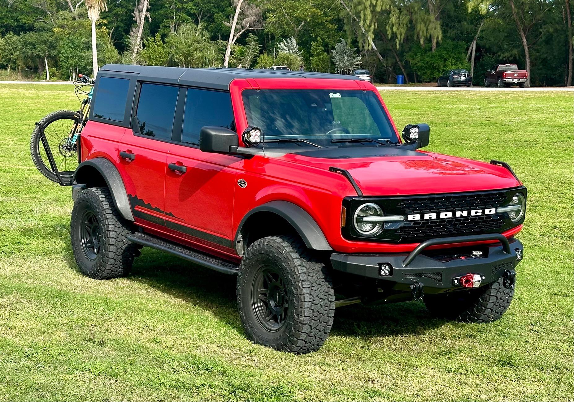

Here’s my 22 Wildtrack with zero offset Method rims and factory 315 size (35”)Toyos. Pokes out just past the stock SAS fender flares.
