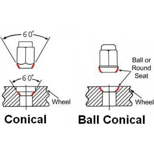

The Gorilla multi-spline lugs are what I use. Very low profile. They also work like lock nuts. Any professional wheel thief can zap them right off, just like lock nuts. But any amateur trying to steal your spare will struggle.
There are a few different types of lug nuts seats, the two most common being conical and ball conical. They have other names like acorn, ball, etc.
Ford Bronco Advice on Method rims 1719841631733-z7
So that is consideration #1, making sure you have the correct seat for the aftermarket wheels.
Then obviously thread pitch and size for the studs/ wheel bolts.
Then thread engagement. I want an absolute minimum of 6 turns of the lug on the stud. I'd prefer much more than that. The lug nuts don't really hold the wheel on, the friction between the hub and the back of the wheel does. The lugs just keep that contact point firm.

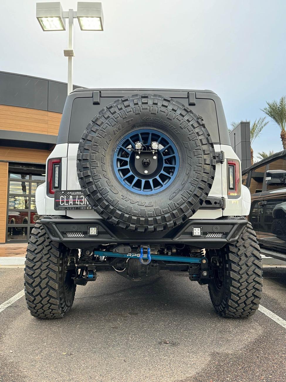

The 703's are what I was looking at. I was confused on the spacer thing, but this is what I'm thinking now. I wonder if I went positive 35 then I could go with a spacer if I need one (I'm cutting the crash bar mounts off soon). I think that was what I meant to say yesterday, because a spacer on a 0 offset would be pretty wide! And I don't want wide.
https://www.methodracewheels.com/co...cts/703-gloss-titanium?variant=39550687903805
I love my beadgrip wheels. There are no issues with lower PSI, and I think Method makes great-looking wheels.
