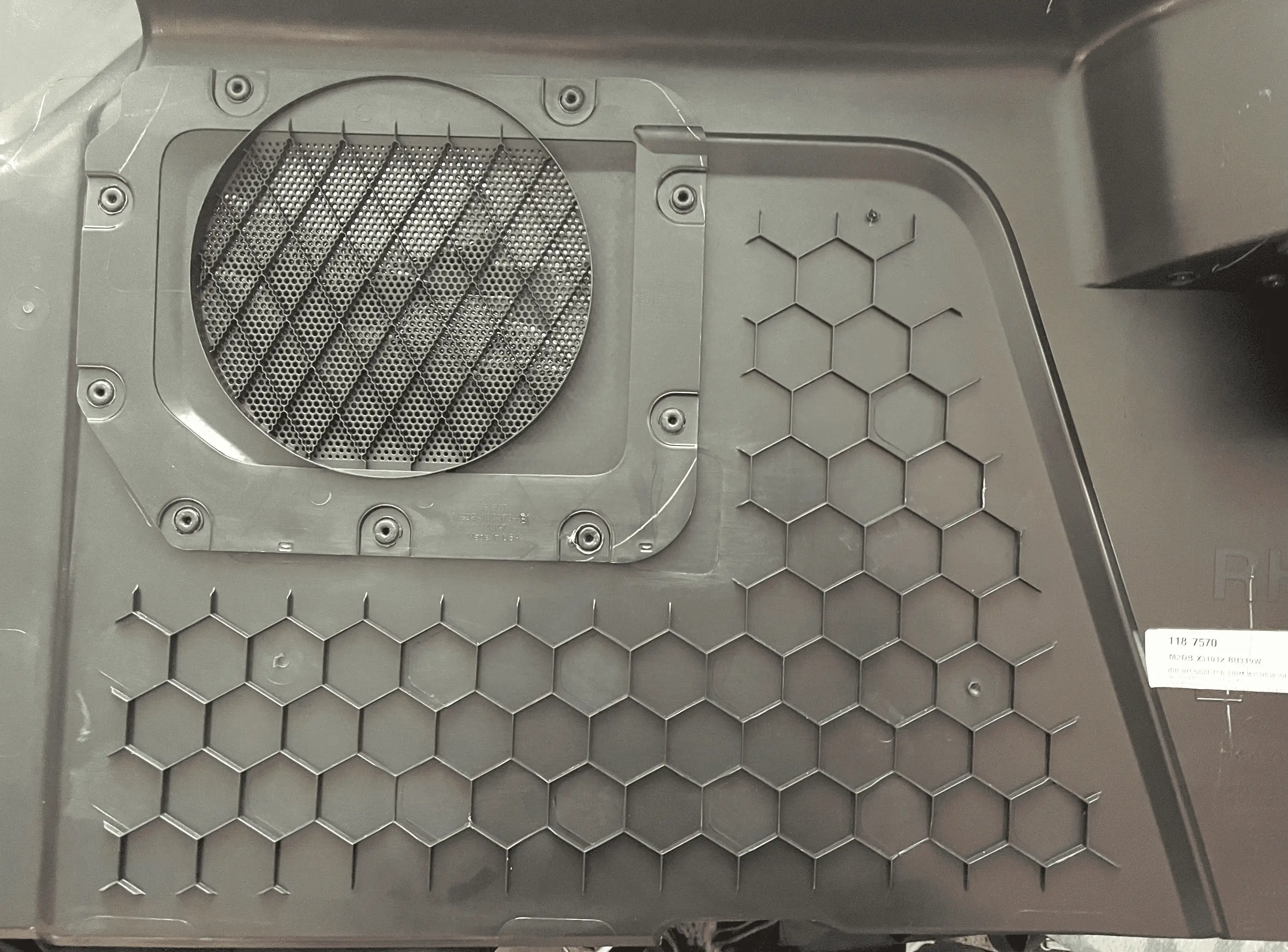

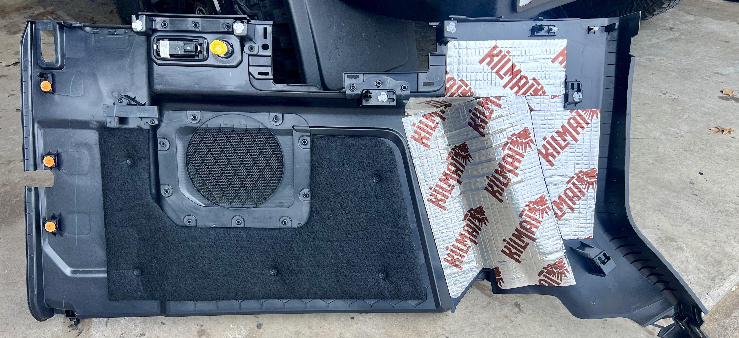

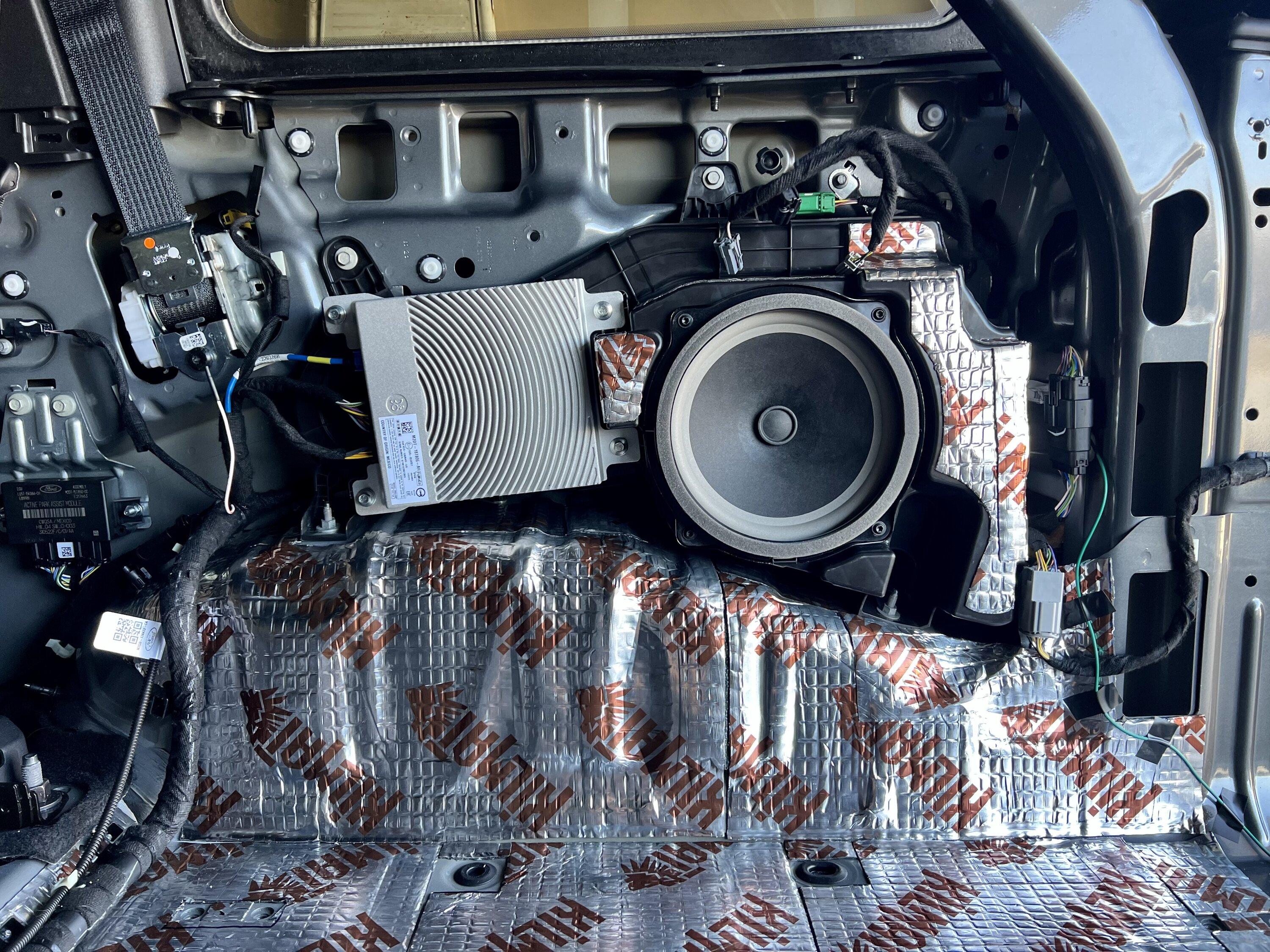

Using these images as guides - looks like the idea is "the more the better".....
Ford Bronco 2023 Bronco Total Speaker Upgrade Notes BnO
And also put some inside the panel itself... -
Ford Bronco 2023 Bronco Total Speaker Upgrade Notes BnO2

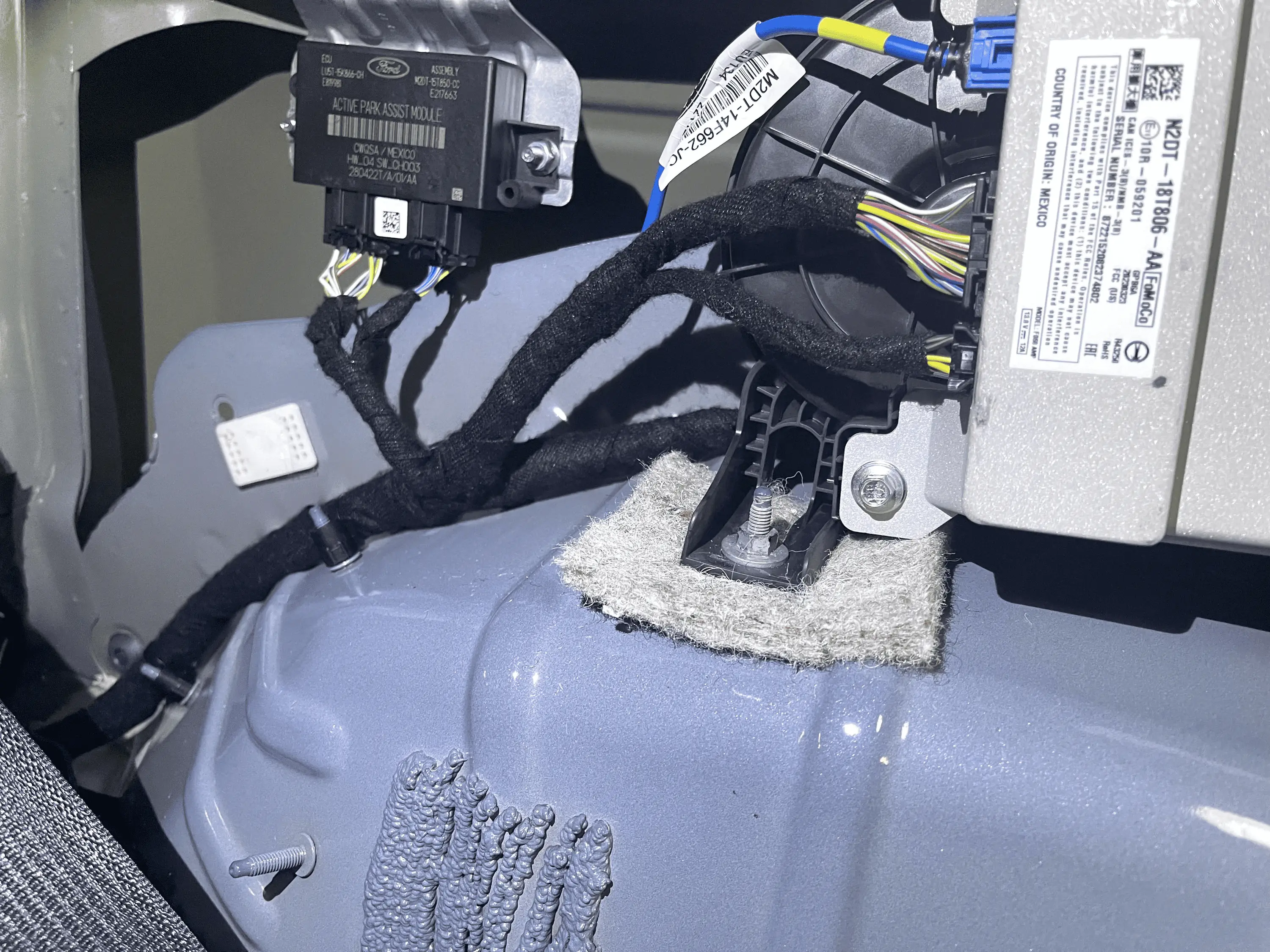

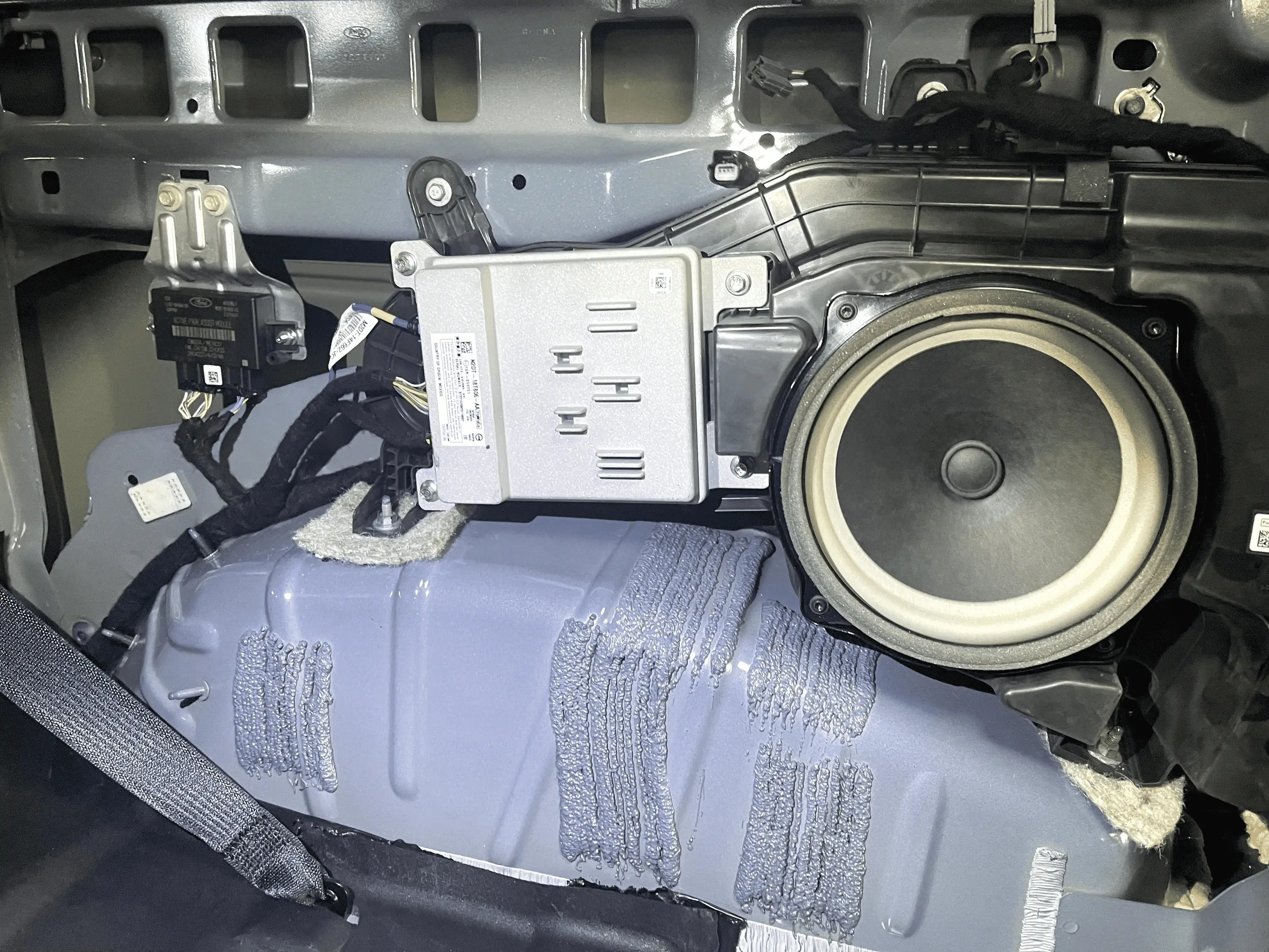

Oh, so THAT'S why it rattles!
Opened up the panel on my '23 Badlands and noticed the sub assembly is screwed into two 4''x4'' pieces of cloth?
ALso, ZERO dampening on the panel on the speaker side.
