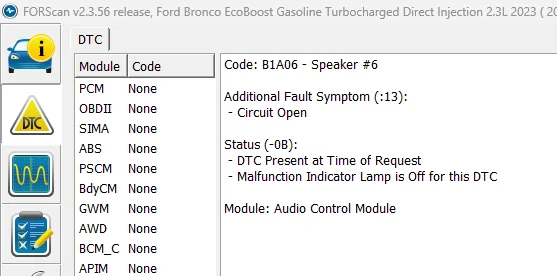

I just did the same speaker swap on my 2023 Big Bend, and have been very pleased with the big difference it made. However, my battery light came on a few days later and the Ford app told me it was a "charging system fault'. So I plugged in FORScan to get a DTC and was given the following:
Ford Bronco 2023 Bronco Total Speaker Upgrade Notes DTC
I went with the exact same Kicker speakers and 200.4 amp mentioned at the beginning of this thread, with the only difference being a Ford Fusion amp plugged into the factory sub harness. None of the factory wires were cut. I used a headunit harness for the 200.4 amp, pigtails for all speakers, and reused the factory harness for the sub that was on my dummy one.

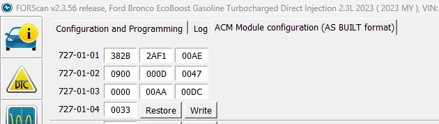

I'm convinced it's the ACM changes I made and it's as simple as me mistyping a very obvious variable in the 727-01-01 or 727-01-02 strings. Here's what I currently have everything set to:
Ford Bronco 2023 Bronco Total Speaker Upgrade Notes ACM
Any help correcting this would be greatly appreciated!
