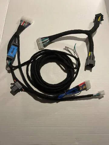

This is the one I currently have:
plugandplaykits.com said:
KIT 11-1 KICKER KEY 180/200.4 HARNESS ONLY $225
Ford Bronco Subwoofer wiring harness for Kicker amp 1753158636396-d9
But since I want to upgrade my sub and I'm bypassing my A2B sub wiring, would this be the kit I need to swap it with?
KIT 11-4 KICKER KEY HARNESS 180/200.4 ONLY WITH 17 FT HIGH LEVEL INPUT CABLE WITH LOAD RESISTOR FOR SUB AMP POWERED SUB INSTALL $ 275
Ford Bronco Subwoofer wiring harness for Kicker amp 1753158743203-l6
Or would I need this one? The images look the same to me, but the description and prices are different. The first one says it has a load resistor, but I don't know enough about this stuff to know if I need that or not.

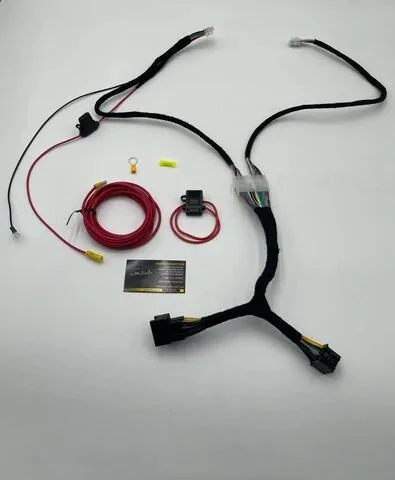

KIT 19 -1 KICKER KEY 200.4 AND KICKER KEY 500.1 17 FT PLUG & PLAY HARNESS ONLY. POWER & GROUND REQUIRED FOR 500.1 $285
Ford Bronco Subwoofer wiring harness for Kicker amp 1753158911692-3g
Or am I on the wrong track here and in need of something else entirely? Maybe I just need something like this and some wire?
