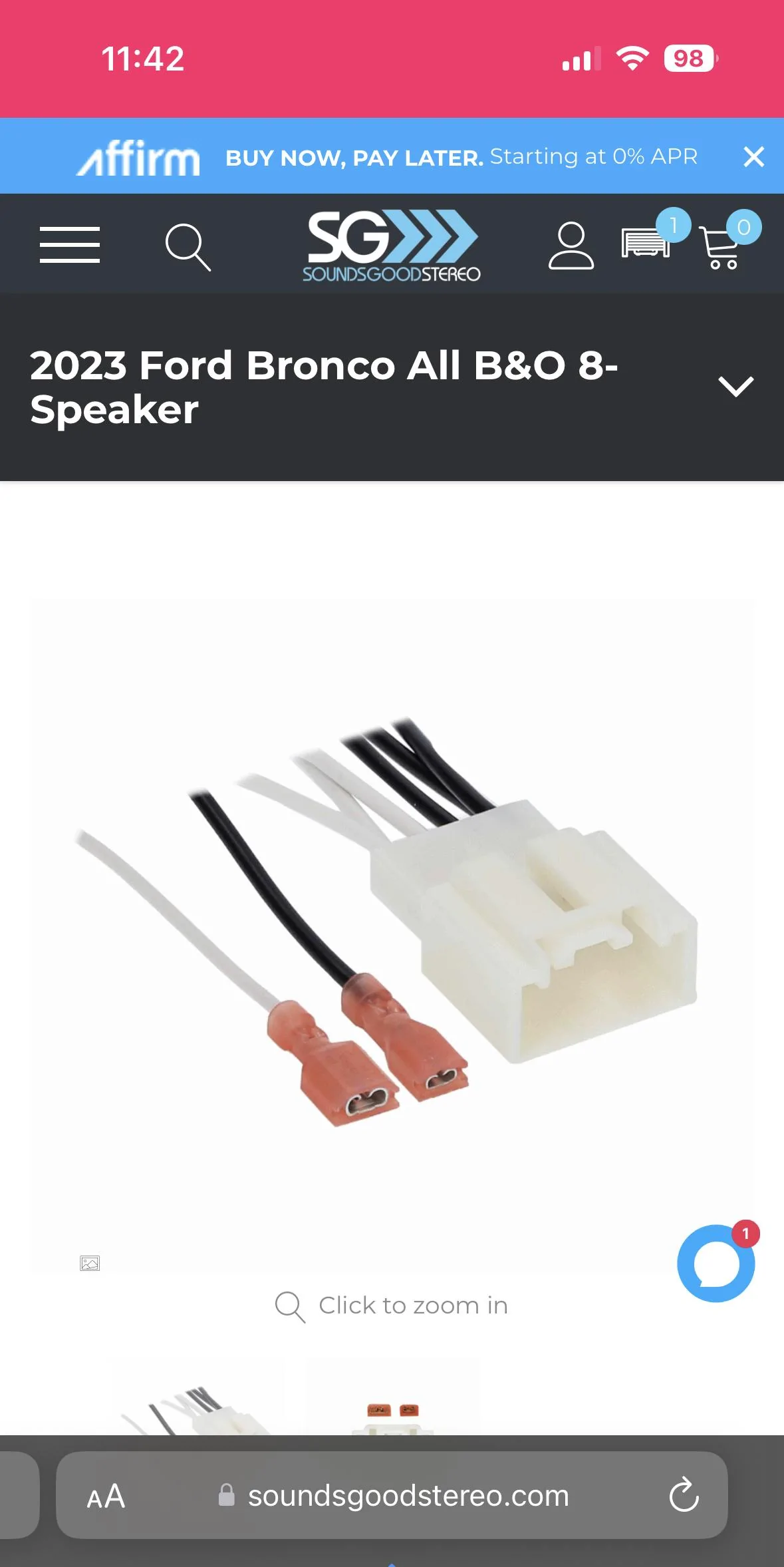

So I got the bronco speaker kit from sound good stereo
https://soundsgoodstereo.com/products/custom-6-5-inch-speaker-adapters-fits-2021-ford-bronco-6th-gen-front-kick-panel-location?utm_campaign=Spently Shipment Delivered Email&utm_medium=notification_email&utm_source=spently
so my question is- the wiring harness I got had 4 wires- 2 positive, 2 negative.
In the photo it shows 2 wires🤷🏻‍♂️
Which ones do I use? since my speakers only have one +\- connection? I’m assuming the other wire set is for another set of speakers off the kickers? Can I cut them?

The kick panel speakers and the dash speakers share the same audio channel, which is why there are four cables. Two feed the 6.5" speakers, the other two feed the 4" speakers in the dash.

Ohhhhh... the B&O system. The B&O speakers have their own separate channels.
I am 90% sure you only need pins 1 and 4 on that connector.
If you are worried about that 10% uncertainty... just test it before you snip the cables. Or simply connect pins 1/2 together, and pins 3/4 together and you'll be good to go.

Couple videos I’ve seen with wiring harness seems to have the center cables looped back down. Not sure if that for a reason or what. I just wanna make the harness once.

Ford Bronco Kicker speaker,  wiring harness ? AF0DD521-A885-4176-B920-430911AB3770
I just found this on their site, I got the kit.. however looks like the 1 and 4 pins have the wires looped back to it self? Is this doing anything? Not really a jumper/. So confused for what should be simple

We can close this thread.
i said F-it. And took the panel off to see what I had to work with. Factory connections were just 2 wire at pin 1 and 4.
cut the other wires in my harness solders the harness to the speakers and bam. Upgrade done.
