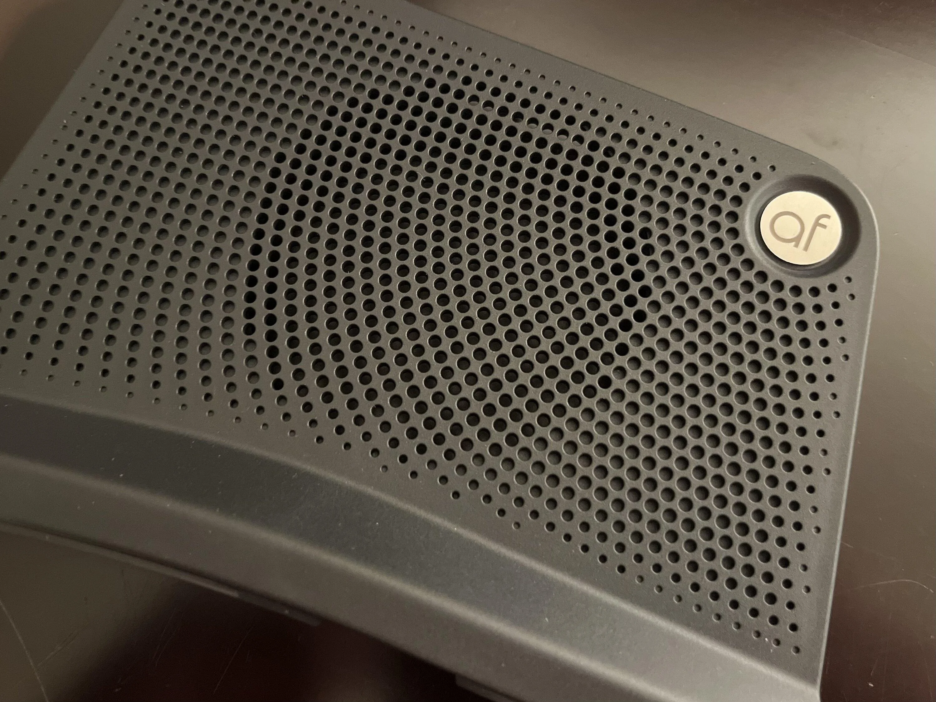

Another little something I’m working on. Since this Bronco is not (and never was) B&O, it will have Audiofrog badges on the dash grilles. Mocked-up for now, still have to figure out a permanent mounting solution.

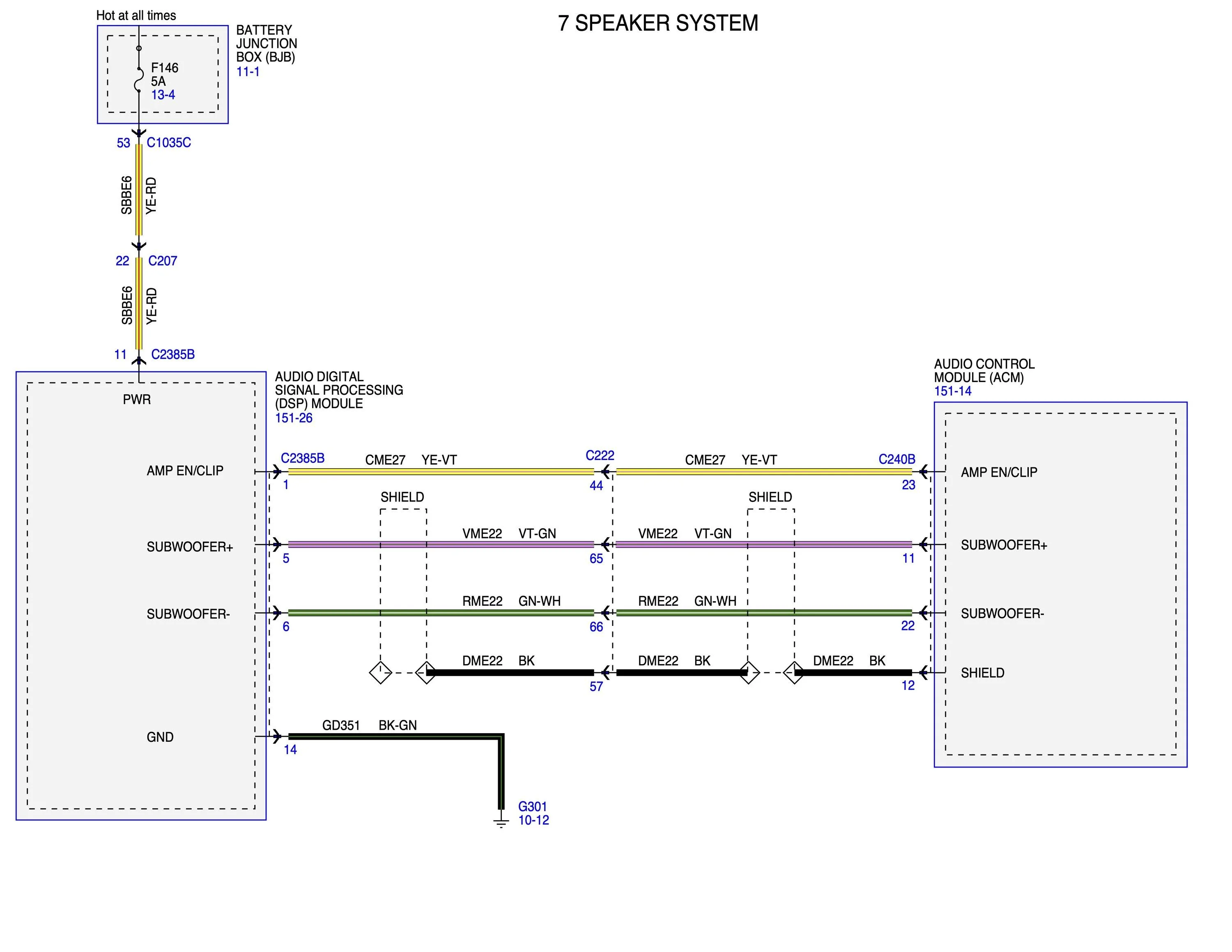

Since I’ll be using the add-on Bluetooth module available for the V8, I will need a remote turn-on (signal sensing turn-on only works with the factory head unit’s speaker input).
Instead of running a little blue wire all the way up to the fuse panel, I decided to pick up the power Ford uses to turn on the factory subwoofer amplifier. This presented a couple of problems: 1) the switching signal Ford uses is ~6v, the V8 requires a 12v signal and 2) I needed a receptacle to keep from cutting the factory wiring.

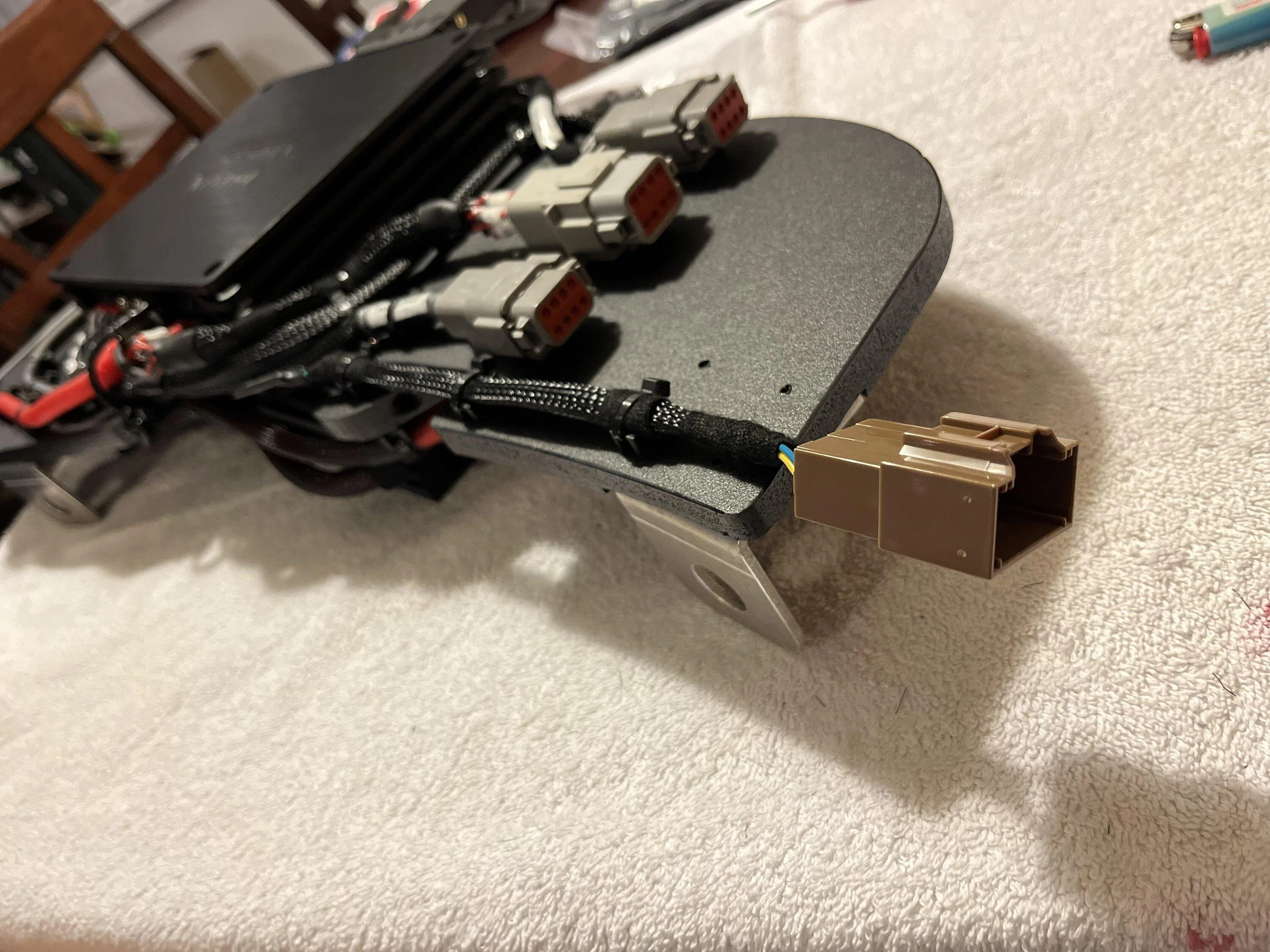

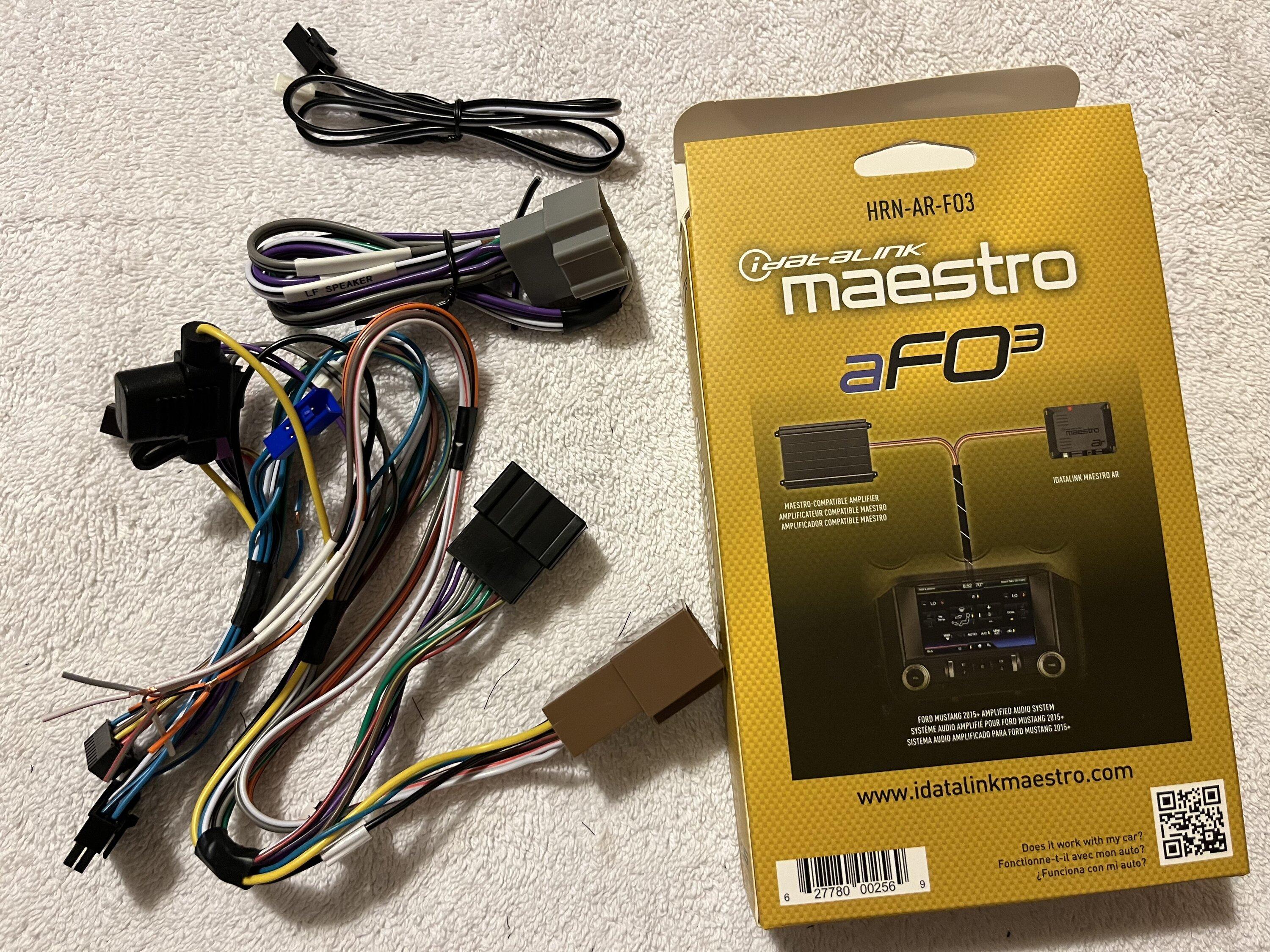

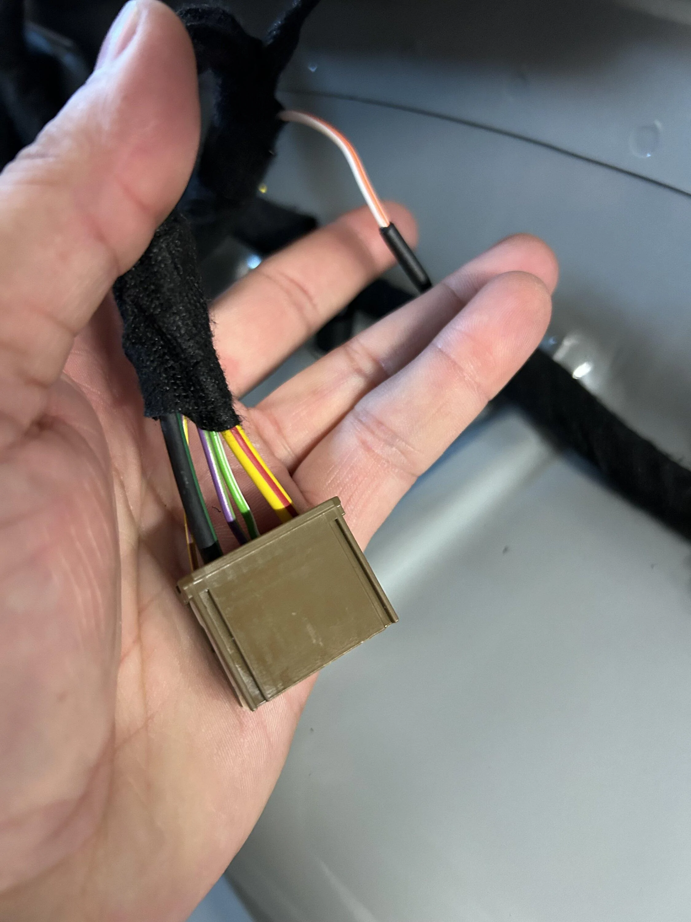

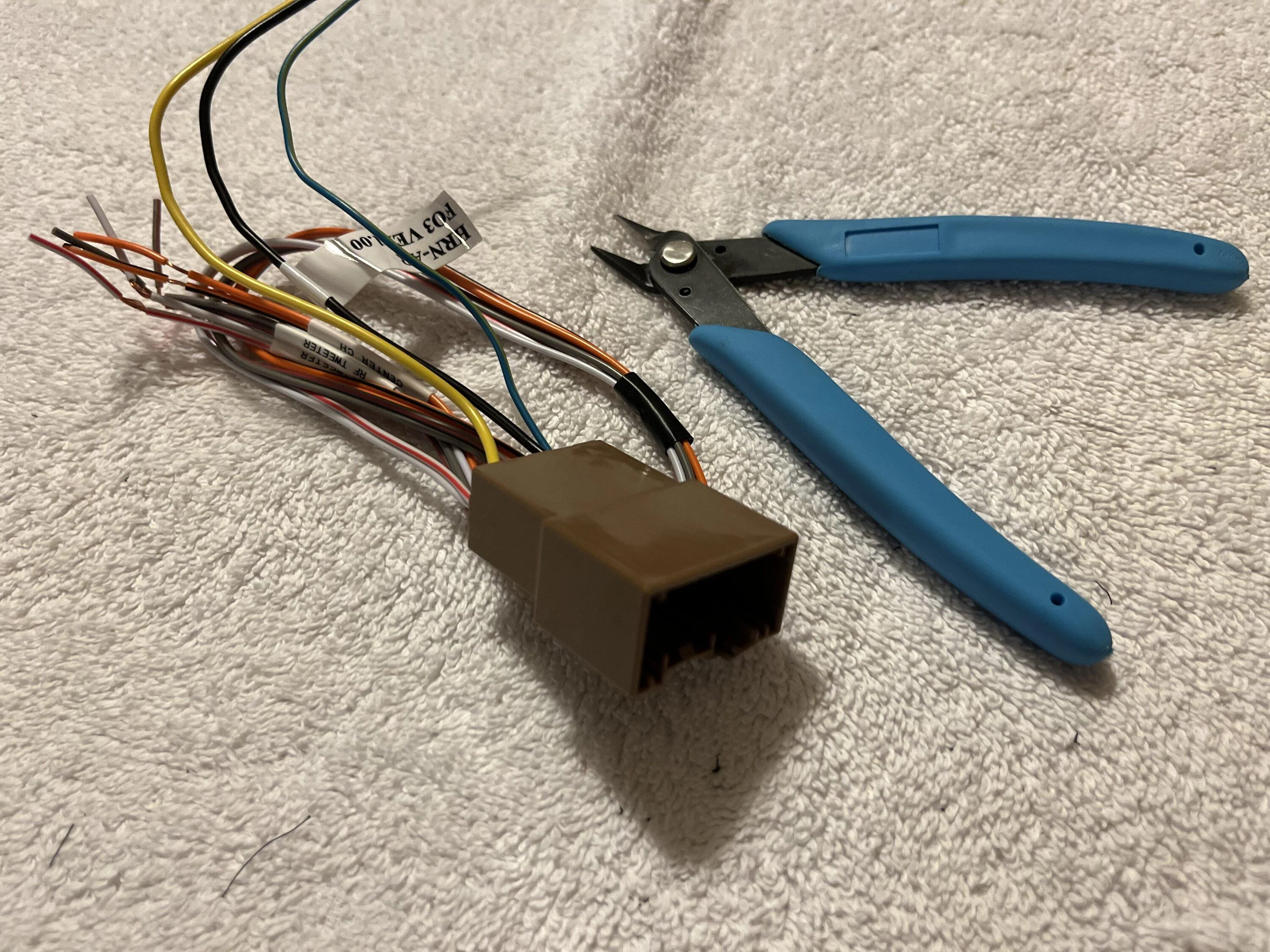

The signal I need is in the big, brown connector that plugs into the factory sub amp. I capitalized on the fact that Ford uses the same connectors across multiple models and found an adapter for a Mustang that fits perfectly.
Unfortunately, the connector is otherwise very difficult to find (and expensive when you do), so I snipped it out of the harness.

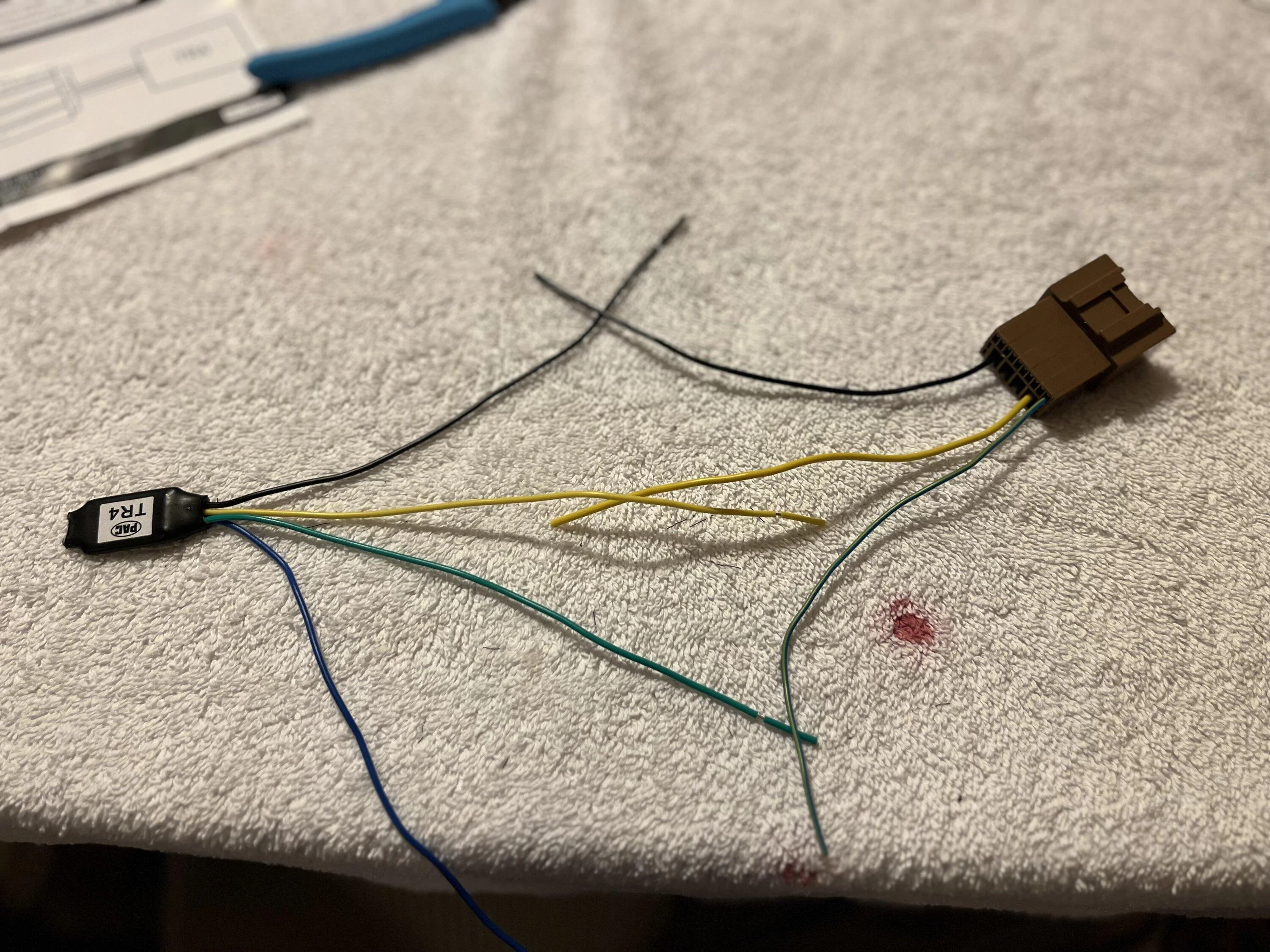

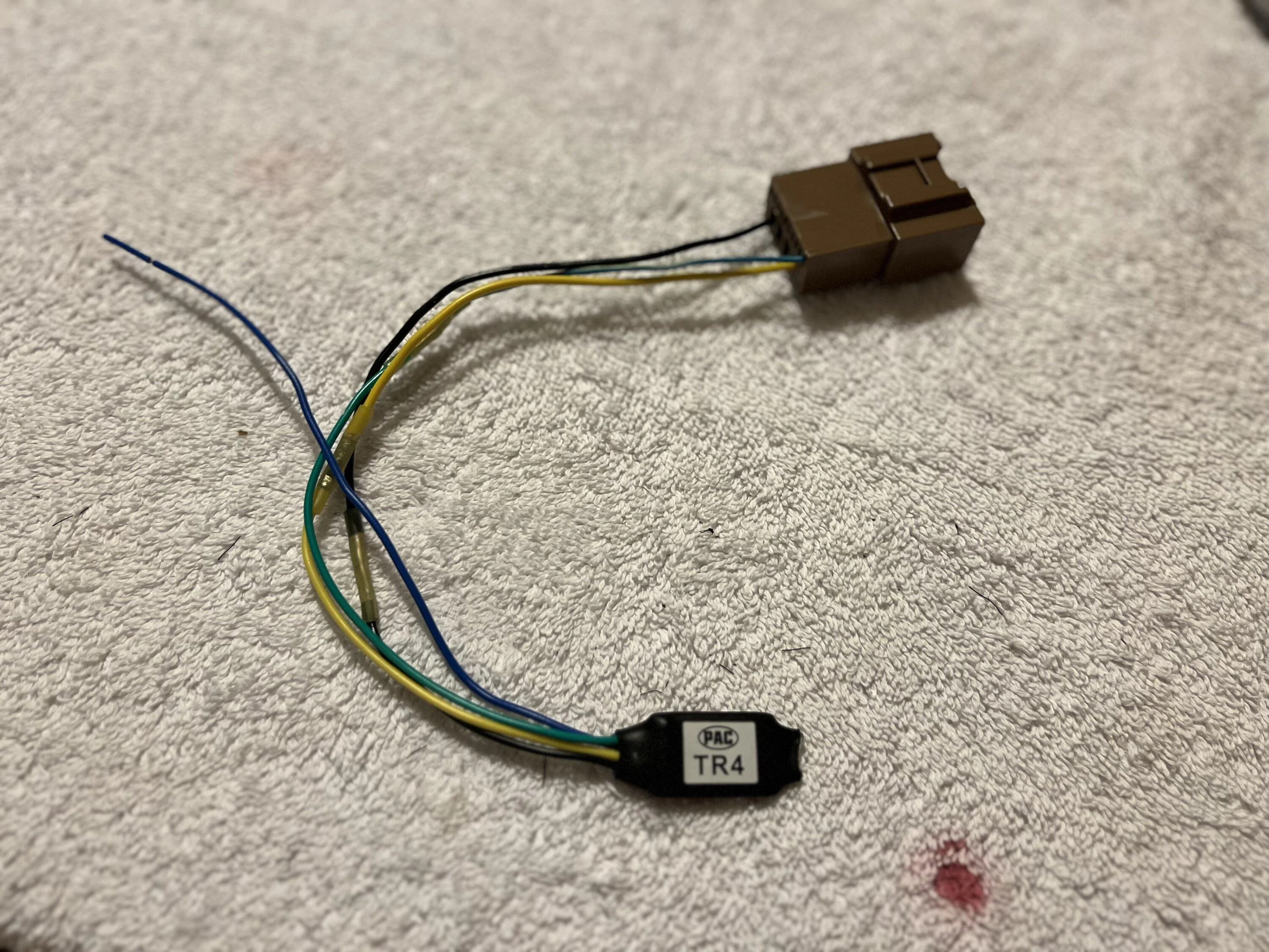

The next piece of the puzzle is converting the low voltage turn-on signal to 12v, which is exactly what the PAC TR4 is designed to do.
Everything I need to connect to is in the big, brown connector: 6v signal, 12v constant, and ground. After removing the unnecessary wires (and switching a couple of wires around to match colors), I joined the connector I snipped from the Maestro harness to the TR4 and routed its 12v switched output to the amp.
Now, the V8 (and daisy-chained M1X) will turn on and off just like the factory subwoofer amplifier, so it will work any time the stereo is on, including key off, accessory on, and retained power after shutting down until opening the door.
Plug-and-play. Win.

Is the factory harness powered for 12v and turn on without forscan?
gringoloco
gringoloco
May 13, 2022
219
193
Alabama
2023 2-Door
2023 7-speaker, yes. 2023 with subwoofer delete I believe will need FORSCAN to enable power.

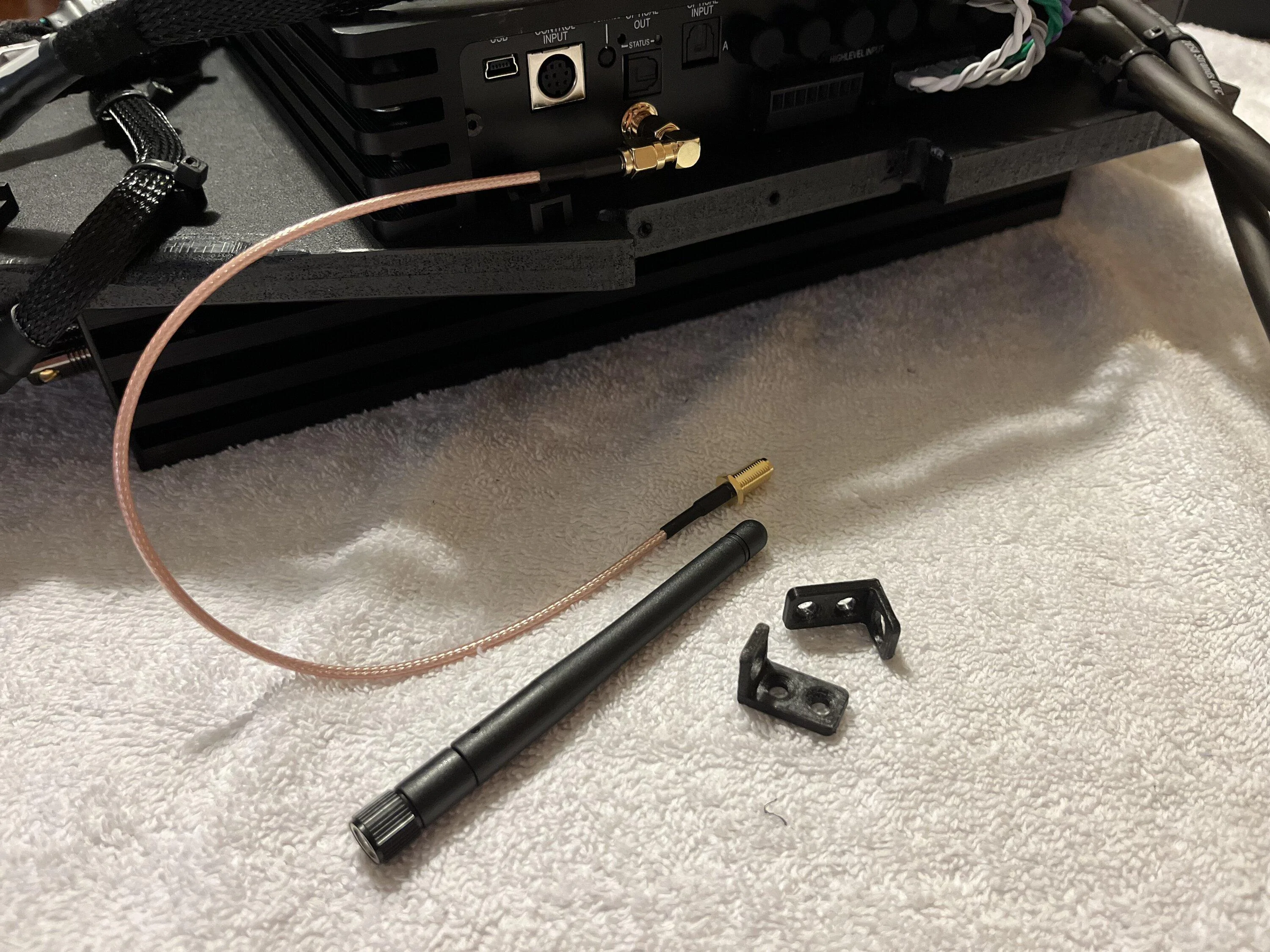

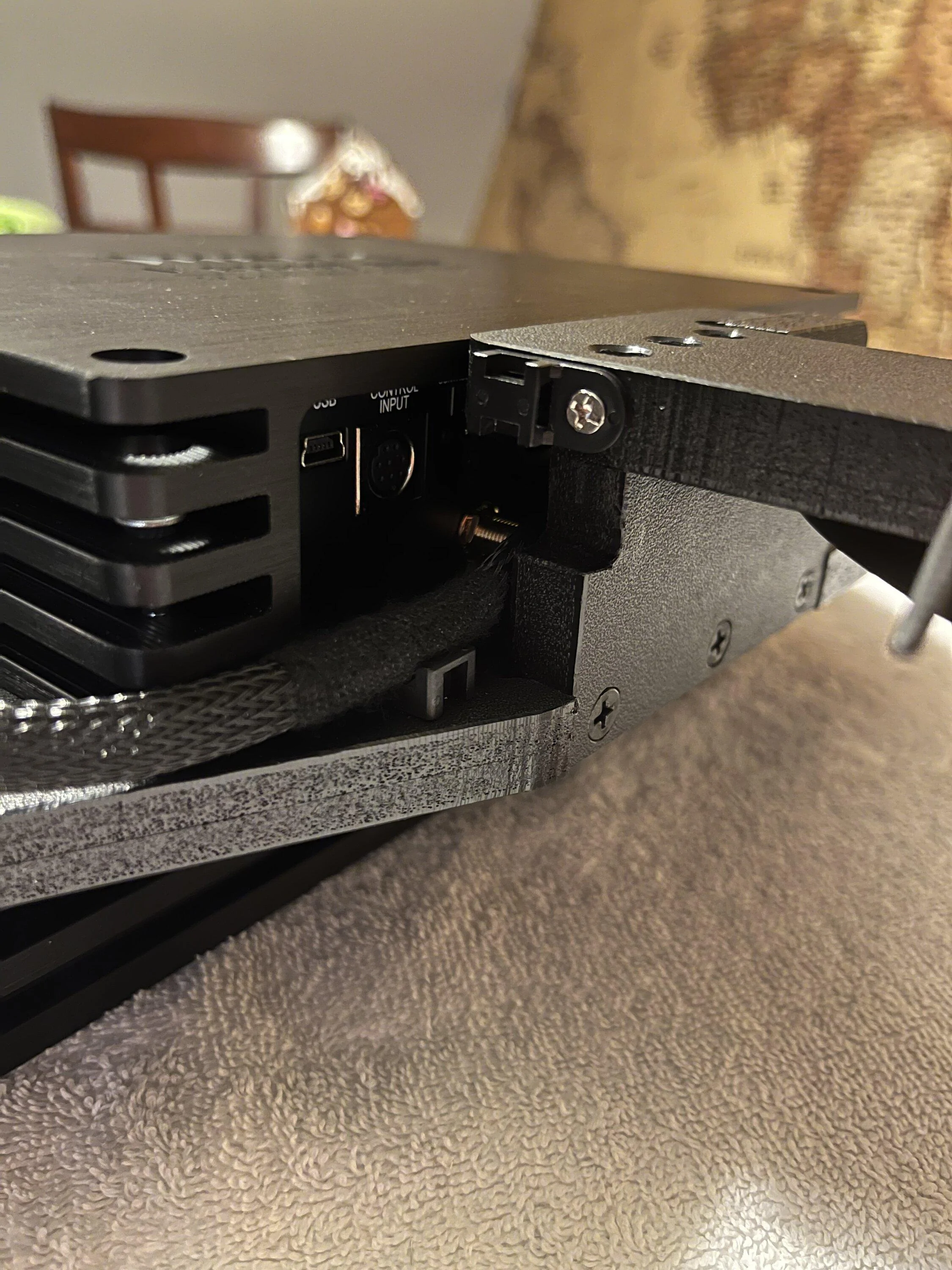

Still chipping away at it. Got the Helix Bluetooth module installed, but the antenna doesn’t fit. Simple solution is use a coax extension and 3d-print some antenna mounting brackets. Antenna will get remote mounted once the amps are in place in the vehicle.

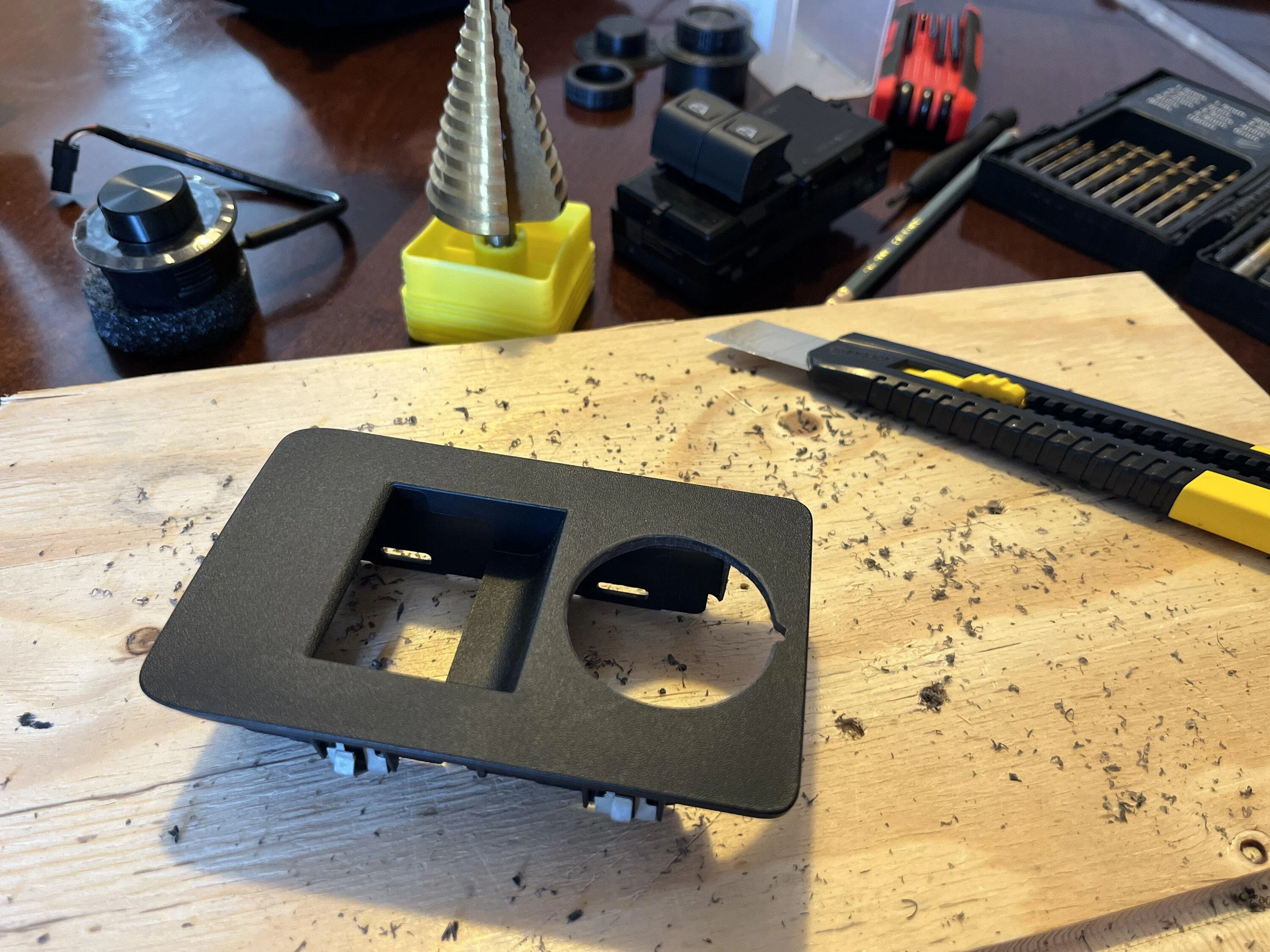

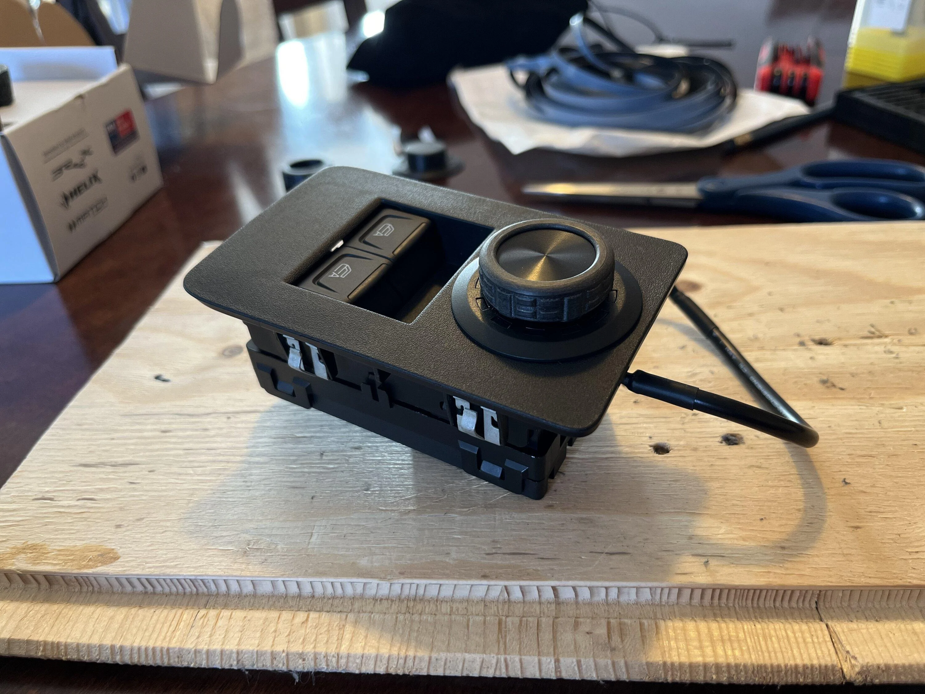

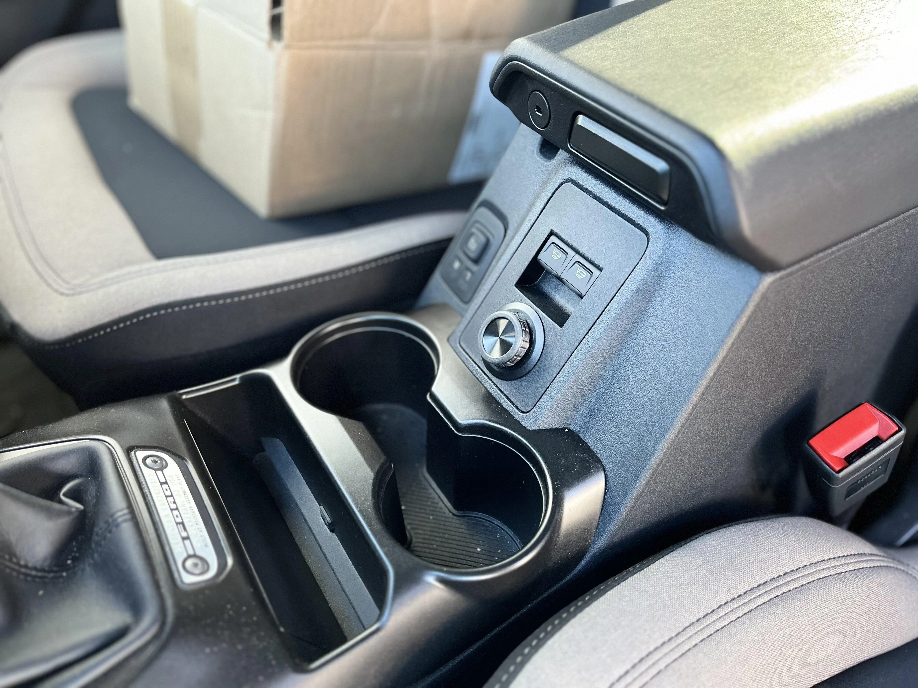

Also finally received my conductor and installed it in the window switch panel. BA 39mm step bit and a little tweaking and it fits like it belongs there…
