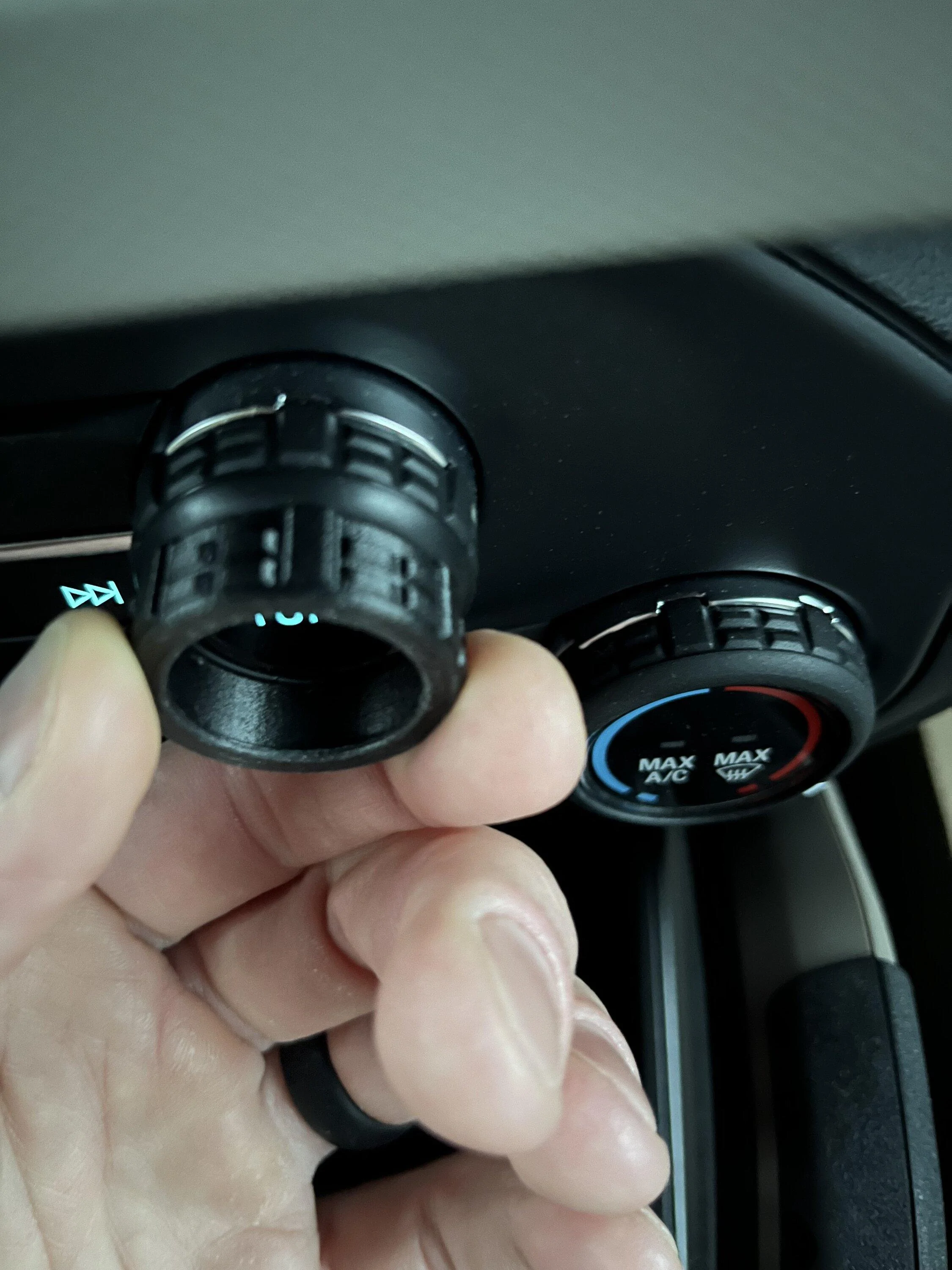

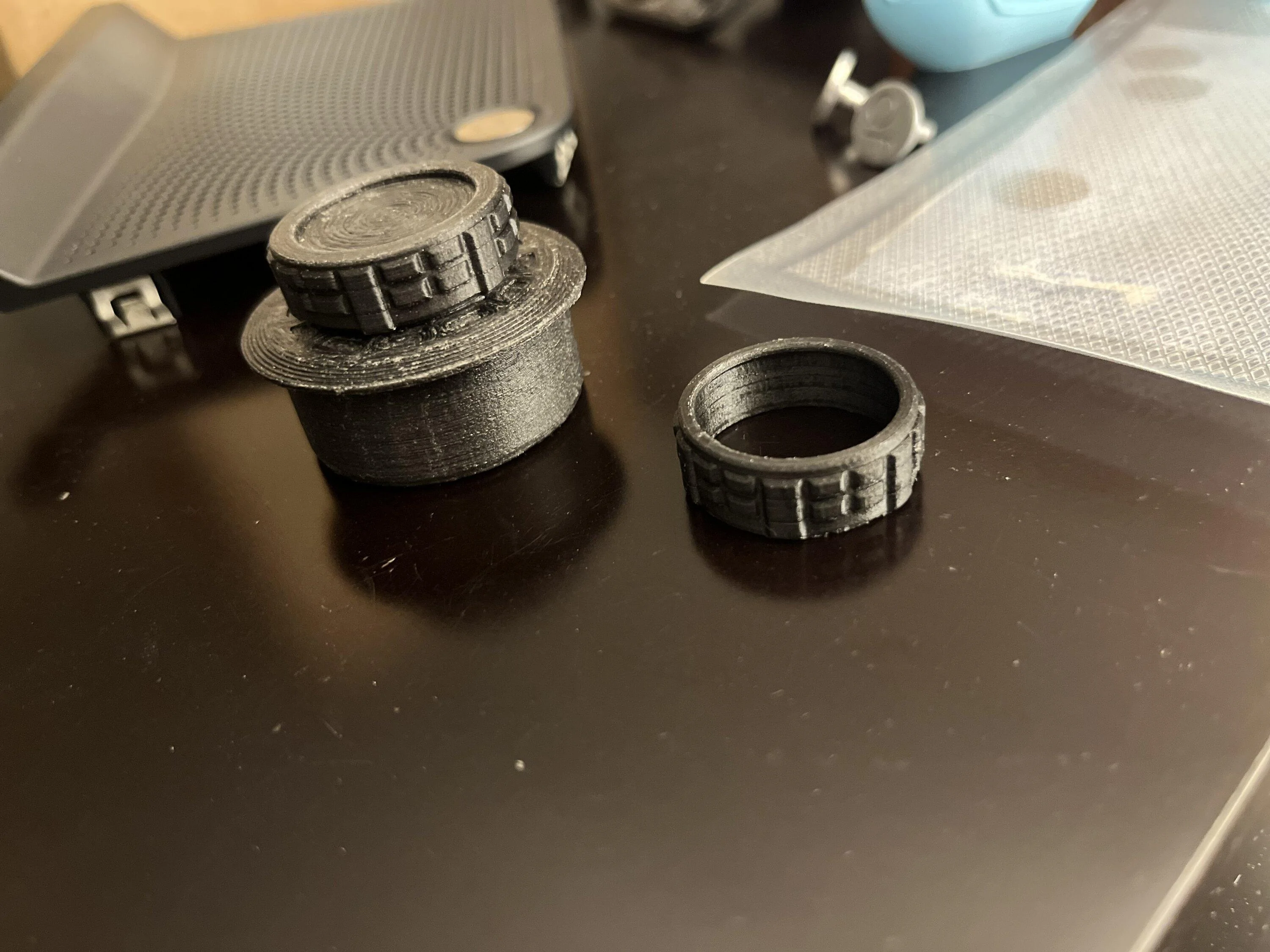

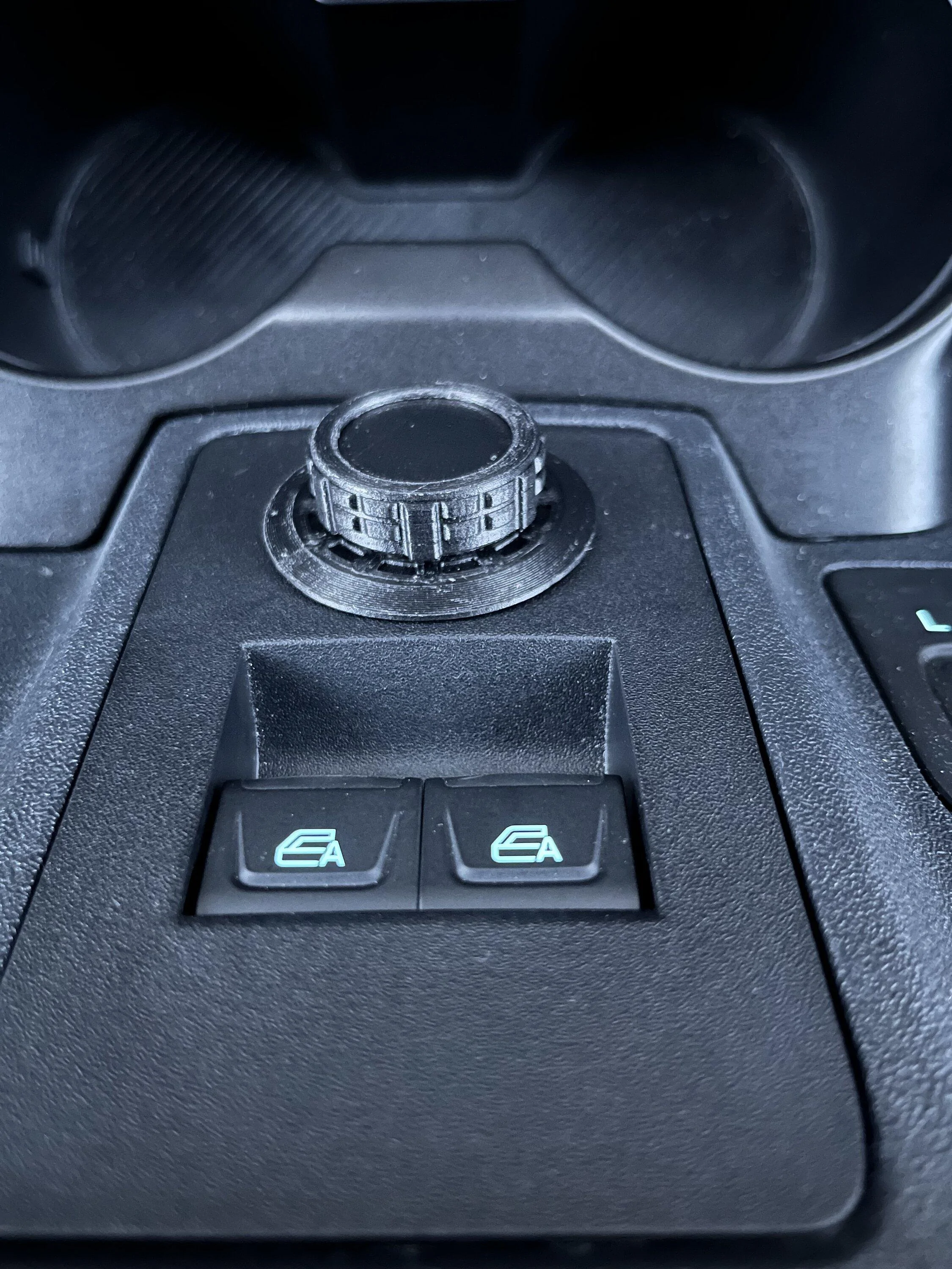

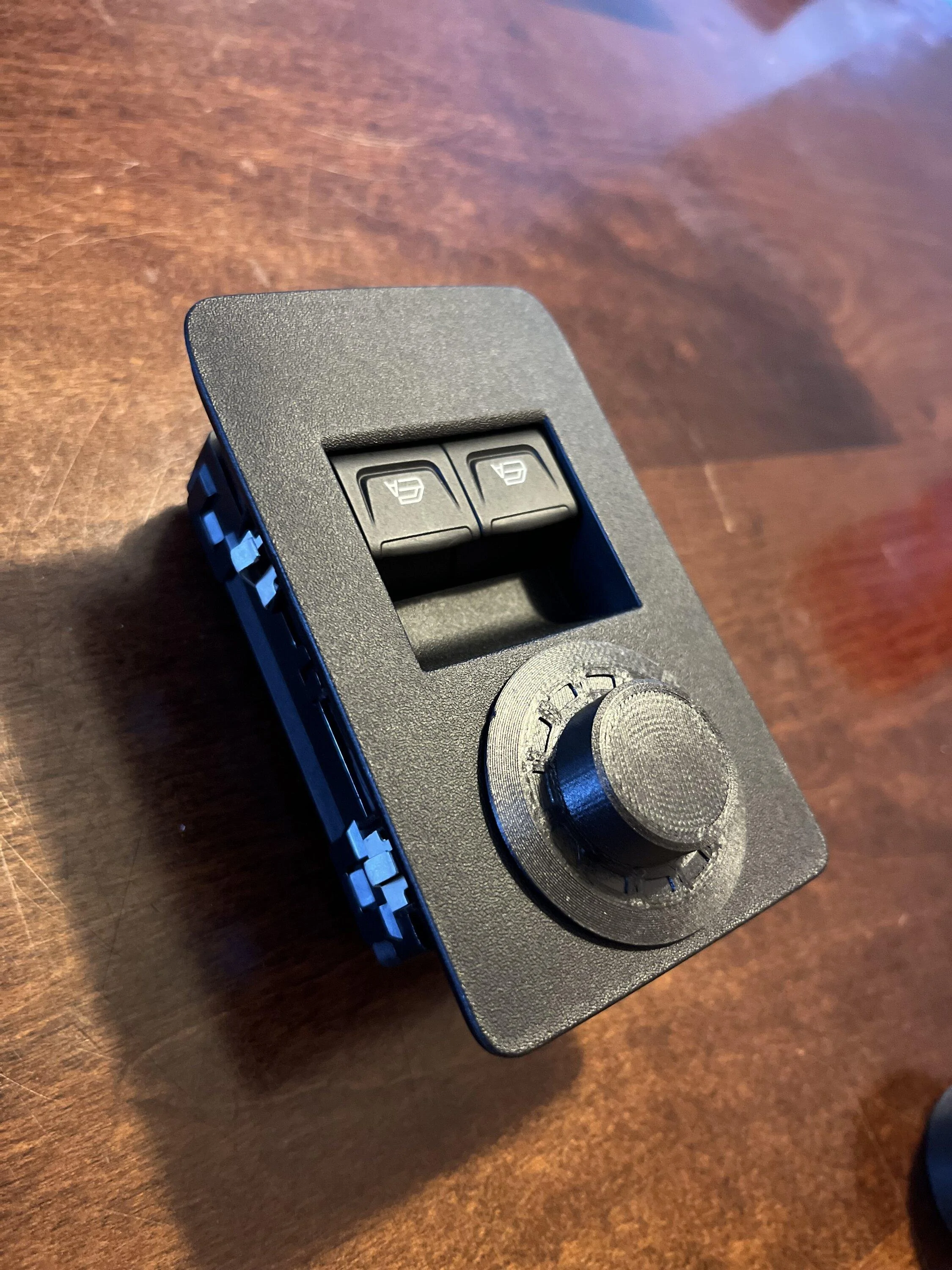

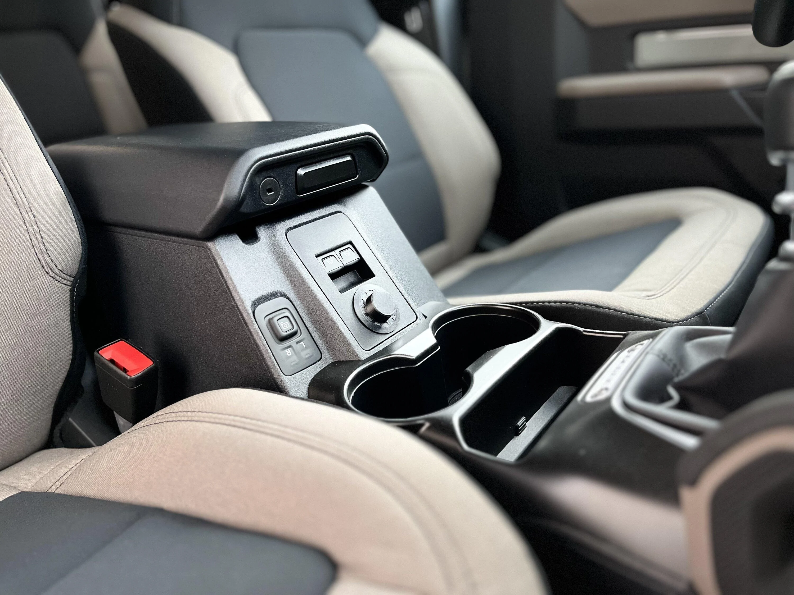

Working on integrating the Helix Conductor, which is an all-in-one LED-lit knob that will control master volume, bass level, rear fill level, Bluetooth functions, tune switching, etc.
I think I am mostly settled on putting it in the lower blank of my 2-door window switch, but not completely sold on poking a hole. I’m also working on a “sleeve” to better integrate with the factory switchgear design (still some CAD work left to get it just right). These are test pieces that I plan to ultimately 3D print out of TPU (flexible plastic).
It looks good, and placement seems very factory OEM 👍🏻

Your 3D printing is really cool! I dig the bass knob.
