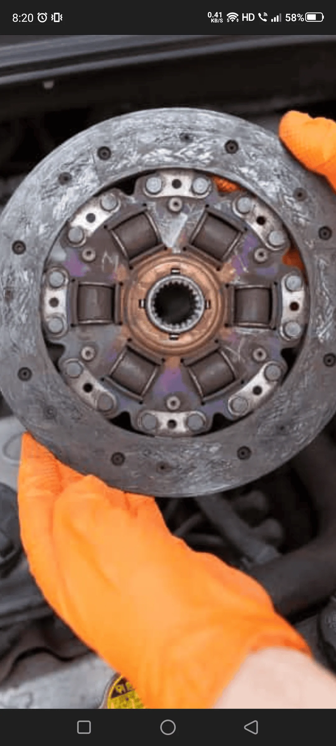

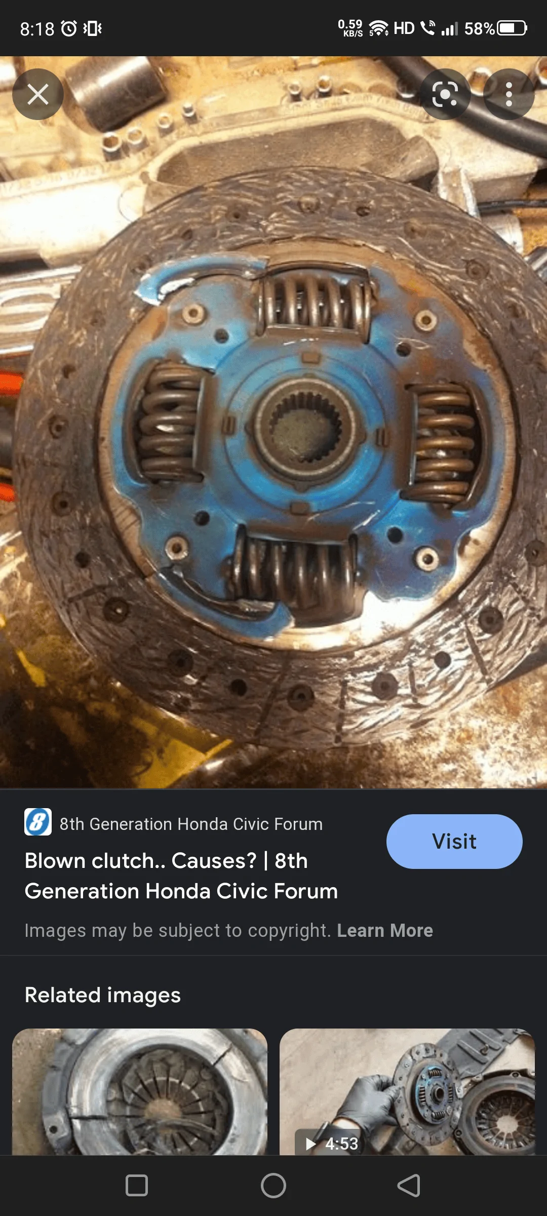

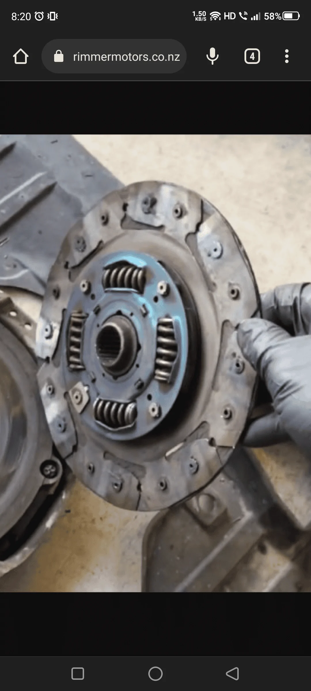

Actually, there's something that doesn't make sense, look at the center of the clutch plate, there is no evidence that it was overheated in a way that would damage the transmission.
Sure, there's evidence that the flywheel was overheated and that the clutch was falling apart, but it also looked like it wasn't getting proper clamping pressure from the pressure plate. This could be manufacturing defect, because it looks like only the edge of the disk was failing.
When the plate is truly overheated, you will see color change evidence in the center of the clutch plate.
look below for examples
