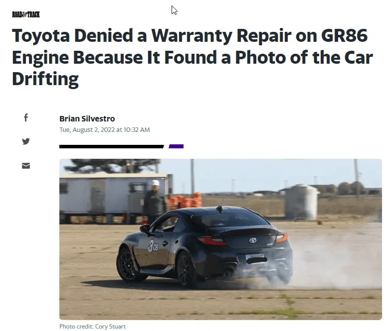

I just read this a few moments ago. Lots of variables involved in a warranty.
https://www.yahoo.com/autos/toyota-denied-warranty-repair-gr86-153200767.html

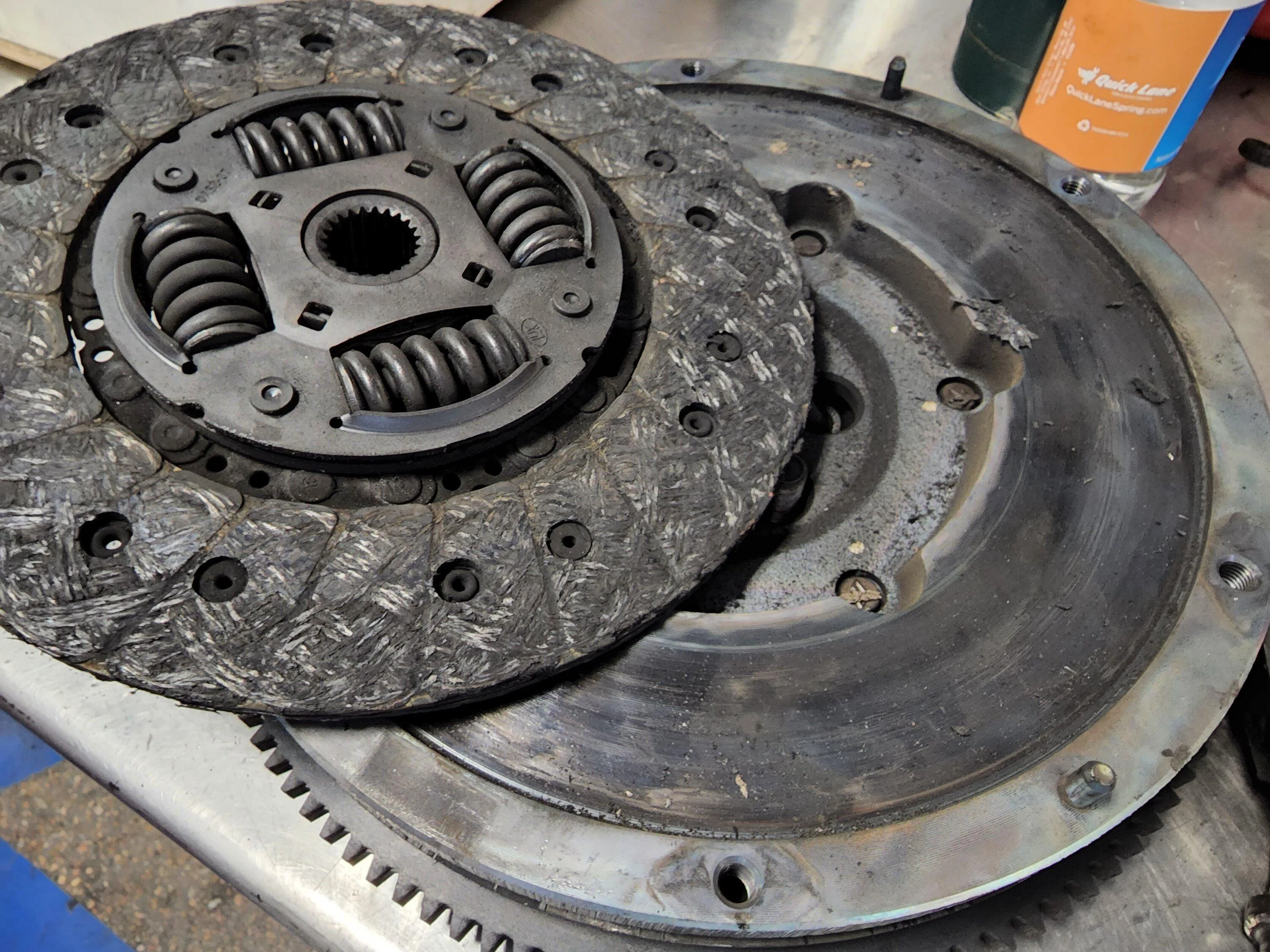

My take: kind of like @flip said, given the oil photo, now we don’t know which came first the leak or the burnt out clutch.

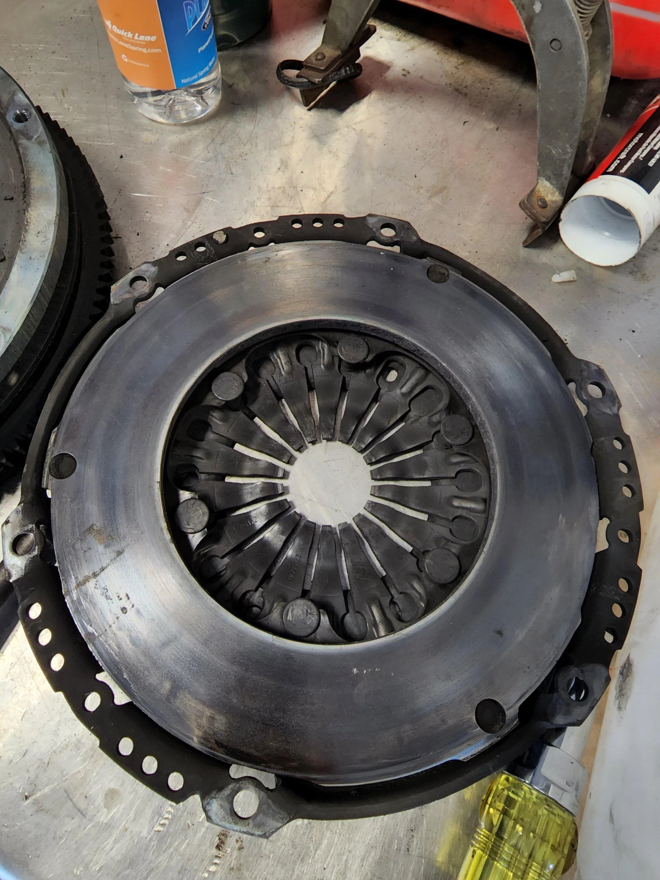

In the case of your clutch, your photos do not show 4500 miles of normal use. If the clutch or pressure plate had failed it would not be showing the signs of heat that yours is. To me it looks like it was heated to the point of failure. That is likely how Ford is seeing it. What I see is abuse. That clutch was being slipped hard.
If it were my rig I would thoroughly clean the transmission. Drain the fluid and check the fluid for and signs of excess heat and foreign material. If that checked out refill with with new fluid. I would then surface/replace the flywheel, replace the clutch, pressure plate, throw out bearing and pilot bearing.

That's sure a weird one. If it was slipping, you'd expect it to be glazed, not chunky like that. I've had a clutch where the friction material shattered and peeled off but it was not rough like that.

I had not chimed in here yet because it seems with each post the story gets more and more interesting. Let me start off by saying that I have drag raced stick shifted fox body Mustangs for years. I have burnt more than one clutch and have seen many others as well and most I have ever seen are usually some shade of grey/silver/blue/purple/yellow, in all different places. Kinda like a rainbow. Most times, as others have said, the discs were mostly glazed over, not frayed like the friction material had come apart, very odd to me. It is easy to smoke a clutch, sidestep the pedal at 5000 RPMs and have it in the wrong gear. ;) Try the heal/toe trick to try and do burnouts, too much gas and still resting your foot on the clutch pedal. Then stand on the gas hearing the motor bounce off the revlimiter thinking to yourself this is an awesome burnout, just to realize that you are seeing black smoke instead of white smoke. :oops:
Now all of that said, at first, I thought once the "friend used it at the beach" came into the explanation my first conclusion was as would be expected. Friend didn't know how to drive a stick in the sand. But then, low and behold, we have pics of leakage. Now you see why I don't chime in when the whole story is not explained at first. So now it becomes which came first. I believe that with all that has been revealed that it is very possible that the seal failed which in turn took out the disc but the conundrum is that it failed when "off-roading" which in turn means it could go either way. (warranty wise)
