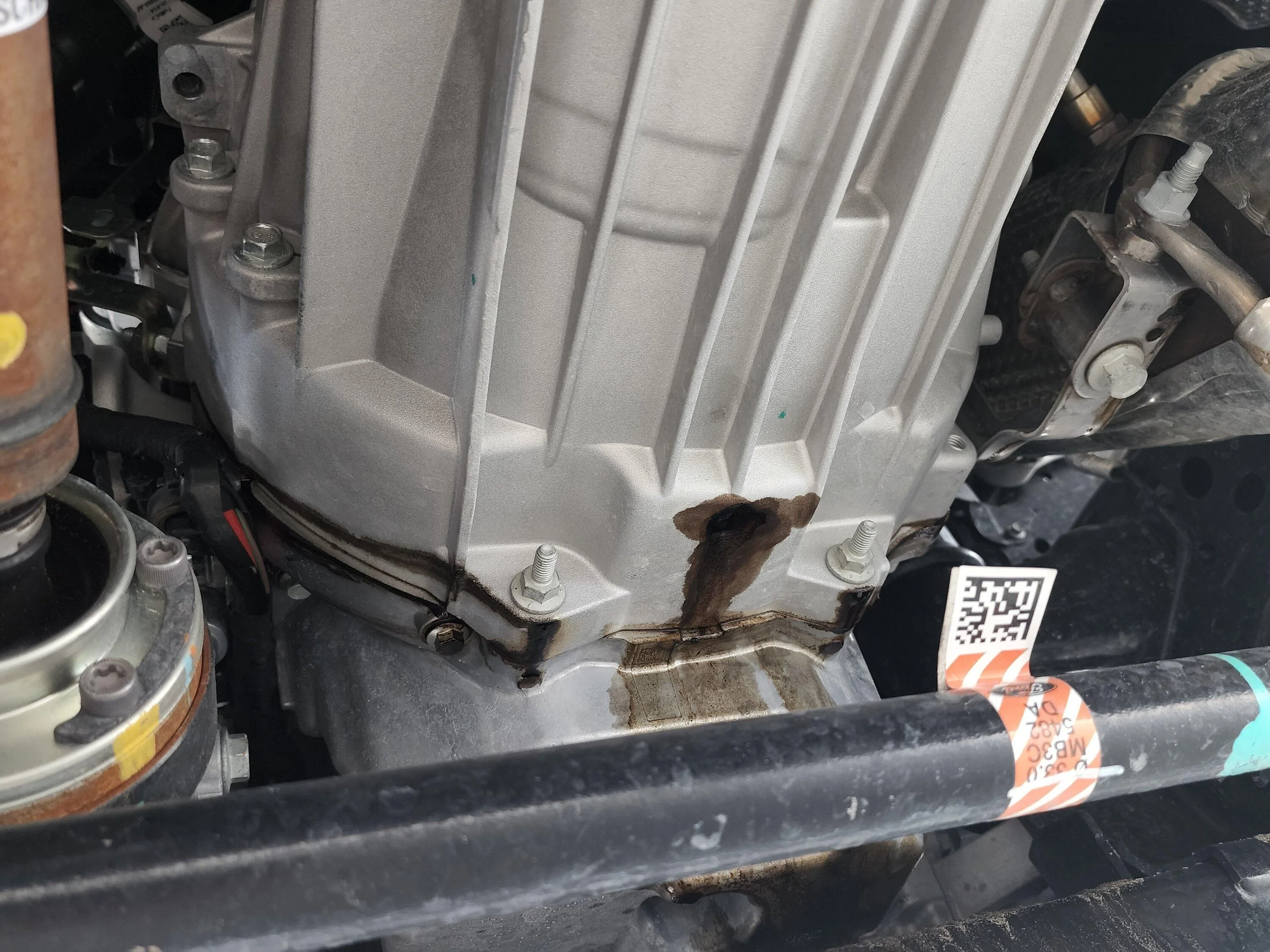

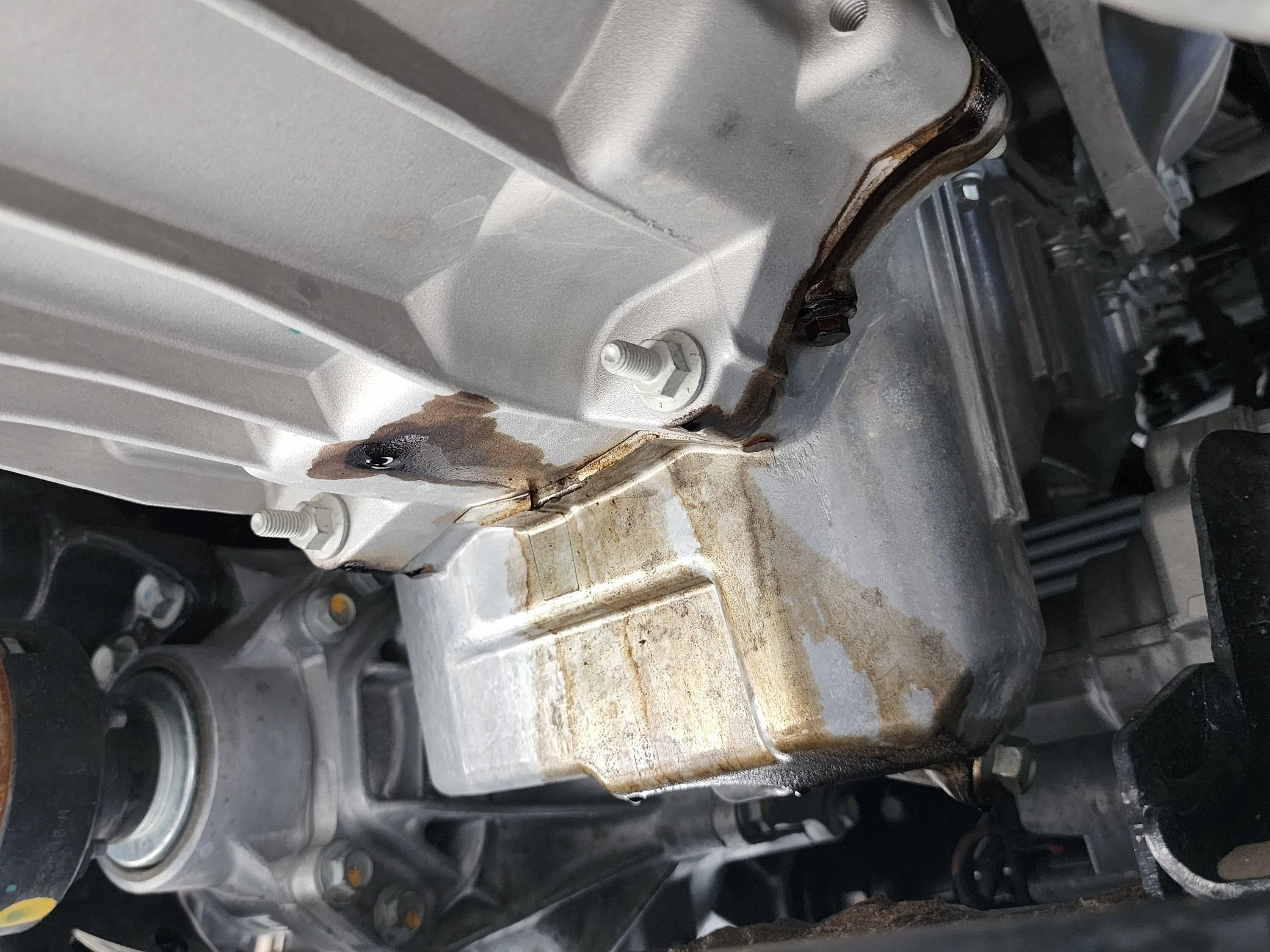

thank you. see these pics. that's before it was pulled apart. is this what you would expect to see when a clutch burns up?
I am still thinking that is liquefied grease from the throw-out bearing. I would expect to see a lot more fluid if the seals were melted.

I remembered I took photos of the transmission casing before they pulled it apart. see the pics. you can see fluid leaking.
OK so this is interesting and could make the argument that the input shaft seal failed, got oil on the clutch causing the failure. Ford Focus/Fiesta DPS6 had this problem early causing failures so it's not impossible or improbable. The question is what happened first?
If this were in our shop and weren't able to 100% able to say the leak didn't happen first causing the clutch to fail, I'd probably cover it sans any other convincing evidence. My gut says the dude driving when it failed likely caused it but Ford tells us to give the customer the benefit of the doubt when there's a lack of proof to decline coverage. Ultimately, we're supposed to use our experience, document the findings and repair process so we get paid by Ford.
Bad deal but I think there is/was some evidence that could be used to support the leak first theory to cover the repair. If it was written up, documented correctly, the repair would probably go through without issue but there's a small possibility Ford could call the part and charge the repair back but that would be rare if the writeup was solid.

kodiakisland
Jul 10, 2020
6,175
17,799
Arkansas
The clutch is definitely toast, but I see no signs of excessive heat from what I can see in the pictures. If the seal failed first, then the clutch would burn itself out from being covered in oil and continually slipping. I think you have a real complaint against Ford if the seal failing first would be covered under the warranty. I'd push that as the most likely explanation for what happened, as long as you know for sure no one was doing burnouts in it.
