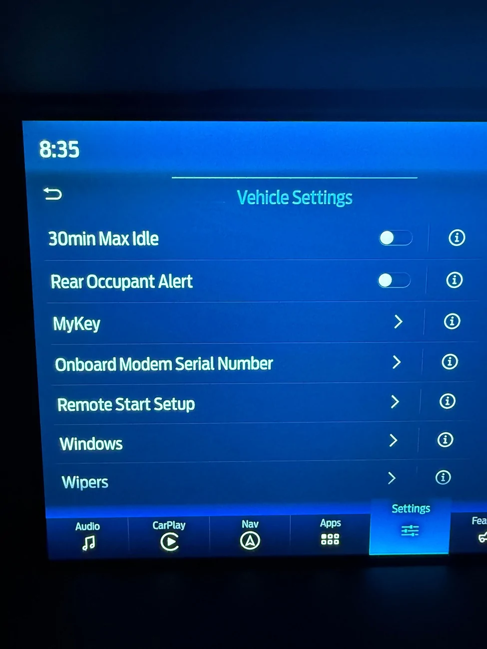

I need to permanently disable the engine stop at idle after 30 minutes
Hey soooooooooooo….this happened
The option to turn it on is gone. Just like the pickup. I have yet to test it.
@David Lott I just set a timer for 33 minutes and let it idle. It works and no longer shuts off. Thanks @GooseTuned!
(He did warn that excessive idling is bad for your turbos, but I’m okay with that. I’d prefer the dogs to not be uncomfortable if I have to step out and the thing I’m stepping out for takes more than 30 minutes)
