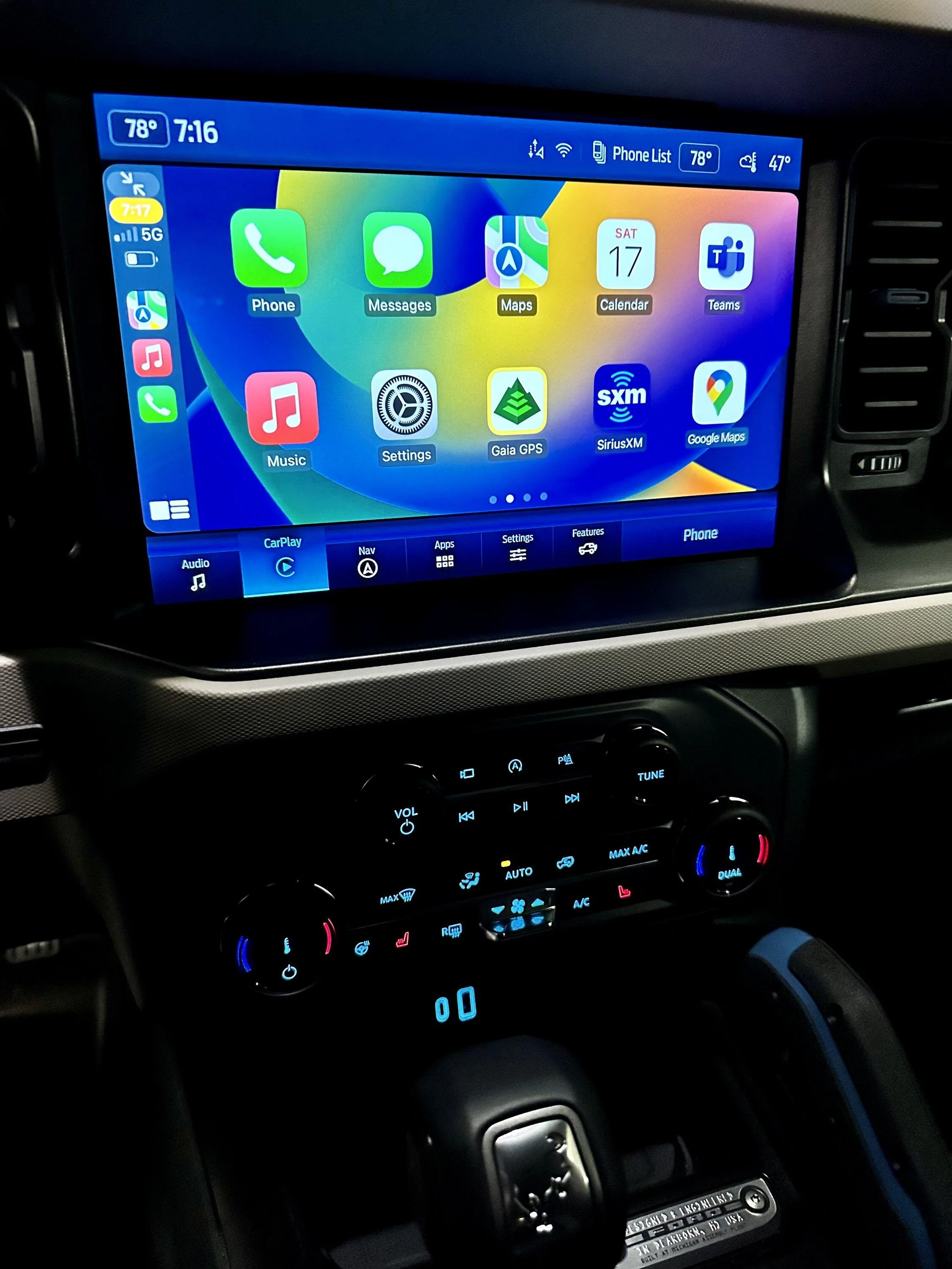

Love the Unreal theme
Looks awesome with full screen CarPlay!
