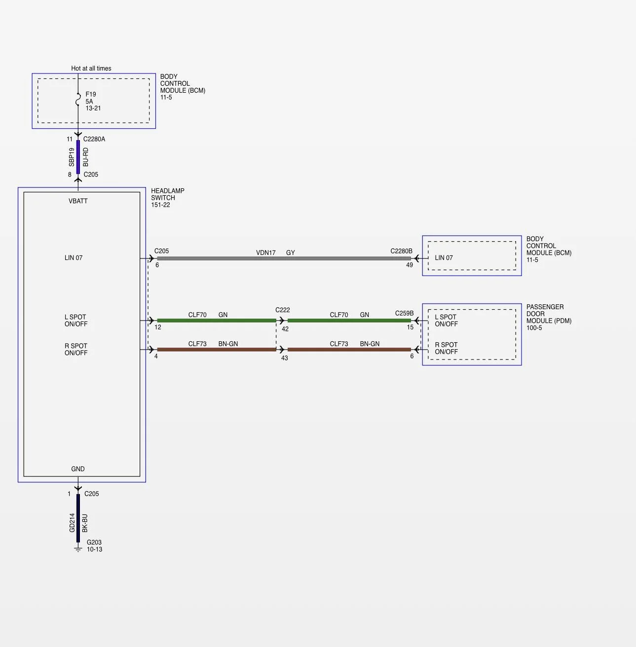

Yeah I just want the side mirror lights to work, I already have plenty of light front and rear through the upfitter switches. Was thinking that if I wired those switches direct and bypassed the APIM wiring, they'd work when I pushed the buttons. Though, I don't know if the switches are powered by the APIM and then go to the lights, or if the switches just complete a logic circuit and aren't even connected to the lights. In the first case, all I'd have to do is run a hot wire to the switch and they'd hopefully operate normally. In the second, well, I know enough to know that I don't know what to do LOL

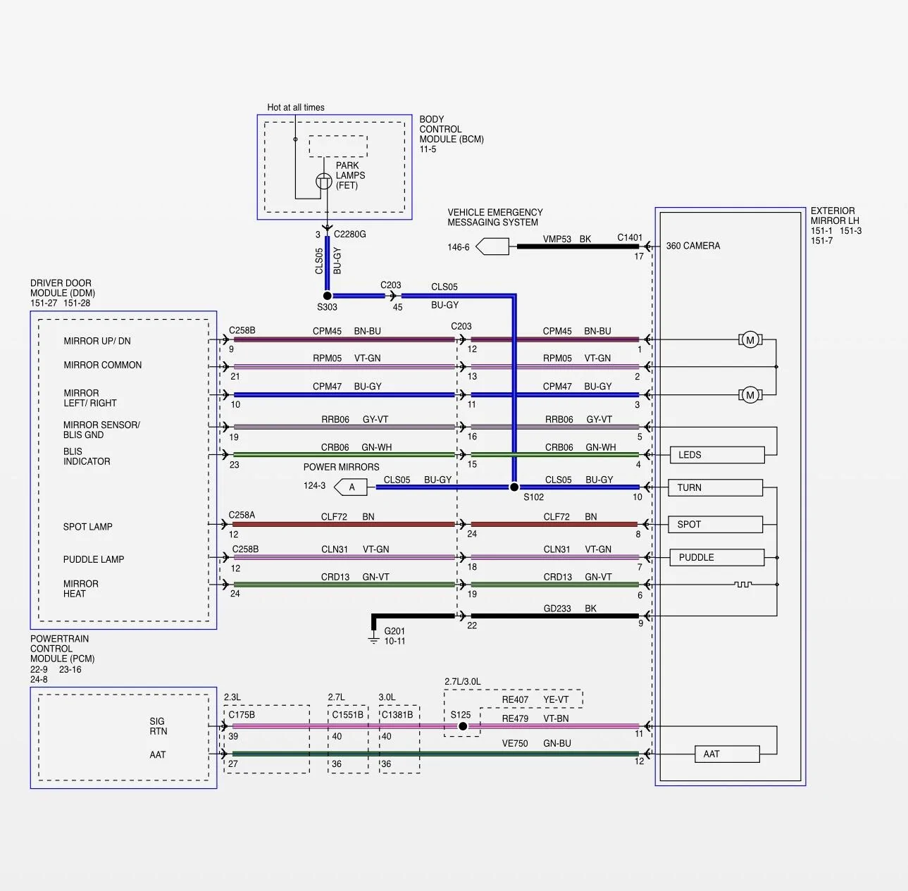

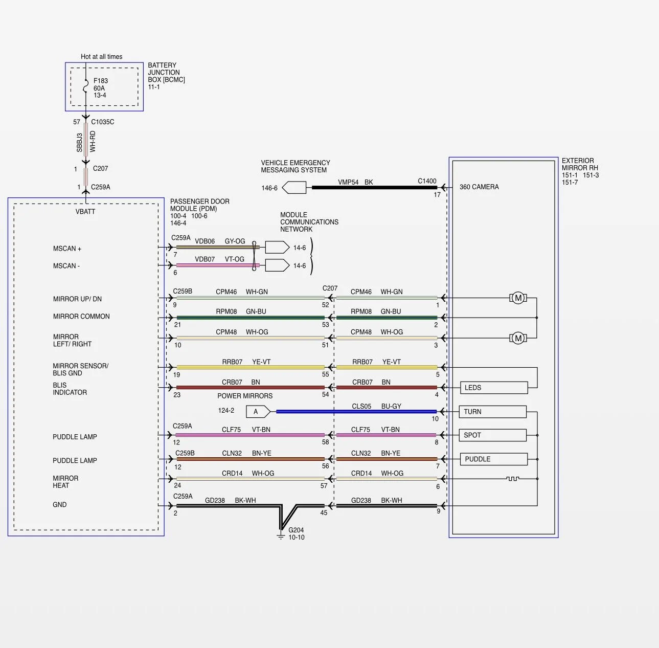

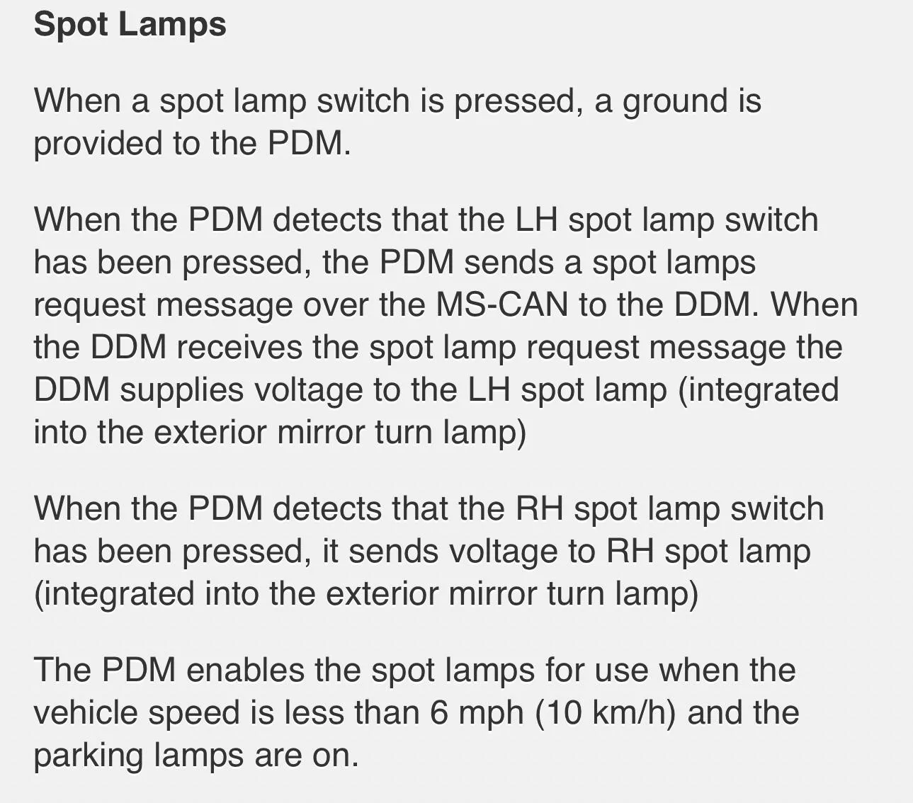

Yeah it should be easy to do if you only want the mirror lights, because then you don’t need to worry about the APIM or the rest of the zone lights. Here is an explanation of how the circuit works and the wiring diagrams you’ll need. It won’t be quite as easy, because the lights are module controlled, not wired directly to the switch.

Hmm...okay, so it appears that the switches just provide a ground signal to the PDM where all the magic happens, at which point it either directly controls the passenger light or sends the command to the DDM so it can turn the driver light on. Seems like I might not be able to use those switches to directly control the lights without using a couple relays, as I doubt they're big enough to handle the added amperage of independently running those lights. It's that or figure out how to trick the PDM/DDM to see a false speed indication so I can use that instead, and I don't think I'm quite up to that task.
