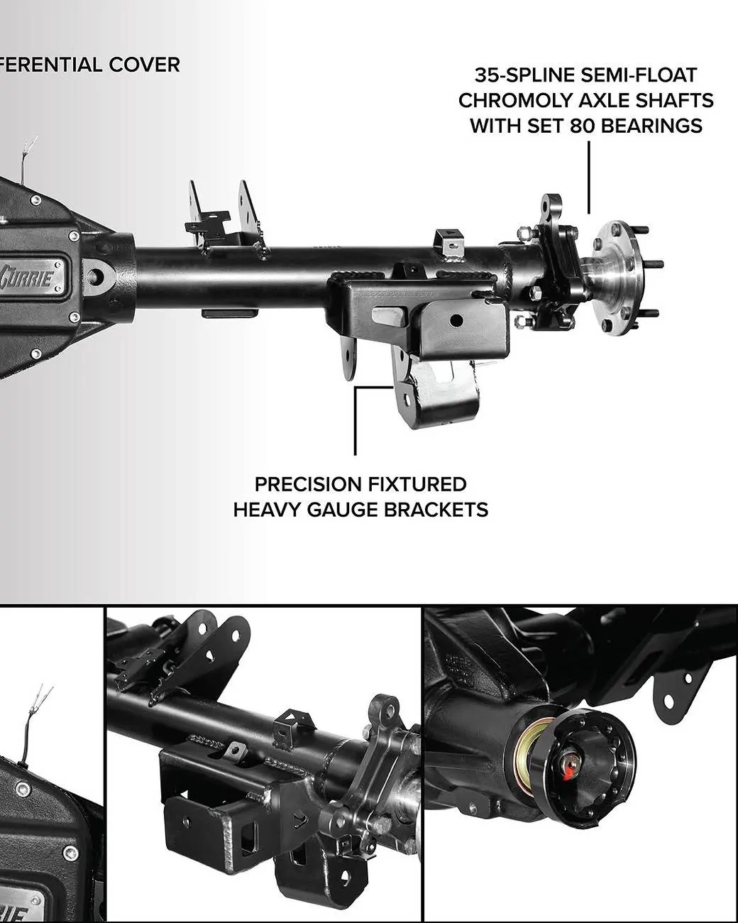

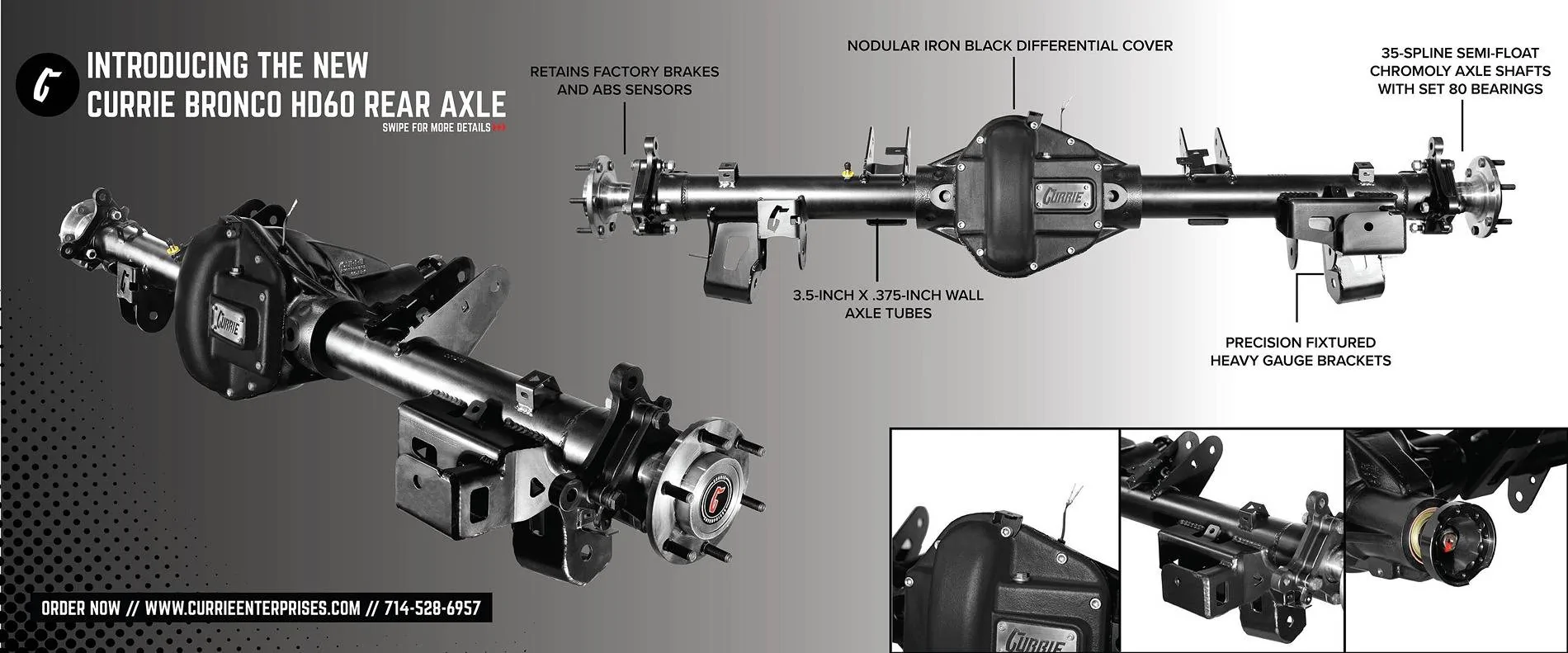

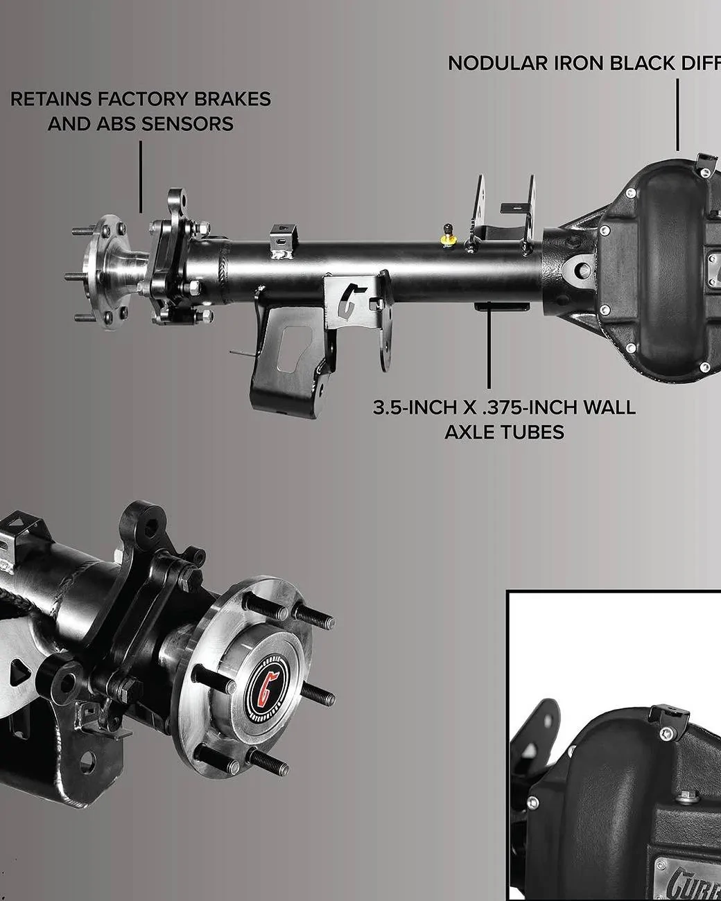

So this is bolt-on, but the drive shaft also needs replaced. I am guessing as the UD60 bolt-on also needs a drive shaft.

According to Currie's website, they show:
Driveshaft: The vehicle's factory driveshaft will be retained and reused with this Currie axle

What’s different about this and the one on Danas website already for sale?

Yeah I’m not sure what they were thinking on the gear choices they are offering….i think 4.70,5.13 and 5.38 would be the best options unless someone was going with portals….also why keep the crappy factory driveshaft.

I'd like to see options for different track bar mounting locations, since I doubt anyone running this axle is running stock height. Then again, maybe they already baked in the geometry change assuming a 2-3" lift?
