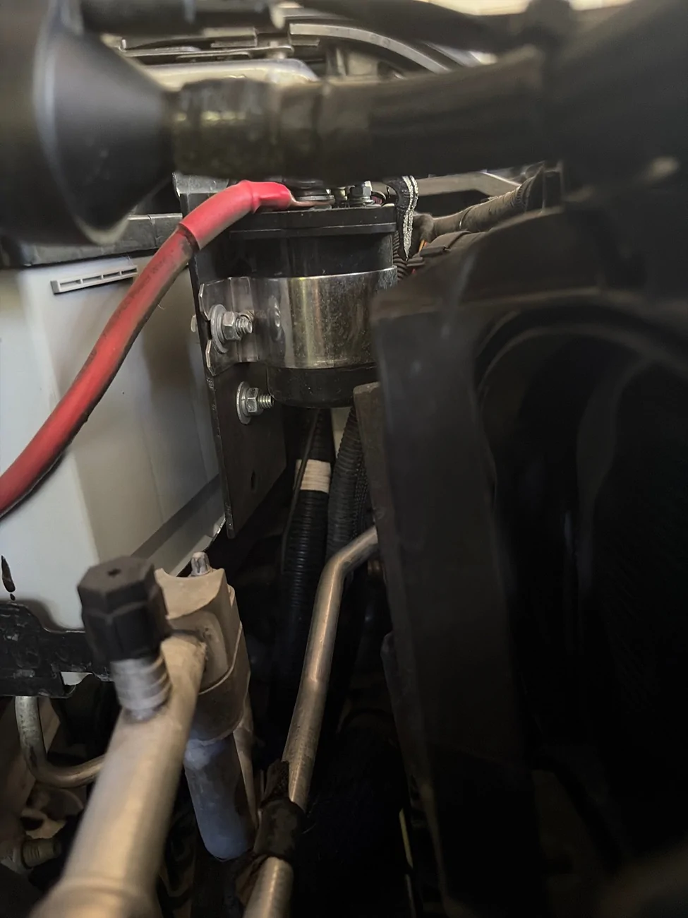

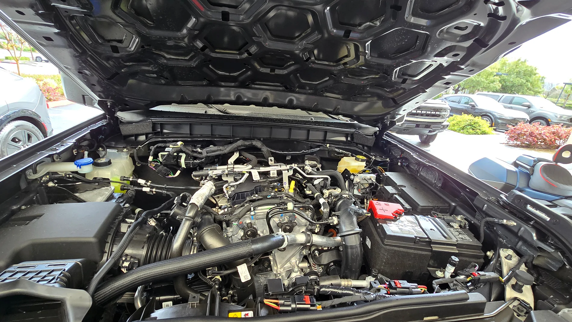

I am in the process of installing a Warn Zeon Platinum winch using a Lobo Hidden Winch skid plate. Because this winch is controlled by a remote control, I thought it would be a good idea to install a cut-off switch in the engine bay to stop battery drain that might occur due to the winch looking for the remote. Anyway, I bought a 500A manual switch from Amazon (see pic below). My problem is where and how to mount it. I have the 2.3L new (2025/2026) engine so my engine compartment might be different than earlier models. I thought about mounting it where the current battery chassis ground stud is, using M6 rivnuts, and moving the ground connection elsewhere or if I had an aftermarket braket that would allow installation on the side of the battery or ... So, I decided to ask the forum for advice/suggestions. Here are some pics:

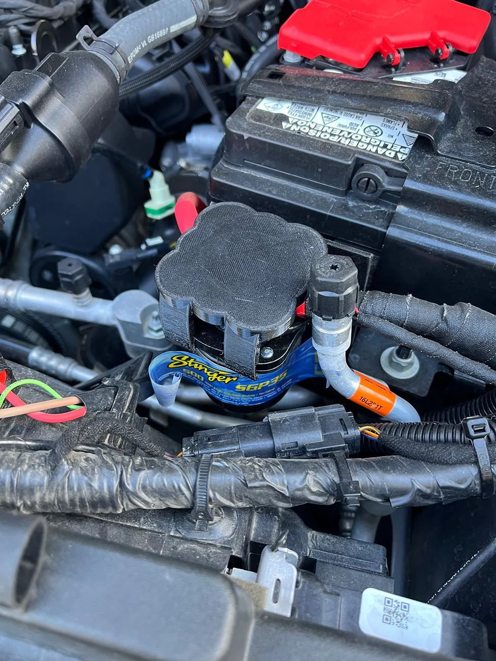

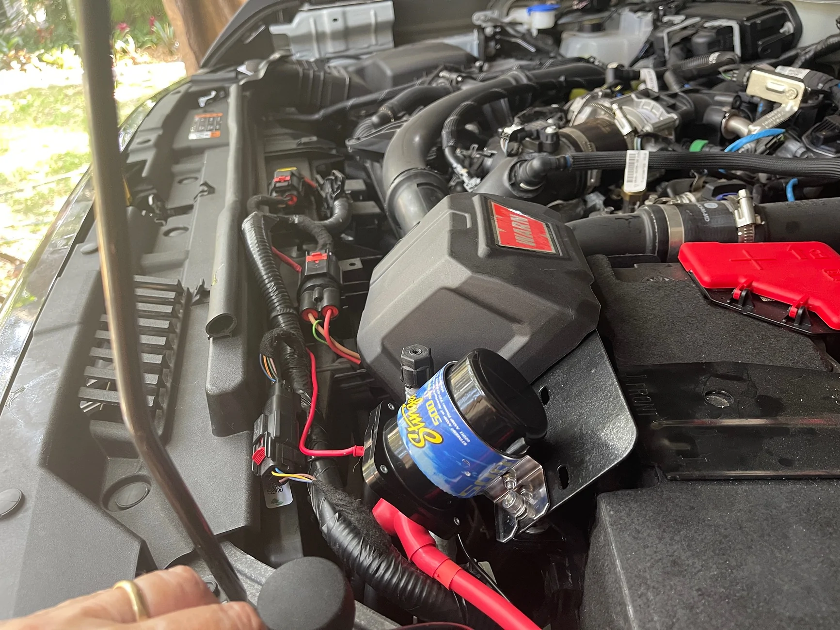

I installed a bracket for my winch control box and the solenoid in front of battery. My solenoid is connected to Aux switch 3 since the aux wire comes out right there.

Is your bracket 3D printed and stuck onto the battery? What kinda tape/glue did you use?
Bracket is a 90’ bent sheet metal bolted to the battery plate, not the battery itself. This one came with the Stinger solenoid but it isn’t anything fancy.

Curious what the 3D printed cover thing is on top?
