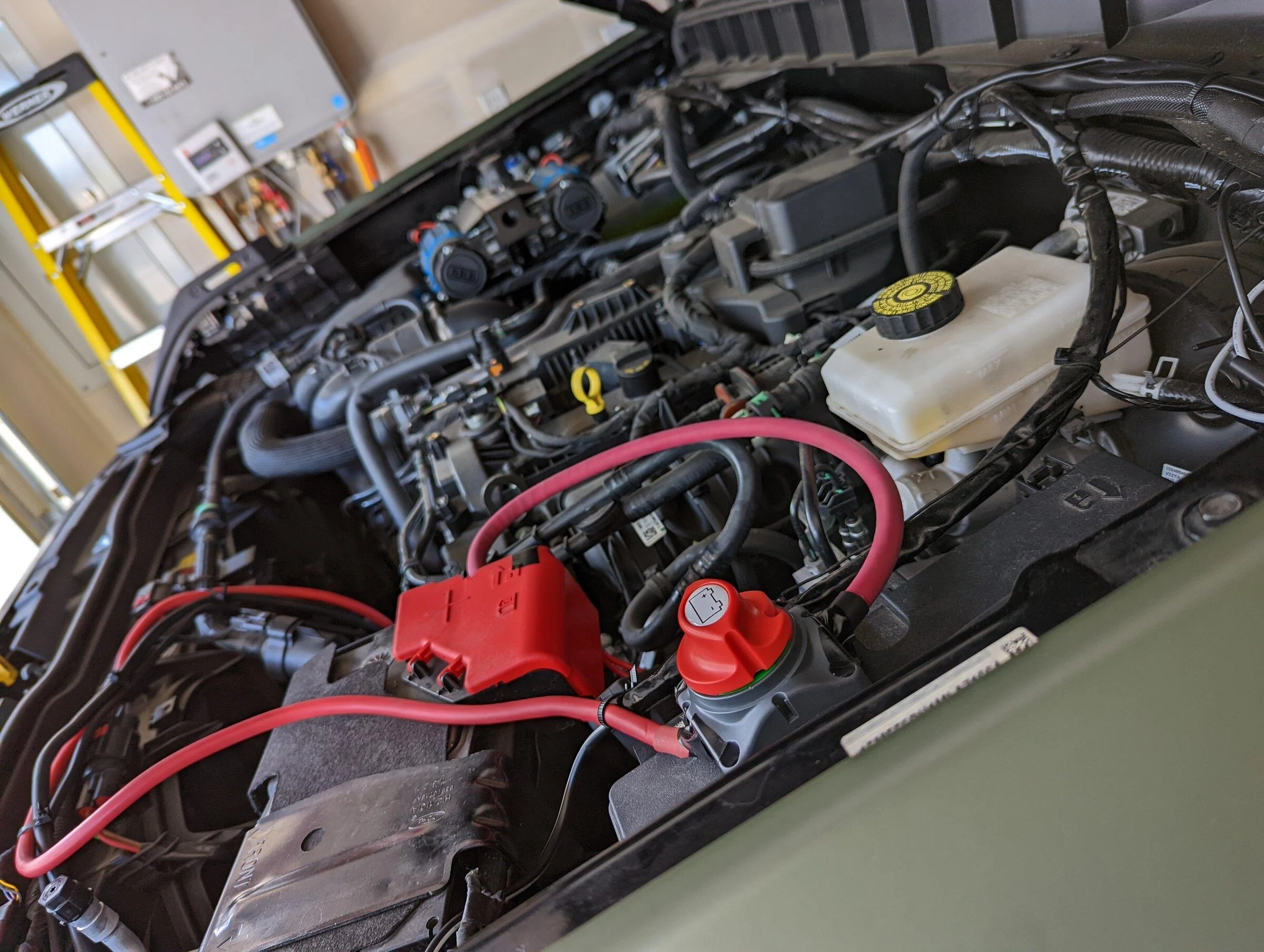

Thanks for the info @mds5917. I will be looking to do something similar soon.
Probably overkill but I added a battery disconnect yesterday so that I don't have power running to the winch when it's not being used.
Ford Bronco Warn Hidden Winch - Rough Country Mount PXL_20220428_151939468
You are quite welcome on the info - my pleasure. I like your kill switch. I talked to Warn about this and they were adamant about not using it, which I thought was odd.
What gauge wire are you using for the battery disconnect?
