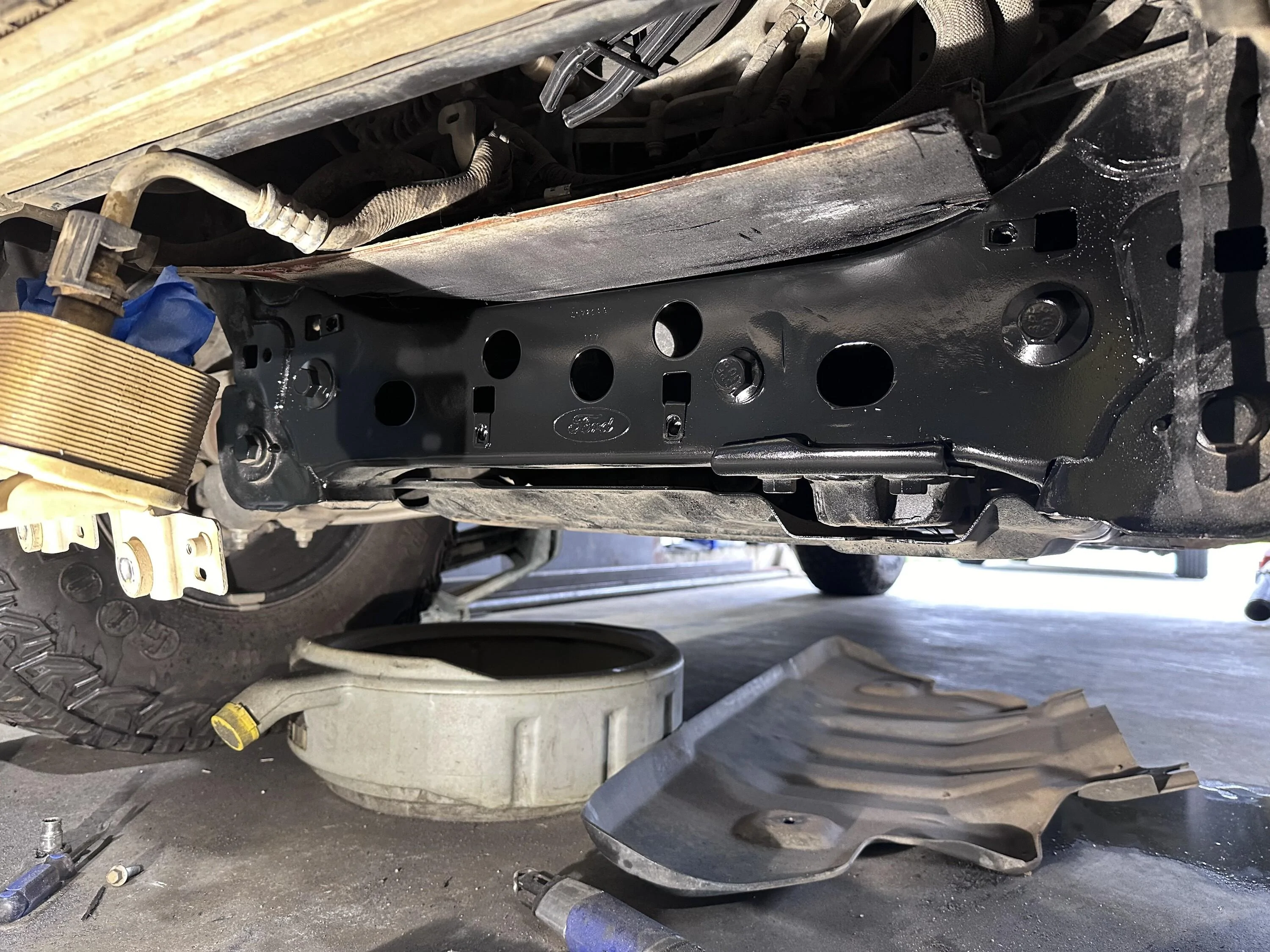

I'll answer my own question and used this thread as a guide to do the same as he did in case another 2.7 person wants to take this project on:
https://www.bronco6g.com/forum/thre...stall-2-7-w-capable-bumper-warn-vr-evo.89271/

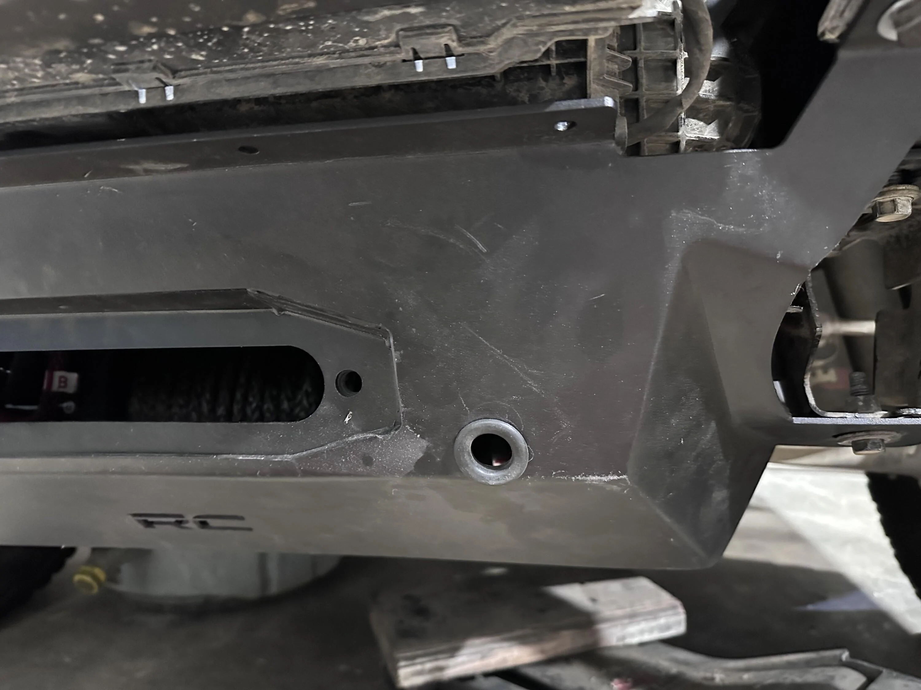

I did the same and shorted the RC bracket, and cut/redrilled the oil cooler bracket to clear the shutters vs removing them.

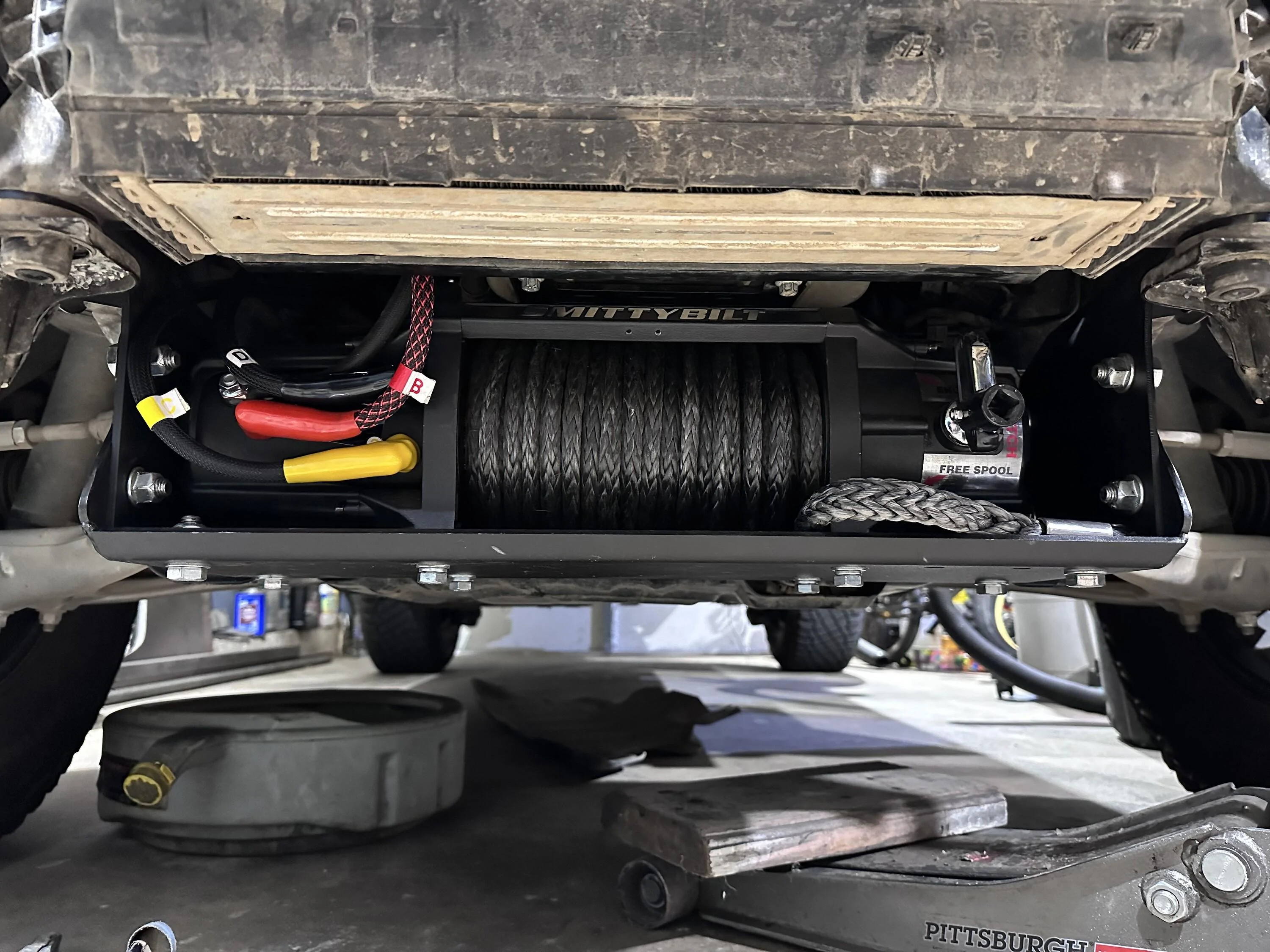

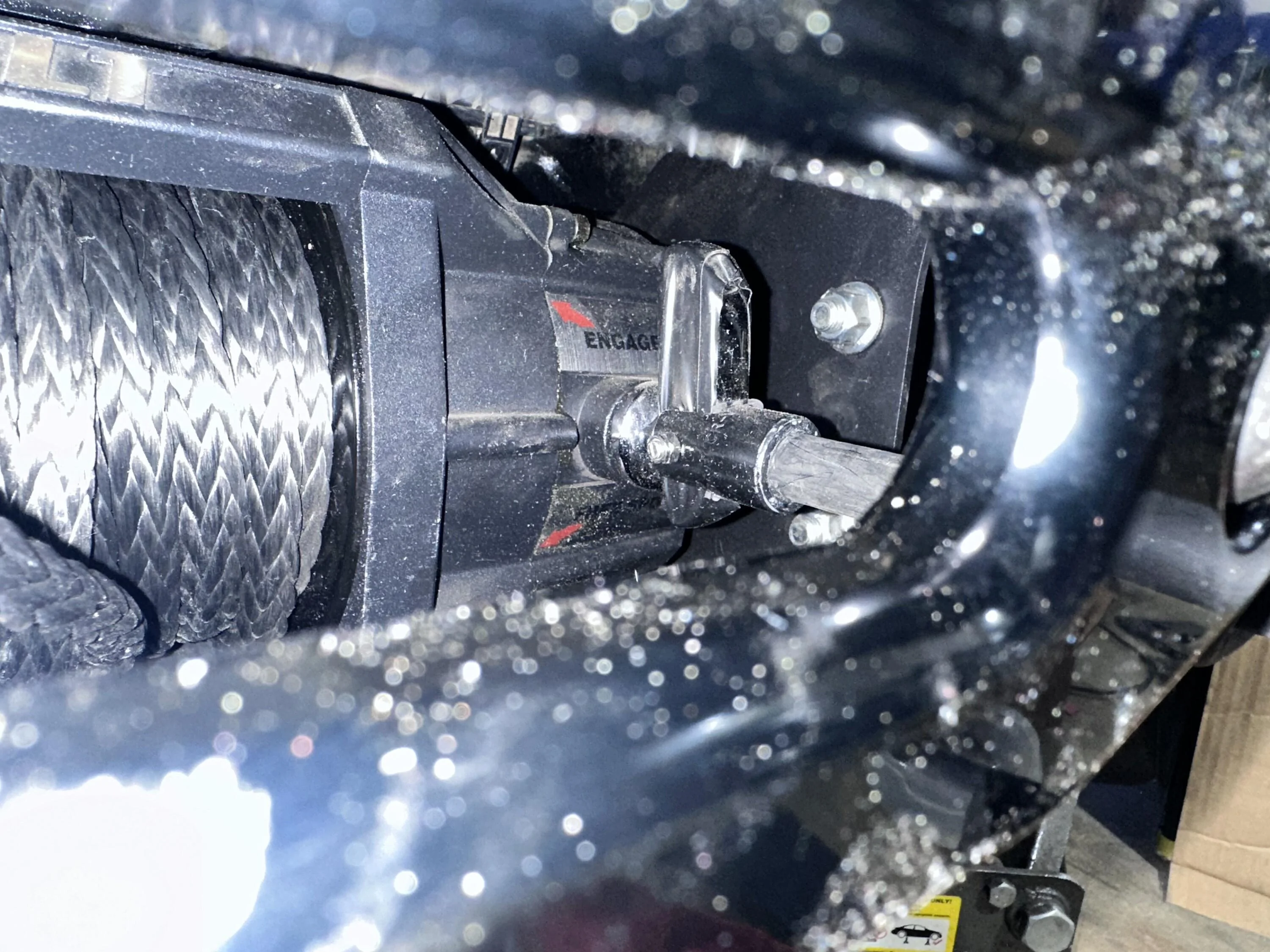

This is finally almost done (I work slowly 😅 ) but I have everything tested and functioning the way I had hoped. I am using a Smittybilt x2o 10k synthetic winch with wireless capabilitys. I clocked both the motor and the clutch to face forward. This helped me be able to make all the new wires for the winch solenoid and I can easily access them by only removing the skid.
Ford Bronco Warn Hidden Winch - Rough Country Mount 53735867257_084546cc26_4k
Untitled by MJH Creations, on Flickr

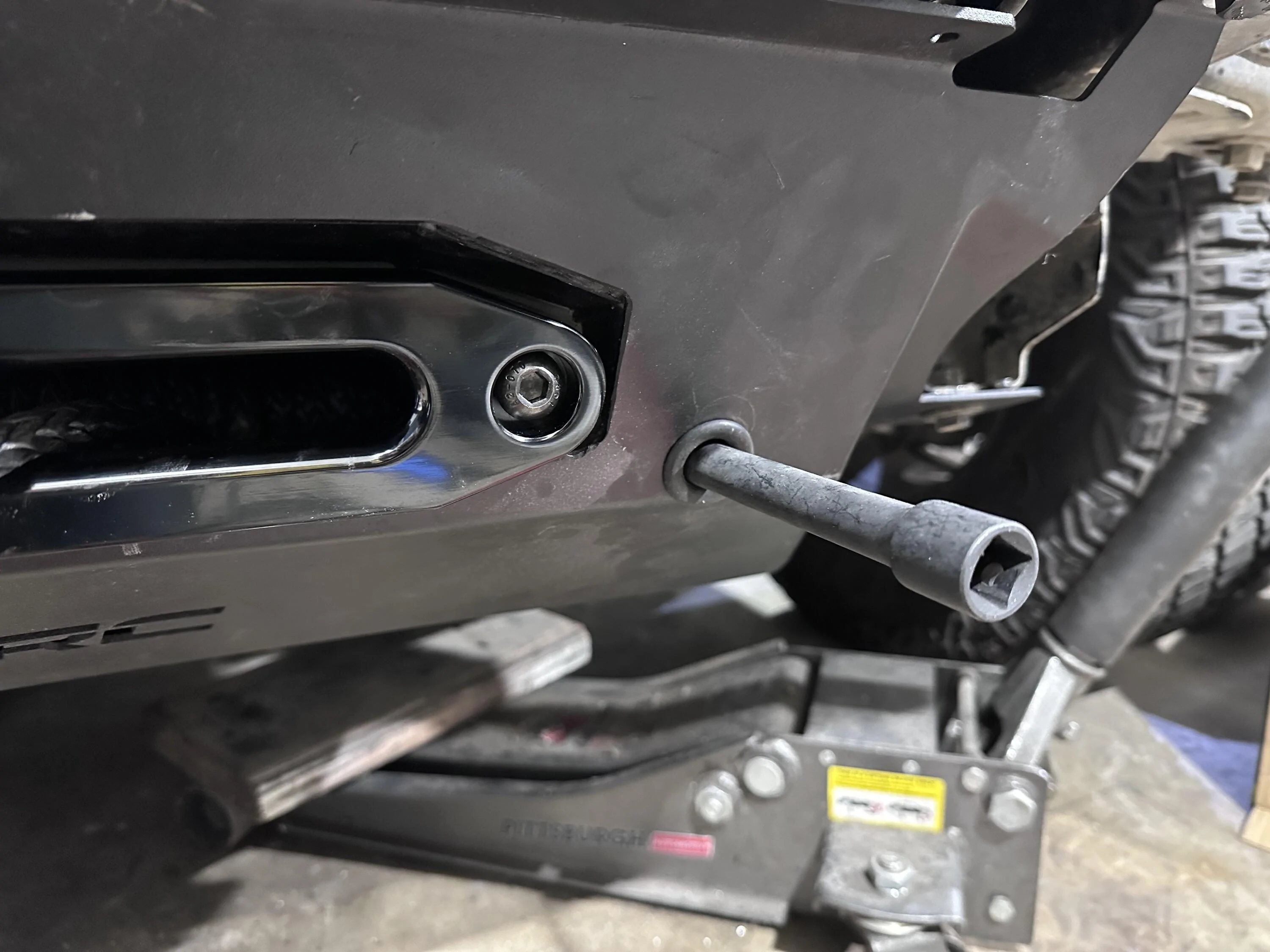

Winch free spool is activated using a long 1/2" extension. Only time it will be an issue is if I am buried maybe, but at that point I don't think waiting for the line to spool out electronically is going to be an issue.

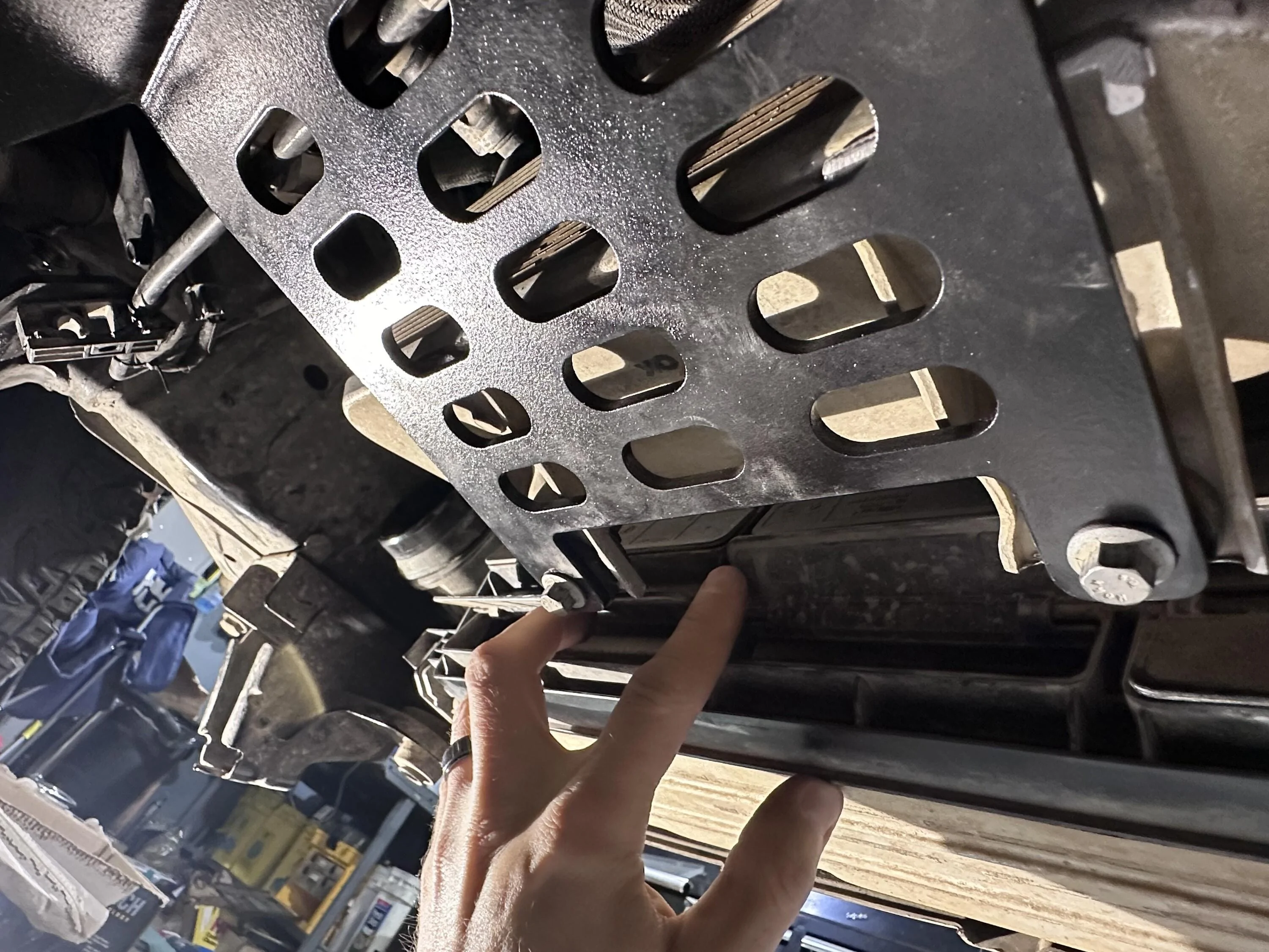

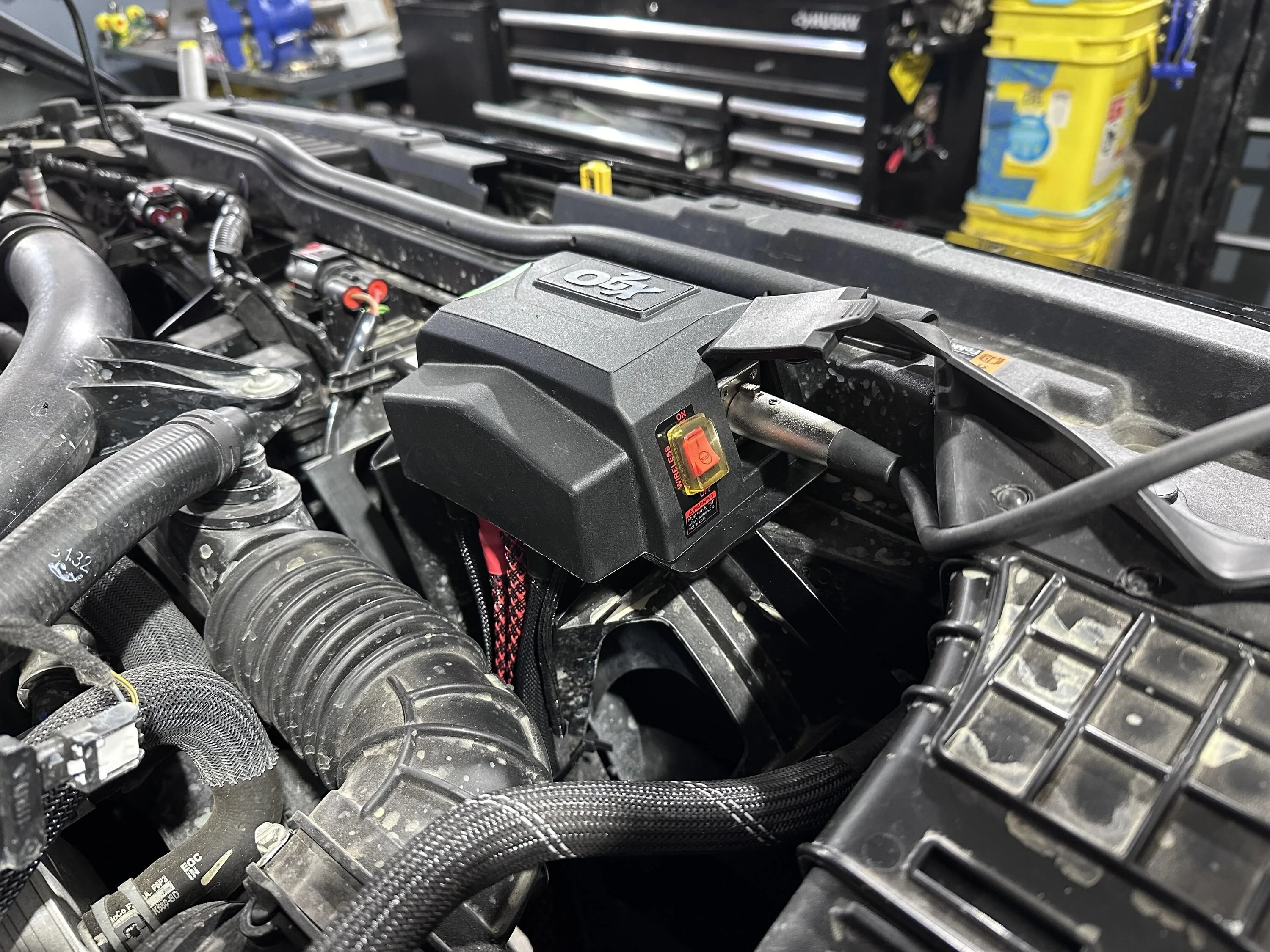

Lastly is solenoid is located via a bracket here:
Ford Bronco Warn Hidden Winch - Rough Country Mount 53736813816_ad881f0701_4k

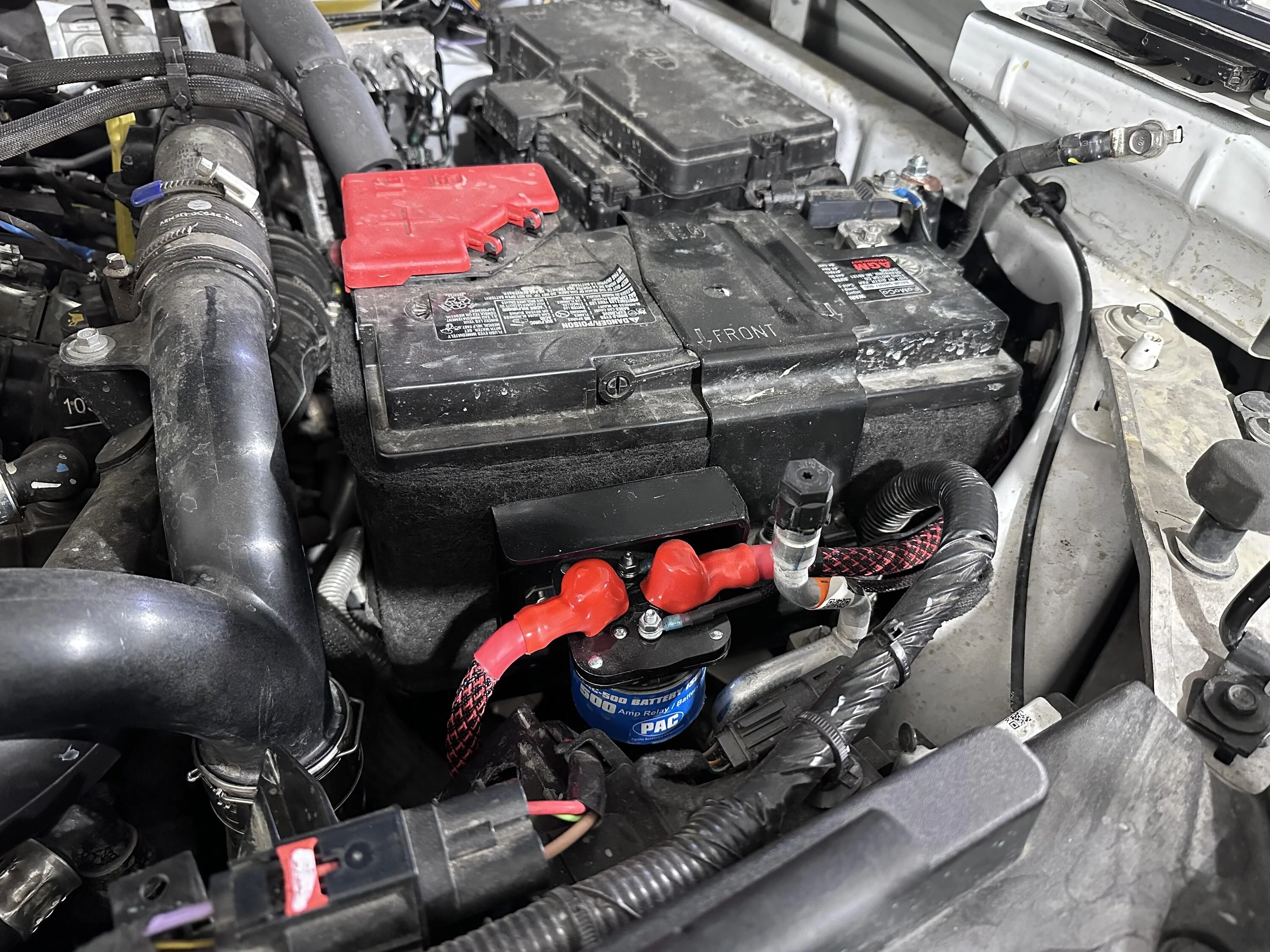

And isolator mounted here:
Ford Bronco Warn Hidden Winch - Rough Country Mount 53736813751_d01f21fd3b_4k
The main goals were to not need to open the hood for normal winch operation. Will only need to if the remote in the battery dies and it can't operate wirelessly anymore.
