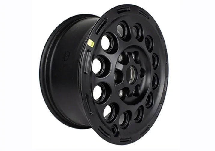

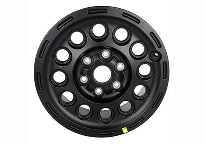

I currently have the stock SAS wheels with the Goodyear territory’s. I’m switching to Toyo Open Country RT Pro’s 35x12.5r17. I’m also switching to wheels that are 17x8 with a +55 offset. So compared to the SAS wheels which are 17x8.5 with a +30 offset I figured I’d need 1” spacers…but now I’m wondering with the new wheel also being .5” narrower will I need a 1.5” spacer? Thoughts? Thanks

I really like these in the pictures and video, they have an old school look but are still ford parts…im not huge on aftermarket stuff. I like the 2nd ones in the video below as well which are SAS wheel specs but they are going to be everywhere in a few months as they’re an option on the 2026’s…the 12 hole ones I’ve never really seen.

Because I like those wheels and they don’t come in a +30 but I can buy high quality 1” spacers that will make them essentially +30.

At +55 you're going to be extremely close to rubbing the UCAs running a 12.5" wide tire no matter the width of the wheel. A 1" spacer will get you close to the SAS OEM wheels (+30)...no need to go 1.5" unless you want a bit more poke.

Just had the Bronze version installed on my 23 Badlands sasquatch on the stock goodyear tires a few days ago. With this offset & width it pulled the tire inward about an 1"/1.5" approx. currently not rubbing on anything but front control arm is close. Was thinking to get 1.5" spacers and call it good.
Bronco 2021-2023 Sinister Bronze 17"x8.0" Wheel Kit | Accessories | Ford.com
Spare tire/wheel combo will not mount back up, tire is hitting the body, needs to be spaced out.
