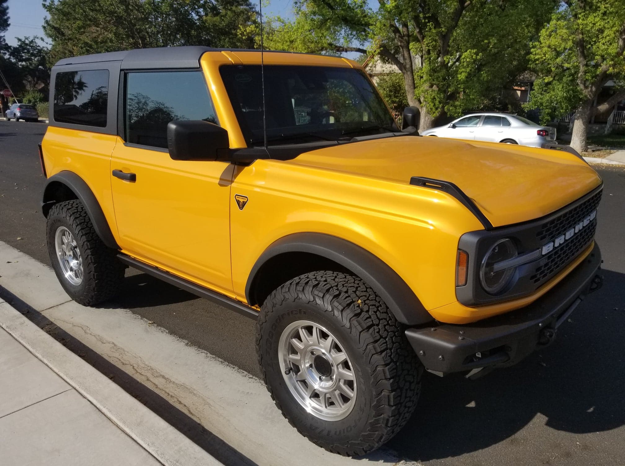

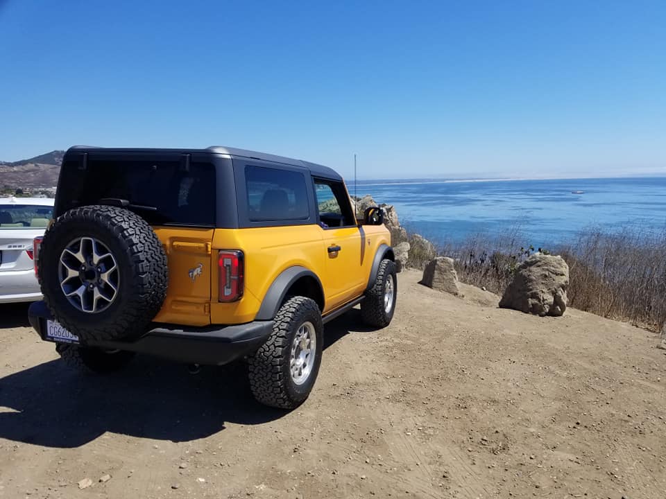

goatman2

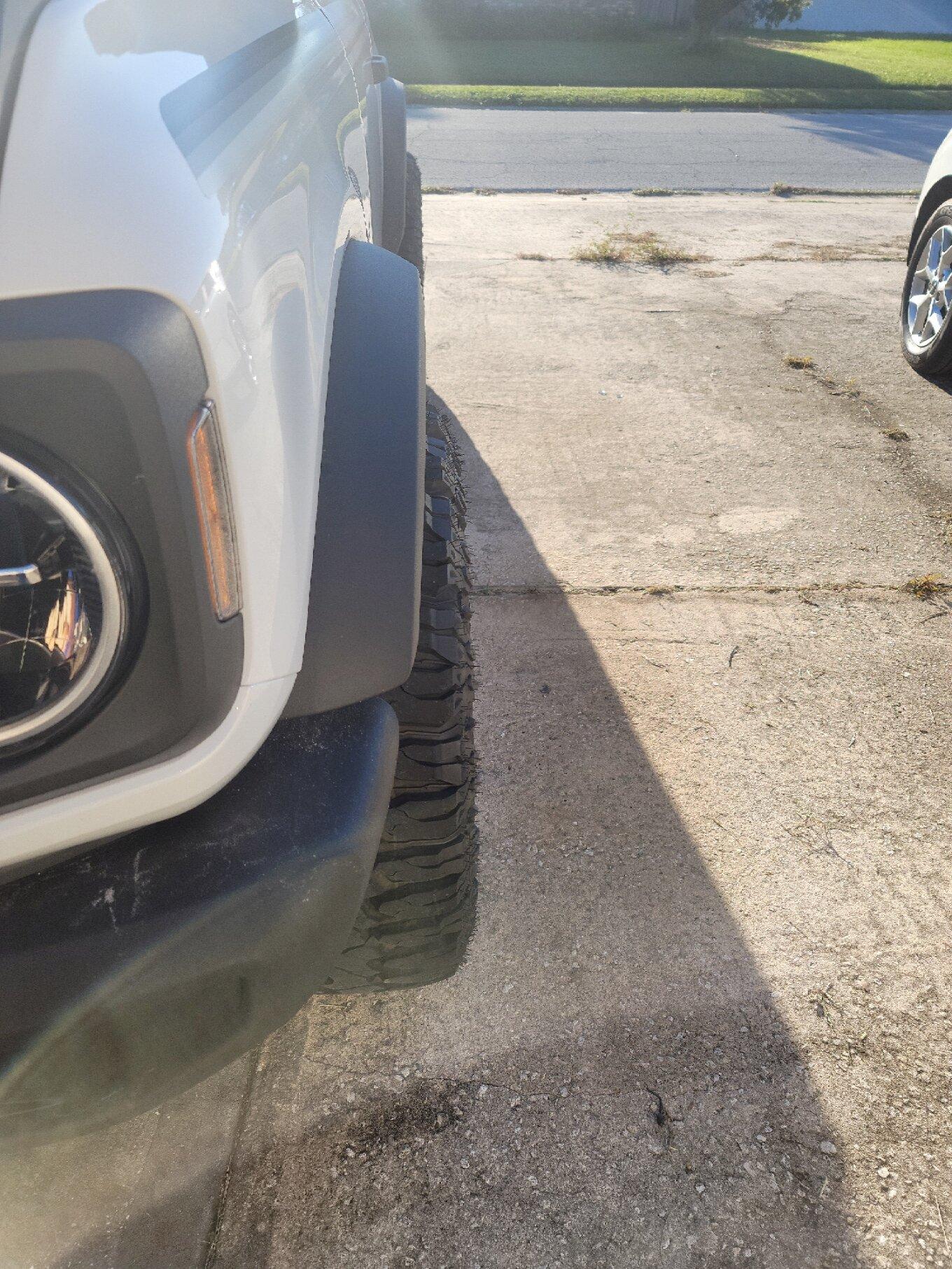

Poke with 33x12.50 with +18 wheels

I figured +18 would poke more. I am trying to find what offset i need to make mine slightly wider than sasquatch
Should be 15mm wider than sas. But then there is back spacing and the tire width itself.

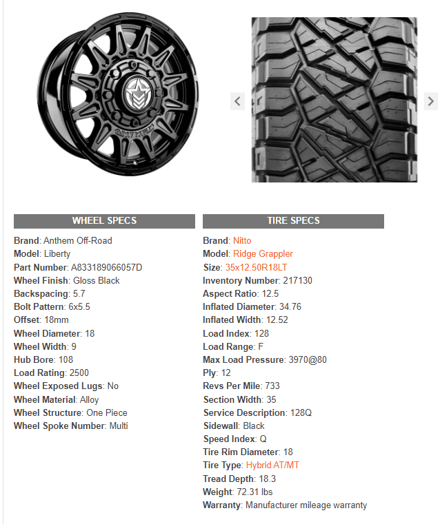

So I think I want to go with this set up. Any thoughts. I am probably going to go with SAS flairs. Will these poke a little? Any thing I need to know when ordering tires and rims?

The concept of both width and offset affecting backspacing (a more important measurement) is often overlooked. My rule of thumb to get perfect poke would be 0 offset on an 8.5” rim or -12 offset on 9” width. those are 2 most common width/offset combinations I see in the wheel brands I shop
