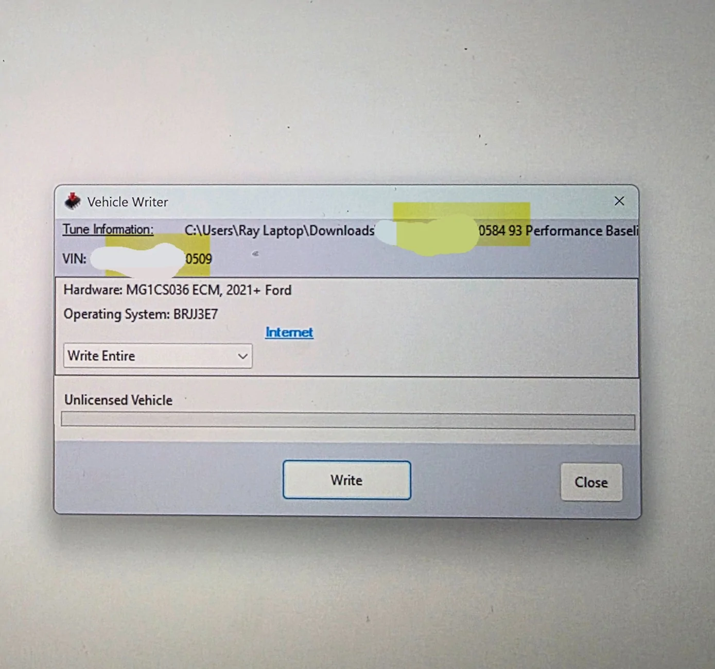

Now this gets interesting, Rev01 tells me that my vehicle is unlicensed when trying to write.
Cool, emailed tuner, and a few days later , received rev02.
same issue, except the license issue pops right after loading vehicle writer
Tuner says email HPtuners, its their issue, Hptuners tells me the tune file has a different serial number.
Looking back at all baseline, rev01 and rev02, surely enough, FILE name is correct with my vin number, but inside vehicle writer, it shows a VIN that is NOT mine.
Looking for advice on what to do at the moment. I cannot flash anything, baseline, rev01 rev02 etc. loading my stock read shows checksum error now. I also cannot read the current tune because its locked, so that atleast indicates that the baseline tune loaded.
The file name has my correct vin. The vin: is way off for my bronco

If it's not much bother. Can you check to see in the write screen. Does your vin match? .
I loaded the baseline tune, so it worked for a moment .

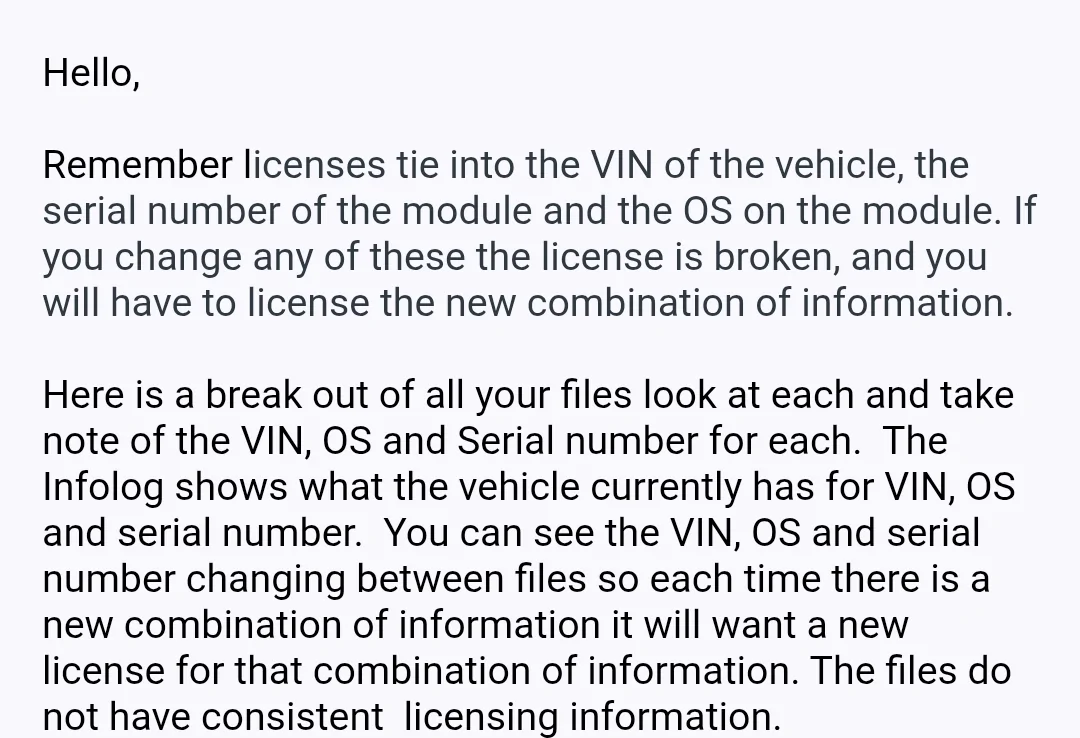

Got that from hptuners. Hopefully my tuner replies soon.... But it looks like I'll need new credits.

Yeah that's not HPTuners fault, that's your tuners fault.
They mixed up your original stock file with someone else.
The way HPTuners licensing is a little odd, but that's how they work so that's what we have to do
