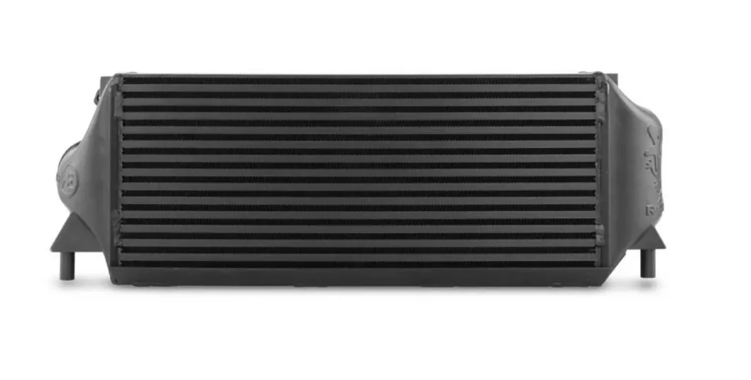

Hey guys, was interested if anyone had purchased a Wagner tuning factory location intercooler for their Raptor. I’m curious if it installs like the Cobb / Cpe as a direct replacement and can keep the shutters. Was also contemplating going with the CPE. Looking to keep it as simple and close to stock as possible and want to retain the stock shutters. Let me know, Wagner or CPE, thanks!

They're all the same core size with the only difference being the end tank design and all of them bolt up to the stock intake piping. So really any of them will work with the stock front shutters. the zip tie method works just fine for retaining the rear passive shutters.
But yes, it'll basically slide right in. I have the CPE. They also have 15% off right now. When you remove the OEM IC, the rear shutters come with it and you'll transfer those over. I drilled a hole in a few spots on the rear passive shutters to slip a zip tie through to make it 100% secure.
I sent Wagner some tech questions and got no response so my money went elsewhere. I'm sure it'.s a fine IC. I do like the CPE end tank design.

I appreciate it, due to the lack of info and response, I’m probably gonna snag the Cpe. I’ve had it in my car since 7/4 lol
