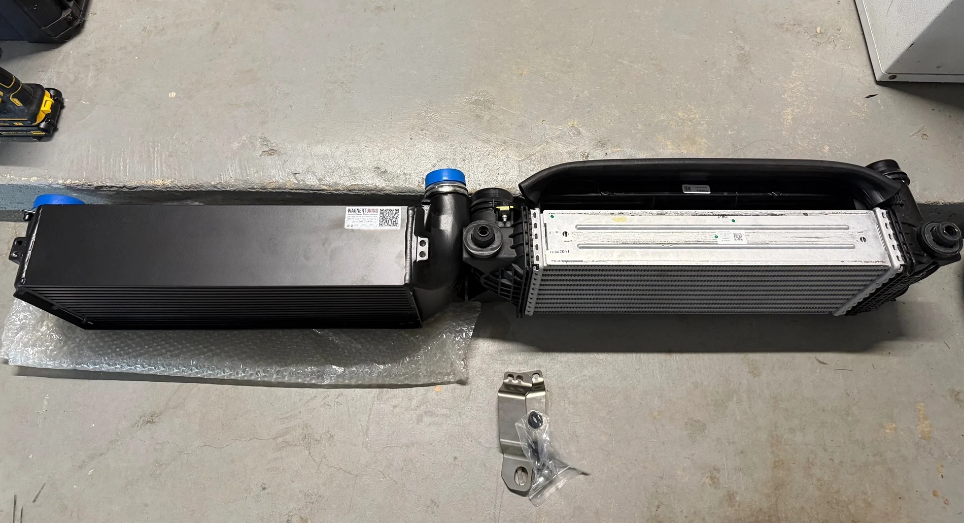

Installed the Wagner Intercooler on my 26 Bronco Raptor. Will say it was a chore, but would have been easier and faster if I had some help instead of doing it solo. The directions that came with it are horrible but luckily it is very similar to the Whipple install. Unlike other bands out there you do have to remove the bumper to install instead of a direct “plug and play”. there was some slight trimming of the rear shutters to get it to fit up against the back and to allow the reconnection of the bottom piping. If you plan installing the Wagner have a friend to help..
