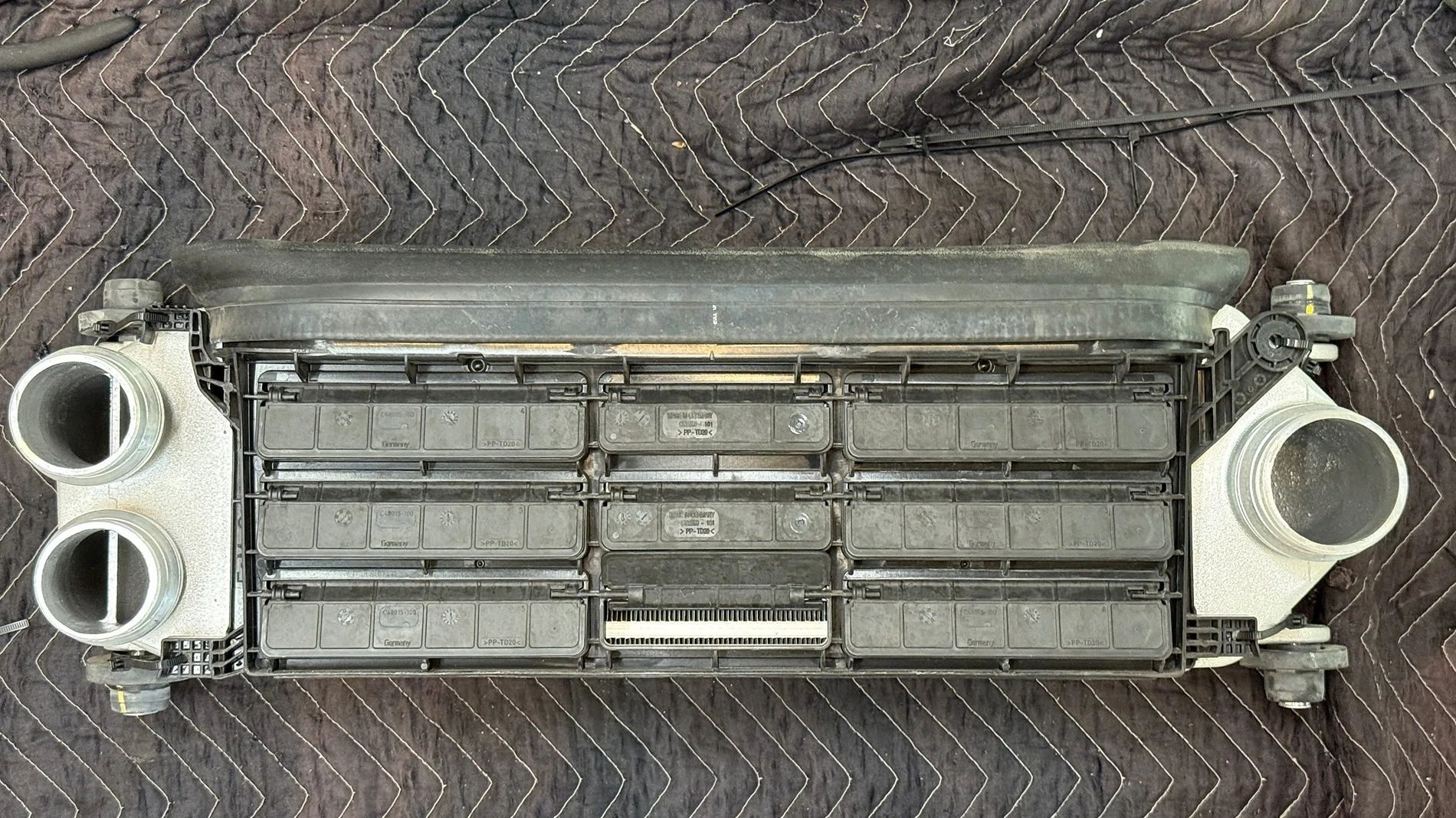

Yeah the rear shutters. I just installed the livernois unit and it doesn’t reuse them either.
the rear shutters close when stationary idling. The radiator fans draws vacuum from above, negative pressure behind the intercooler, the rear shutters close, and draws air from the front across the intercooler. Likely the front shutters are commanded open. Ultimately to avoid extreme heat soak at low mph, idle, crawling. When moving forward the pressure is no longer negative, rear shutters open.
So it does what the intercooler efans on the f150 raptor does. It’s a pretty slick design. Part of me is sad to have given that up.
To your point, the sheer size of the unit and data you’re showing may help overcome the loss even in that single use case. :beer:
Front shutters are really just for gas mileage and anti-icing during certain atmospheric conditions.
Rear shutters can be reused no problem, it just requires zip ties for mounting but is functionally fine. One flap will hit an a/c condenser line and won't fully open but it's 80% there. Mounted to my CP-E which is the same size core.
Ok nice. Does the upper portion still line up to the channel above and seal between the radiator and the fan? To me it looked like the extra thickness of the intercooler blocked that off so it wouldn’t be able to function but I will take another look.
From what I can remember, it does.
When installing these, also take a look at the sealing around the front of the intercooler. I physically took out the shutters from the housing so I'm still using the shutter housing (but with no shutters in it). Provides some duct sealing this way but It's likely worth it to spend some time completely sealing the front up. The thicker core needs all the help it can get in terms of air flowing through as opposed to around it.

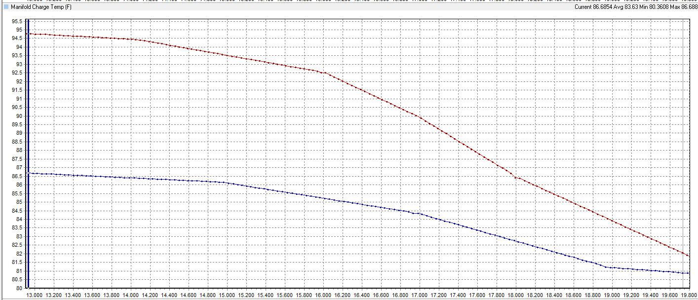

Is there a 10-20 back to back dyno chart and temps log for each run yet? Can do all in less than an hour of dyno time! Cobb has inhouse dyno no excuse not to show everyone unless it's zero benefit in real world.....
I did this on my R&D Raptor after seeing your post, for the community.
This is NOT something I'd recommend anyone do because it's not practical, and airflow lacks on a dyno compared to real street use.
Dyno Room: 64* Ambient temps
Blue line (COBB COLD Truck!), Pull #1 - Charge temps start at 86.51* and end at 81.16*at end of the pull.
Red line (COBB HOT Truck!), Pull #20 - Charge temps start at 94.50* and end at 83.80*at end of the pull.
Ford Bronco Cobb Intercooler for Bronco Raptor - Tested/Data - Amazing Performance 1769970606054-2h

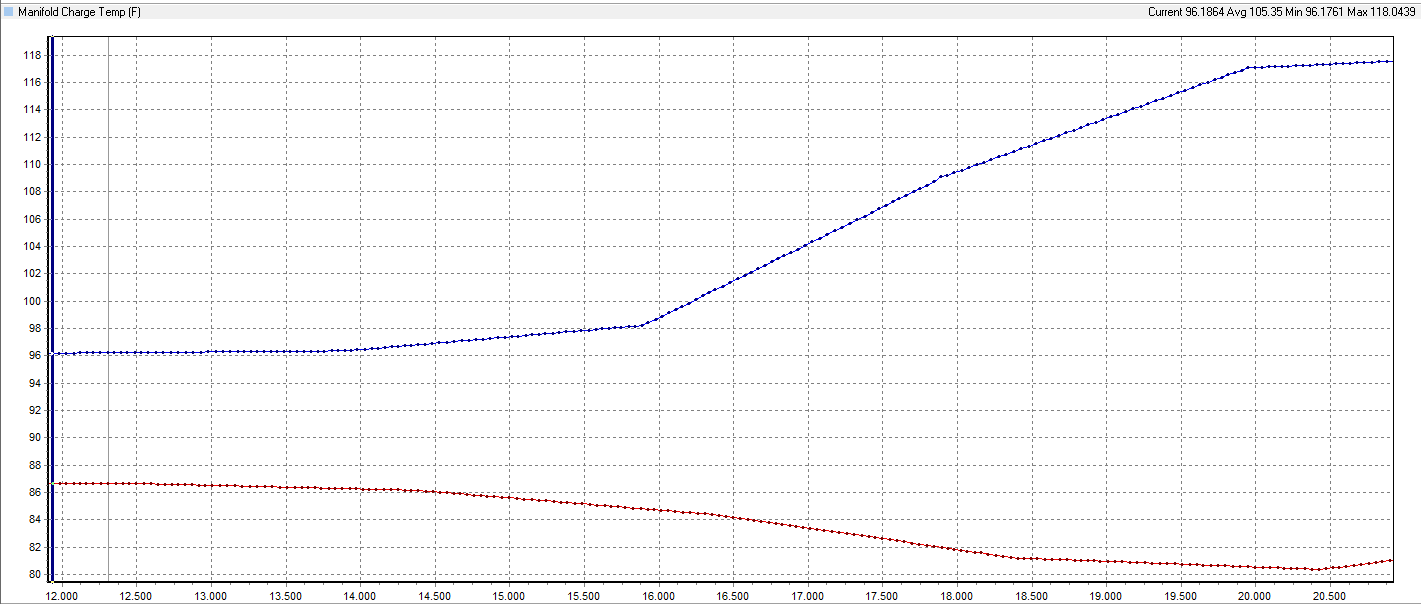

For fun I am going to overlay the stock intercooler (Red line, cold, pull #1) vs the COBB intercooler (Blue line, cold, pull #1 again)
Blue line (Stock intercooler, COLD Truck!), Pull #1 - Charge temps start at 98.10* and end at 117.49* at end of the pull.
Red line (COBB intercooler, COLD Truck!), Pull #1 - Charge temps start at 86.51* and end at 81.16*at end of the pull.
Ford Bronco Cobb Intercooler for Bronco Raptor - Tested/Data - Amazing Performance 1769971200316-yy
The COBB intercooler is clearly doing it's job, even after a ton of abuse. I have this same intercooler on my Ranger. It performs the same.
