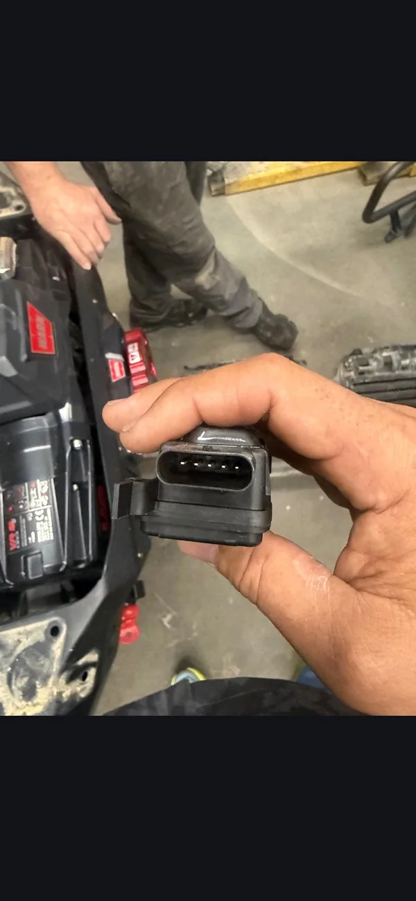

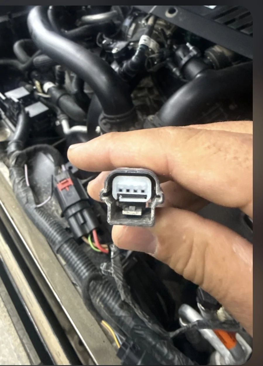

Does anyone know the correct part number for the Actuator Temp Control? Ford Parts states
RB3Z-10884-A but that does not fit on the Raptor 3.0L
My shutters are stuck open (I guess ok) but I am receiving a "powertrain module lost communication with active grill shutter" message- as a result, cannot get high boost power with the turbocharger.

Can you be more specific on which part it is you’re actually looking for?
The connector you’re showing appears to be for the upper shutter motor, but the part you have is the lower motor.
Which one do you need?

The upper shutter motor. Having difficulty finding the part number

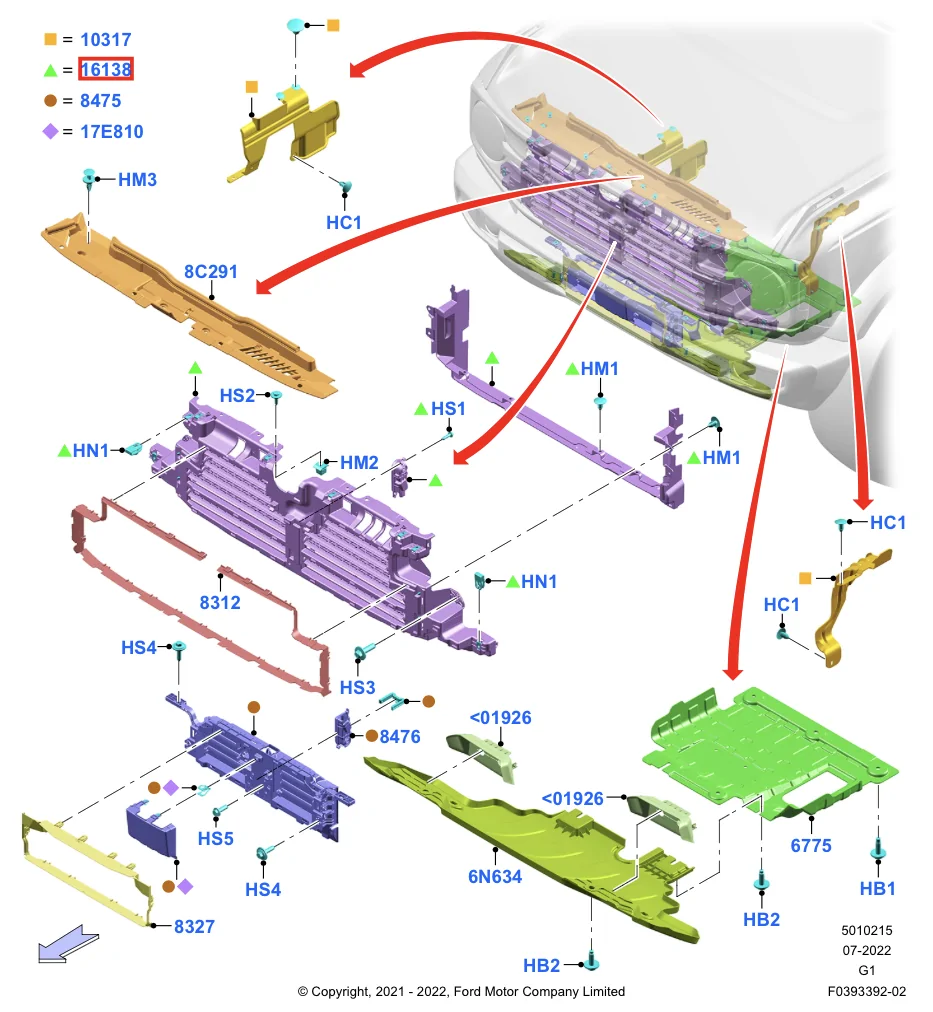

Can’t get it separately. Have to buy the whole shutter assembly. Everything with a green triangle next to it in the picture below.
21-24 Bronco Raptor: PB3Z-16138-B
25+ Bronco Raptor: SB3Z-16138-A
