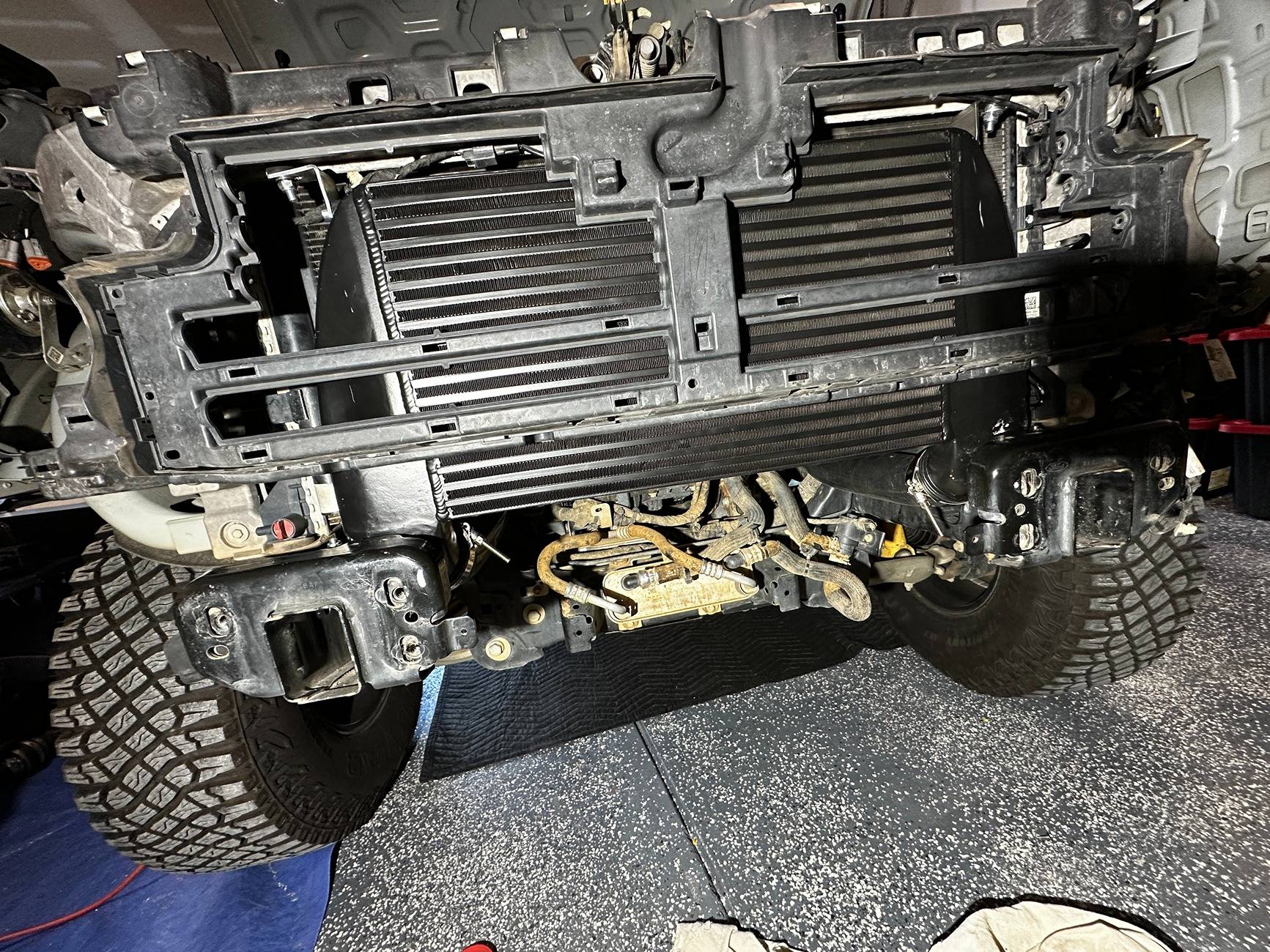

With CVF's high mount (Coming soon for 2.3/2.7) I can get within 5-10 degrees of ambient with moderate sustained boost. Worthwhile improvement over the larger stock location intercooler. Not sure when it will be available for the BRaptor though?
They told me August-ish
Impatiently waiting for this.

I would say it’s 100% worth waiting for the a high mount (relocated) IC if you live in the south or tow and are tuned.
Wish I had thought of that when was burying my CP-e behind the bumper.
Just wondering, you posted this image in the raptor subsection, is cvf releasing this for raptors too?

Keep in mind the Raptor has a Transmission cooler in front of the radiator as well. Putting a massive intercooler in front of the rather moderate sized radiator and transmission cooler and ac condenser is going to increase temperatures for everything else.
There just isn't much room on these trucks. Factory put the intercooler in the best place. Don't block it with bumpers and aftermarket crap. Remove the active shutters and relocate the ACC. This is the best option.
I've seen the stock radiator overload on long hill climbs. That would be the next more important upgrade.

IMO, the best way to add a larger IC within our packaging constraints is to redesign the OEM front skid plate with a larger opening and proper sealed ducting in conjunction with a larger, more efficient core. This is especially true on the Raptor which needs more cooling and not less. Not a fan of the high mount for the Braptor for that reason alone.
The adaptive cruise location certainly doesn't help things. Ford took the easy way out on that probably due to bean counters pretending to be engineers. Not sure how much recalibration/coding would be needed to offset it to the left/right in the bumper but probably a lot. One could always eliminate the sensor and code it out.
It seems there is a very significant mixture here of people and products on both the Raptor and non-Raptor side. The thread was posted in the Raptor section... If I were an admin I'd clean it up...
