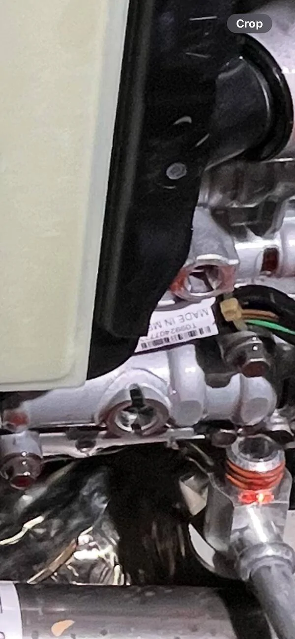

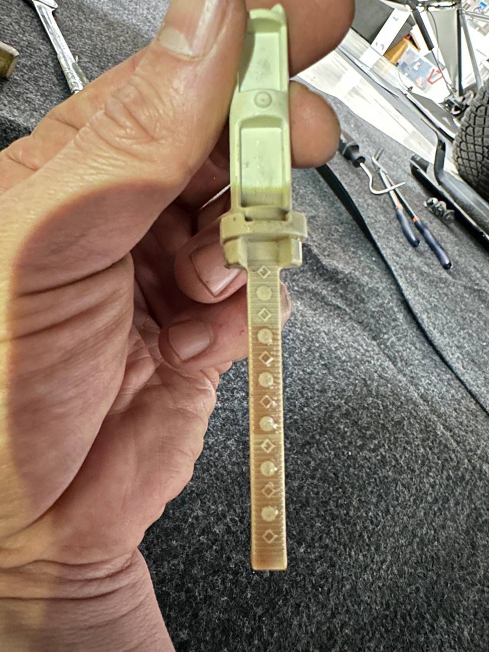

That's a tag off of your internal wiring harness inside the tranny. No, not supposed to park there but it did (and probably really good thing you found it in one piece).

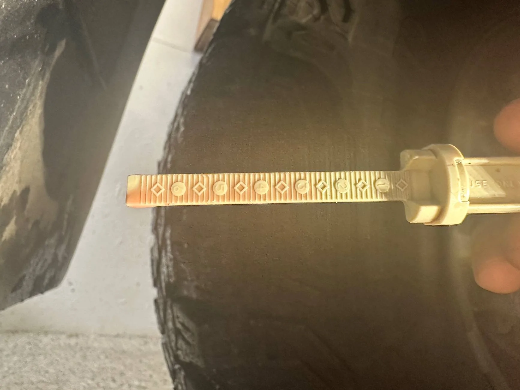

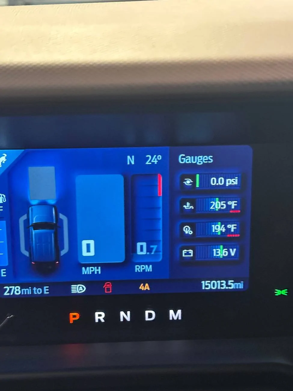

Drove around and got the temp almost to 200 to check it. 194 is best I could do
Ford Bronco Transmission fluid change questions IMG_4339
This was the dipstick level at 194. Almost to 3, I’m going to call that good. So 7 QTs out 7 QTs back in worked pretty well.
Ford Bronco Transmission fluid change questions IMG_4338

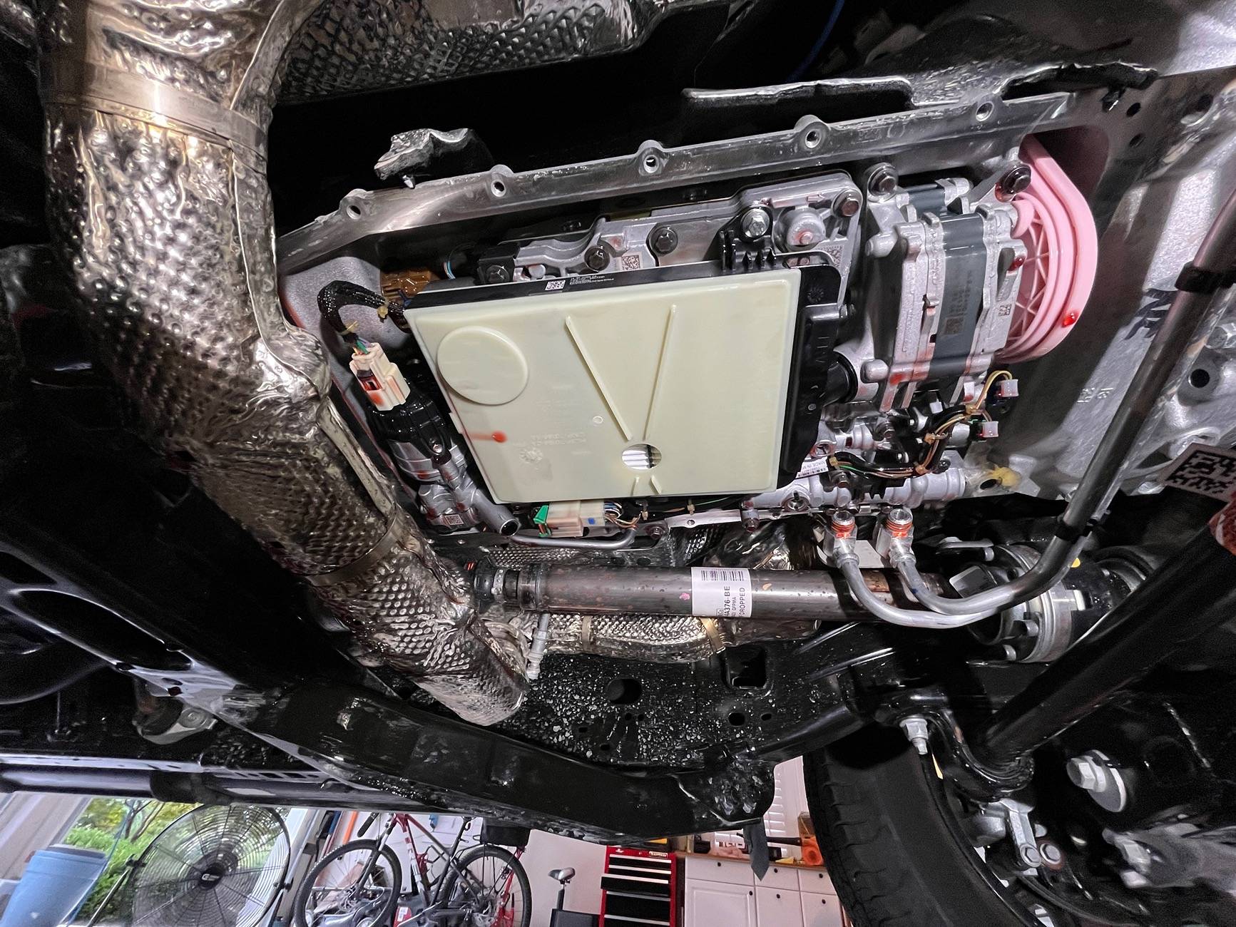

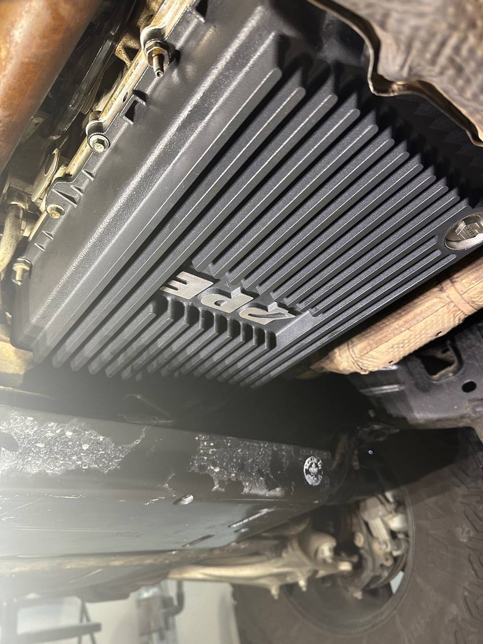

The Pan
The Pan
Yeah that’s probably overfilled by 1/2 quart or so, but it should be fine. Just goes to show how much thermal expansion there is with ULV between ambient and operating temperature.

thanks for all your help on this thread and others, very much appreciated. I sucked up about 1/4-1/2 quart with the mityvac and will leave it at that. Too many burns to want to check it again at temp!

I would not recommend trying to torque the drain pan bolts to 18-22 ft lbs like PPE said. I just firmed them up with a 1/4” socket wrench in the specified cross pattern. Mea culpa for not realizing right away that was way too much torque for an 8mm bolt.
I think you are reading the instructions incorrectly. PPE says the pan bolts get torqued to 8 ft lbs. It's the drain plug that gets 18-22 ft lbs.
Tighten in a crossing pattern
(Fig.1). Torque to 8-10 ft lbs.
(Tighten Drain Plug to 18-22 ft lbs
and snug NPT plug)
I don’t doubt that’s what they meant but look at how it is phrased here. It says to tighten (the pan bolts) in a crossing pattern then on the same line next sentence says torque to 18-22 ft lbs. I should’ve had enough common sense not to do that but at 1 AM crap happens. Luckily just 1 out of 18 stripped so I think it’ll be fine until I drop the pan again in 3 years.
I had to do a double take when it stripped to make sure I wasn’t imagining what I was reading. These instructions came in the same package as the pan.

This was unfortunately all I could get out with the MityVac before dropping the pan. About 2 quarts.

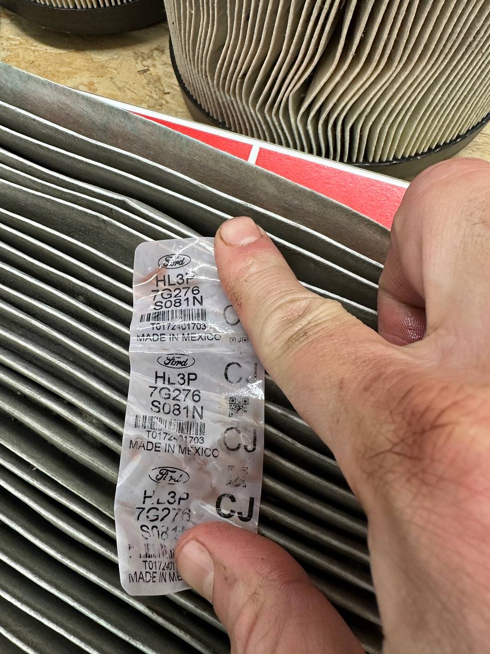

Lookey what I found in my filter! Some kind of “made in Mexico” tag hanging out of it. First time I’ve ever had this thing open in 15,000 since new. Glad I did this, lol.

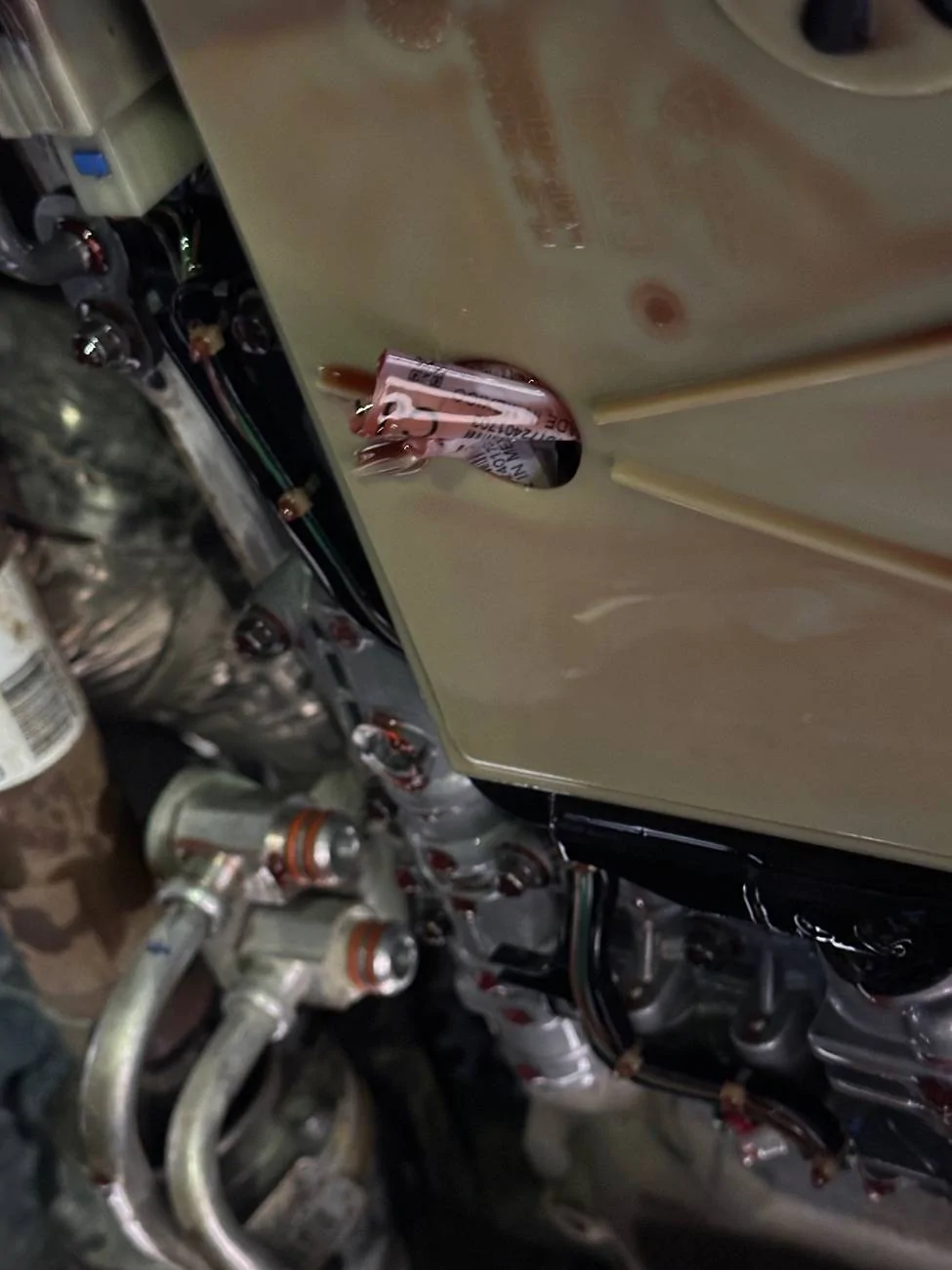

This was hanging out of the filter, I’m going to guess it’s not supposed to be there.
Well...sh*t. Guess I'll let the paranoia creep in now too, and will plan on taking my pan back off to get that damn tag out of there! Here's mine...see it? If that thing blocks the filter port and restricts the fluid flow, then no bueno.... Ford needs to issue a recall for this tag!

I wouldn’t worry about the tag. I’ve had hundreds and hundreds of 10 speeds apart and I’ve never once seen that tag come off or plug the filter. It’s an absolute fluke
Whew, good to hear!! Looks like a different part number too between the two tags. Odd how his was folded up like that too instead of bunched up. I'm in agreement with you, and certainly going to listen to your experience, in that I can let this worry go to the side! When I do the drain/fill in about 20k miles, I'll see if I spot anything in the old fluid that looks tag related. Whole reason for me to upgrade to the PPE pan was for the ability to do the drain/fill every 30k-35k miles or so. My OCD is showing, I don't deny it...
