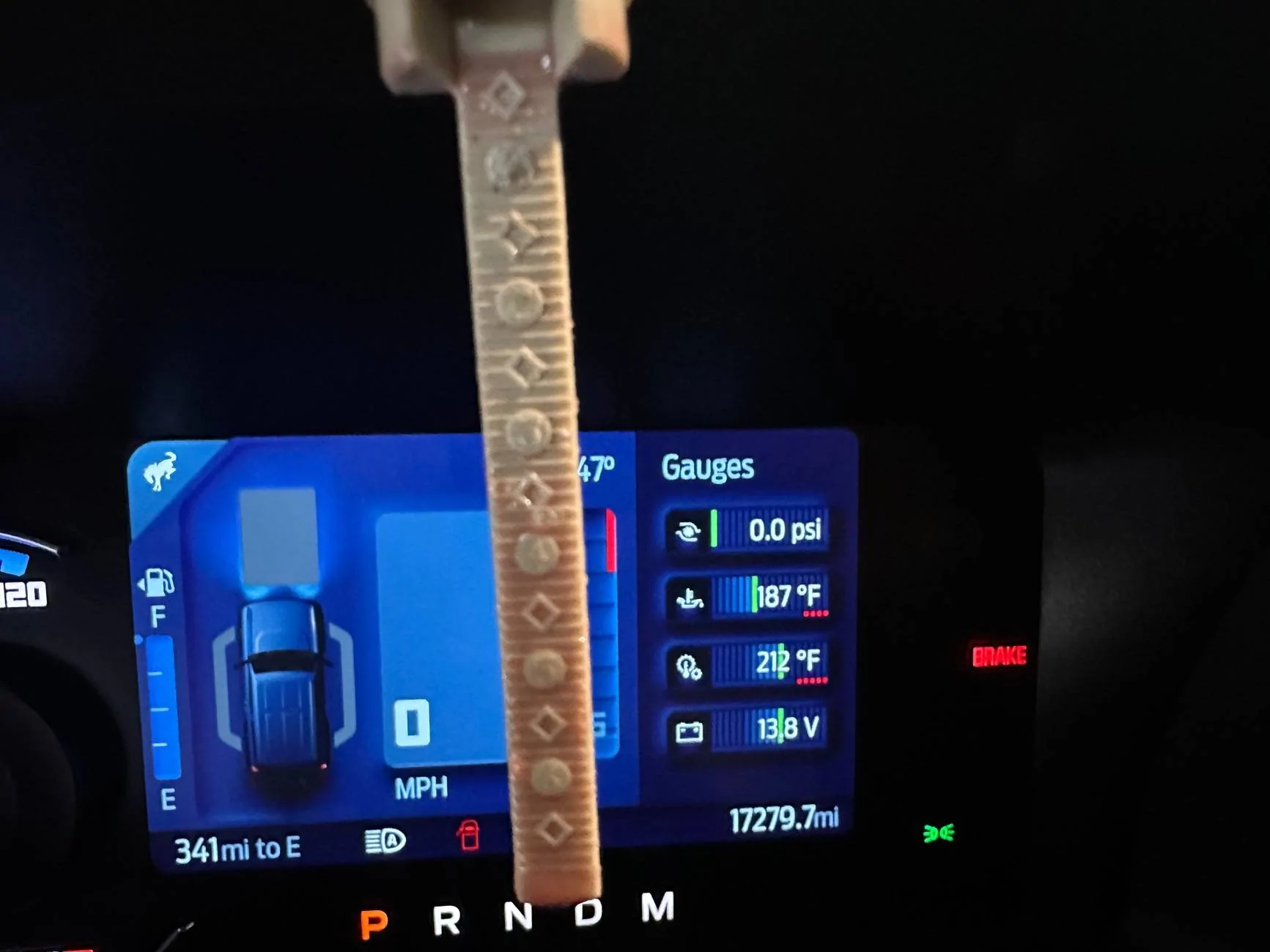

At 17,300 miles, did my first fluid exchange since dropping the OEM pan for the PPE standard capacity pan at 15000 miles. It was about a dot low before I drained, so about 5 QTs out and 6 QTs in. This was the level at ~210F after I refilled.

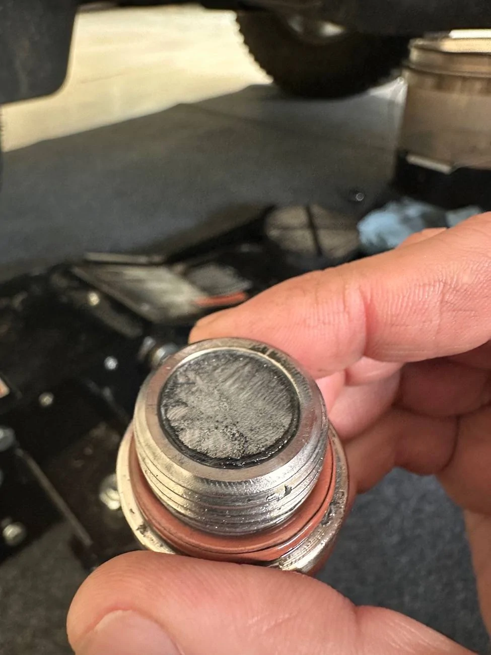

Not too much on the drain plug magnet, but this o-ring is worn out.

Unfortunately after you refill you need to check the fluid level with the engine running and the Bronco in Park. You also need to get the transmission fluid up to 206-215 degrees. At this temp the dipstick needs to read between the 3 and the 4 for fluid level. I find about 1 pint (0.5 quarts) moves the level up or down one number at 206-215. So if you’re at the 4.5, add 1/2 quart to get it to 3.5, or if you’re at 2.5 drain 0.5 quart to get it to 3.5, etc.
You can get to ~210 degrees by driving but if it isn’t enough, you can try “torque braking” which is putting the vehicle in drive, holding the brake and also pressing the accelerator. I wouldn’t do it for more than 30 seconds at a time. The temp will probably keep rising for a minute or two after you stop torque braking.
