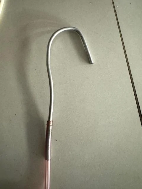

There is candy cane shaped tool that you can buy off ford ($100 + from what I remember). I made my own from some aluminum 1/4" tubing that can be easily bent into any shape. I slide some clear rubber hose over the end of the aluminum tubing to extend it about 3"-4" to the bottom of the pan. The rubber extension isn't shown but it slips over just like it does on the other end. Super easy and cheap.
Nice. Thanks. I can easily do that at work

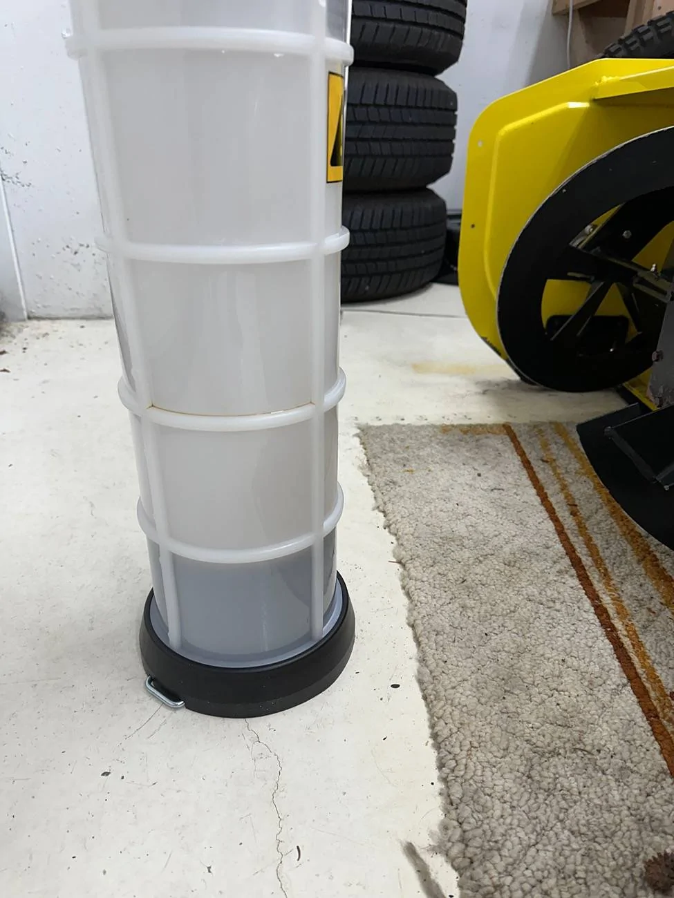

This is what my dipstick was at cold with the engine shutdown for 6 hours. By the way the cover for this thing is truly annoying to take off, confined space and torqued like hell, yet also boogers/strips easy. Needed a 19mm wrench that had a captured/ratcheting function. I could not get it off with an open ended although someone more talented probably could.

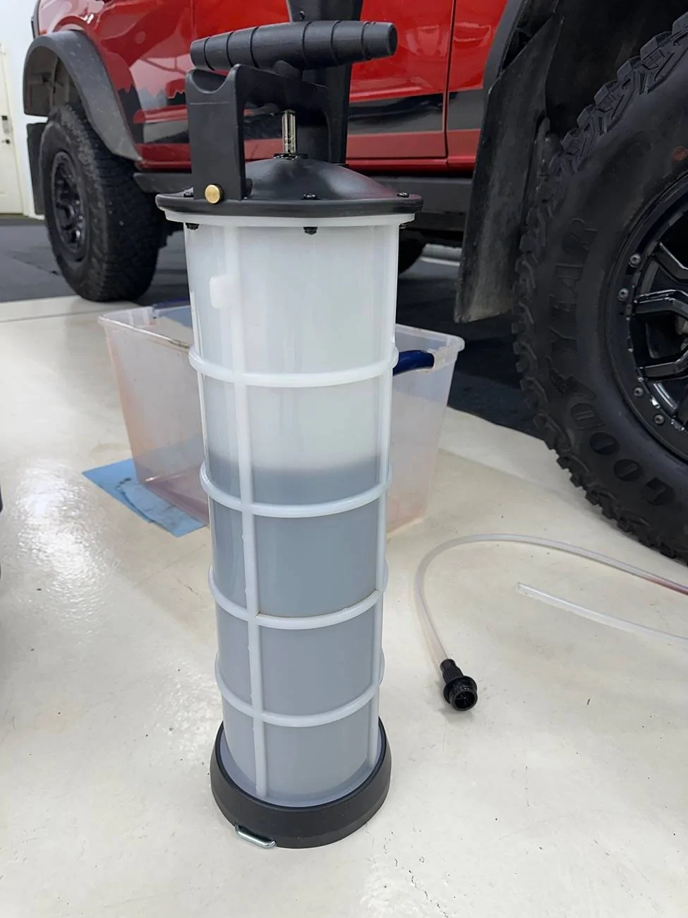

This was unfortunately all I could get out with the MityVac before dropping the pan. About 2 quarts.
Ford Bronco Transmission fluid change questions IMG_4329
I dropped the pan into a big Tupperware storage container then funneled everything into the mityvac. This tube is 2.3 gallons so this worked out to about 6.5 quarts. I probably spilled half a quart. I tried to put 7 quarts back in and spilled about half a quart of that too. Dipstick was just barely touching the 6 at the bottom of the dipstick with engine running and transmission tempt about 80F.

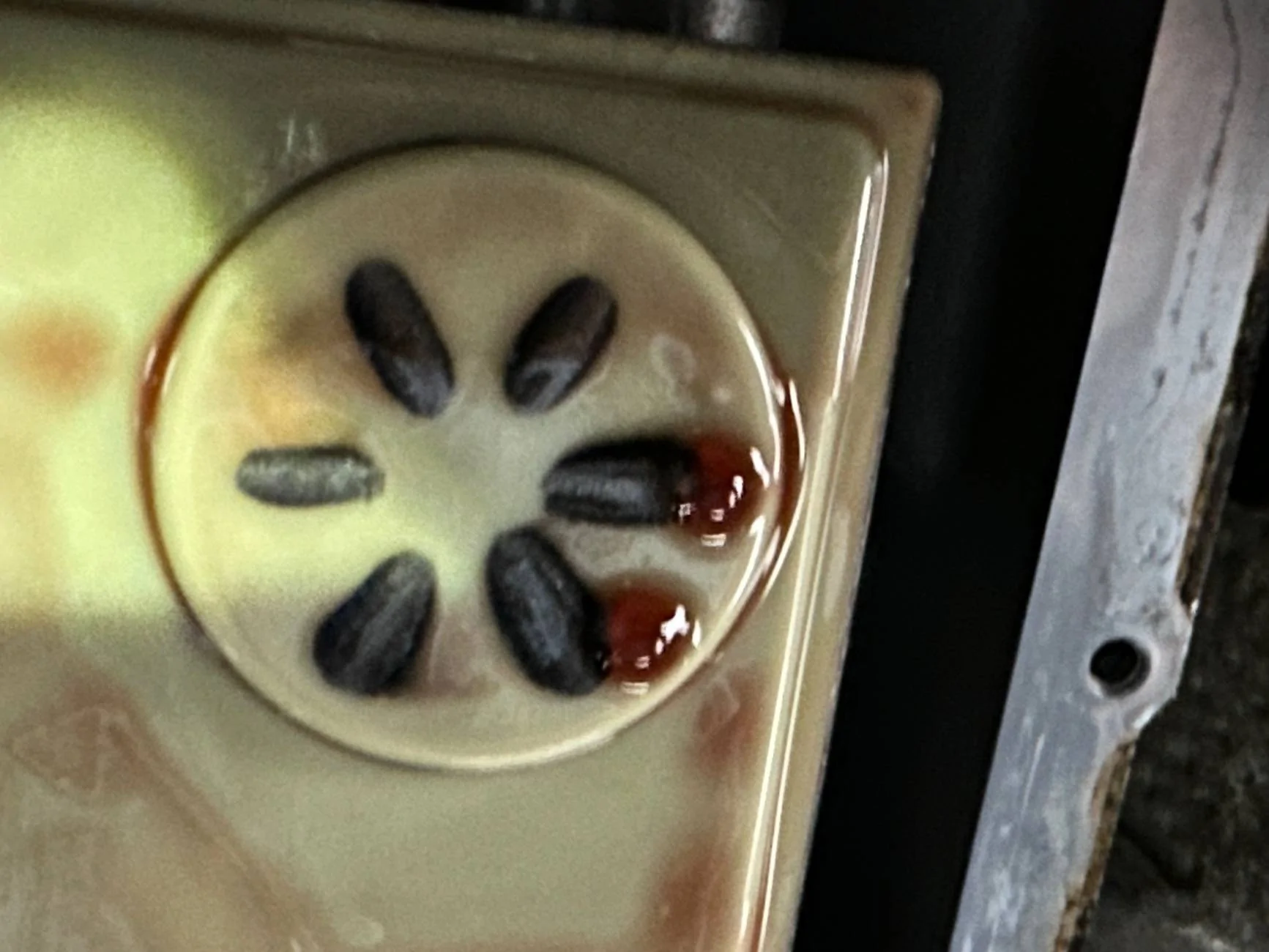

Lookey what I found in my filter! Some kind of “made in Mexico” tag hanging out of it. First time I’ve ever had this thing open in 15,000 since new. Glad I did this, lol.
Ford Bronco Transmission fluid change questions IMG_4331
This was hanging out of the filter, I’m going to guess it’s not supposed to be there.
Ford Bronco Transmission fluid change questions IMG_4333
Magnet crud on the filter at 15,000.

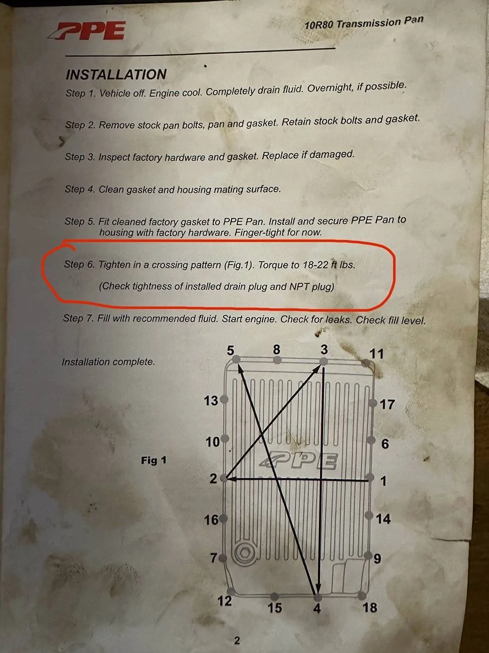

I Replaced the filter and put the PPE pan on.
I would not recommend trying to torque the drain pan bolts to 18-22 ft lbs like PPE said. I just firmed them up with a 1/4” socket wrench in the specified cross pattern. Mea culpa for not realizing right away that was way too much torque for an 8mm bolt.
Ford Bronco Transmission fluid change questions PPEinstruction
