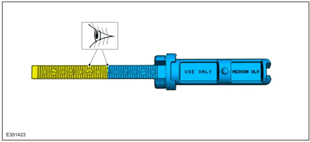

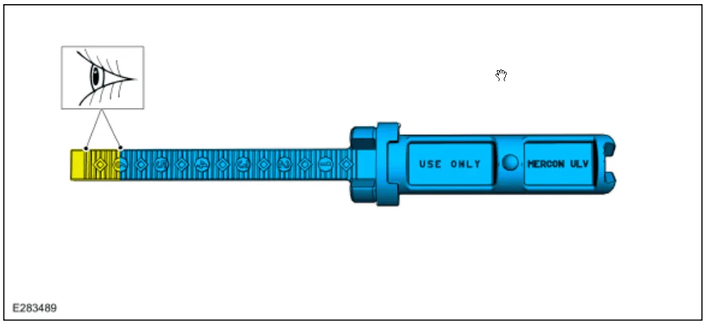

Fully agree and would add that it should be changed early in the transmissions life to remove the break in metals.
EDIT - after watching this video (from this point), it verifies that at ambient, if you are a "box" level below the required level at full temperature then it will be at the proper level when it is at full temperature.
Ergo, since the 10R60 in the Bronco is supposed to be between 3 and 4 at full temperature, if you fill to between 4 and 5 at ambient, you should be good at full temperature. I would still check, but at least the filling will not need to happen when the catalytic converter is at branding temperature.
Initial fill from the service manual with fluid at ambient temperature:
Ford Bronco Transmission fluid change questions 10R60 Initial Fill
Final fill from the service manual with fluid between 206°F and 215°F:
Ford Bronco Transmission fluid change questions 10R60 @ 206F-215F
I searched for that post (I definitely remember seeing it), but could not find it. I have a bad memory, but I seem to recall that if the transmission is filled to between 4 and 5 initially, that it will be at the proper level when at temperature (@Ducati1098 - do you know?).
It needs to be between 3-4 at operating temp (206ºF - 215ºF)
Ford doesn't give a cold fill level, but the fluid level will rise quite a bit from cold to operating temperature. So during first start up, I try and make sure that there is barely any fluid touching the dipstick after starting it, then let it warm up completely and adjust from there.
EDIT: I guess they technically do give an initial fill level when cold, I never noticed that before. But like I said, I always make sure it's just barely touching the dipstick and then it is okay to be driven/warmed up to operating temp to make your final adjustment to 3-4

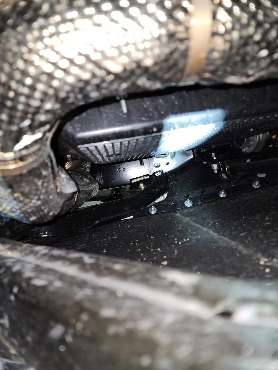

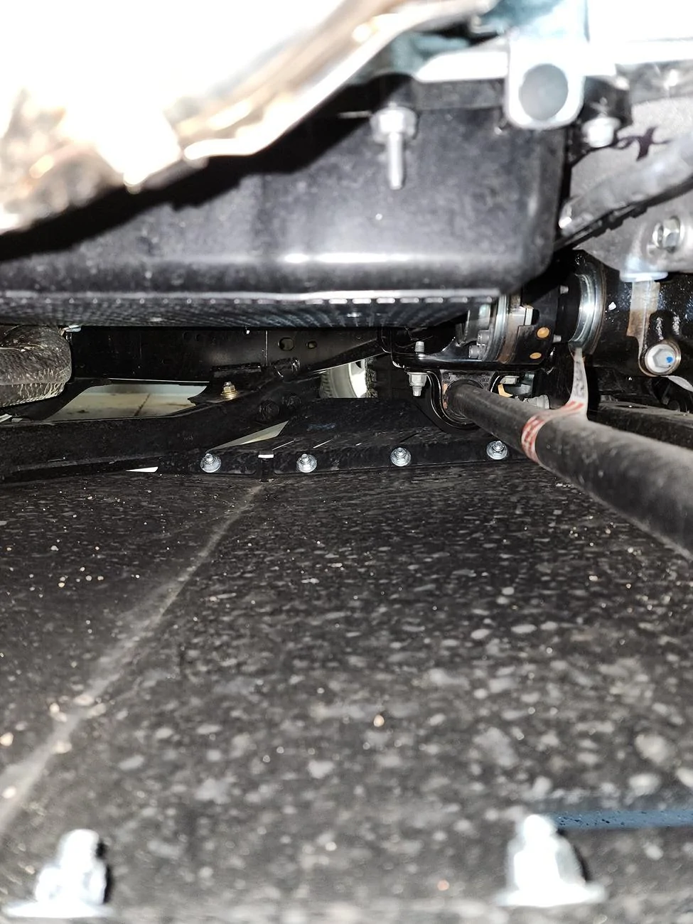

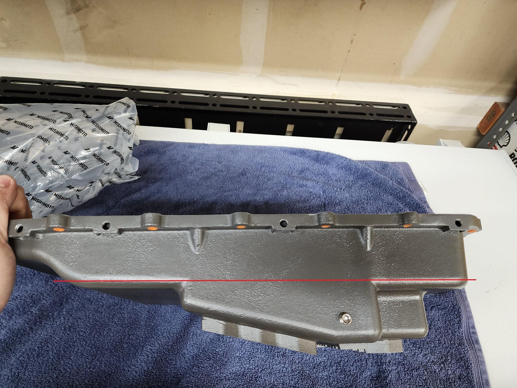

I will be doing within the next two weeks. There should be plenty of clearance:
Here is a Mishimoto, I reviewed, the PPE is the same design but perhaps a 1/4" less shallow. The red line approximates the OEM pan.
Ford Bronco Transmission fluid change questions Mishimoto
Front pan area with RCI skids:
Ford Bronco Transmission fluid change questions Front Pan Vi
Rear pan area with RCI skids:
Ford Bronco Transmission fluid change questions Rear Pan Vi

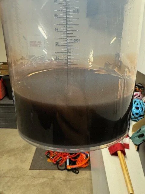

Here is what 30K mile trans fluid looks like compared to new.
Ford Bronco Transmission fluid change questions IMG_8167

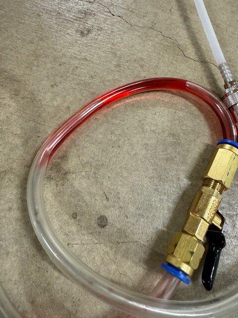

If you have a mighty vac you can suck pretty much all of the fluid out of the pan from the fill location without having to drop the pan. In fact I suggest you do that even if you are dropping the pan to change the filter. It is a much cleaner experience doing that way. If you are dropping the pan replace the filter (it is cheap), and I can tell you at 30K miles when I did it the filter and magnet in the pan had some very fine pasty metal build up. Then you get all of the break-in junk out. It is a no brainer with these modern 10 spd. transmissions. So many places to accumulate debris. I can see waiting until 50K miles but 150K is an insane number. Your fluid will be black and the damage done.
The hardest part about changing the fluid is filling it to the proper level. You have to get it to the proper temp and check it while the engine is running. The exhaust is right there so you will probably burn yourself a little.
did you just stick the hose end in to suck out the fluid or you have a screw in fitting? Thanks
