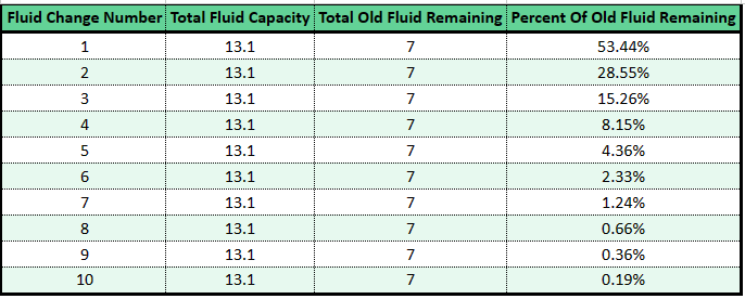

To your point about how much fluid is needed to have all "new" fluid, provided you dump about 6.1 QTs per change (which is what the Ford tech told me) it will take about 24 QTs to go below 10% old fluid:
Helps a lot if you have the time to let it sit and drain as long as possible also.
There are some at work that I'll pull the pan and the filter to do some type of repair, it'll sit over night and I'll need ~10 quarts or so to get it back to the correct level the next day.
I don't know the numbers for that amount, but I'd guess it would cut it down a decent amount.

The Ford tech told me the pan holds about 5QTs and the filter itself as well as the amount that drops when it is pulled is about another 1QT (which is where I can up with the 6.1 QTs in the formula).
If you have a better number, let me know and I will edit the spreadsheet.
Yeah that sounds correct if the pan is dropped, filter replaced and the pan put back up right away. All I'm saying is the longer you let it sit with the pan and filter off, the more that the transmission will drain out. The exact amount depends on how long it sits for.

Gotcha. OK, I modified the sheet to have 3 tabs (6.1 QTs drained, 7.1 QTs drained, and 8.1 QTs drained).
This should provide a general idea of how many dump and fills are needed based upon the amount drained to get below 10% old fluid.

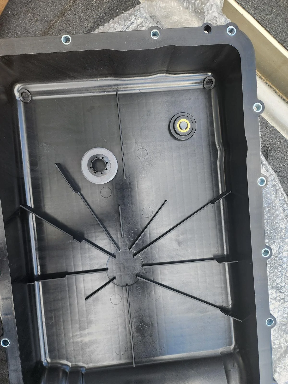

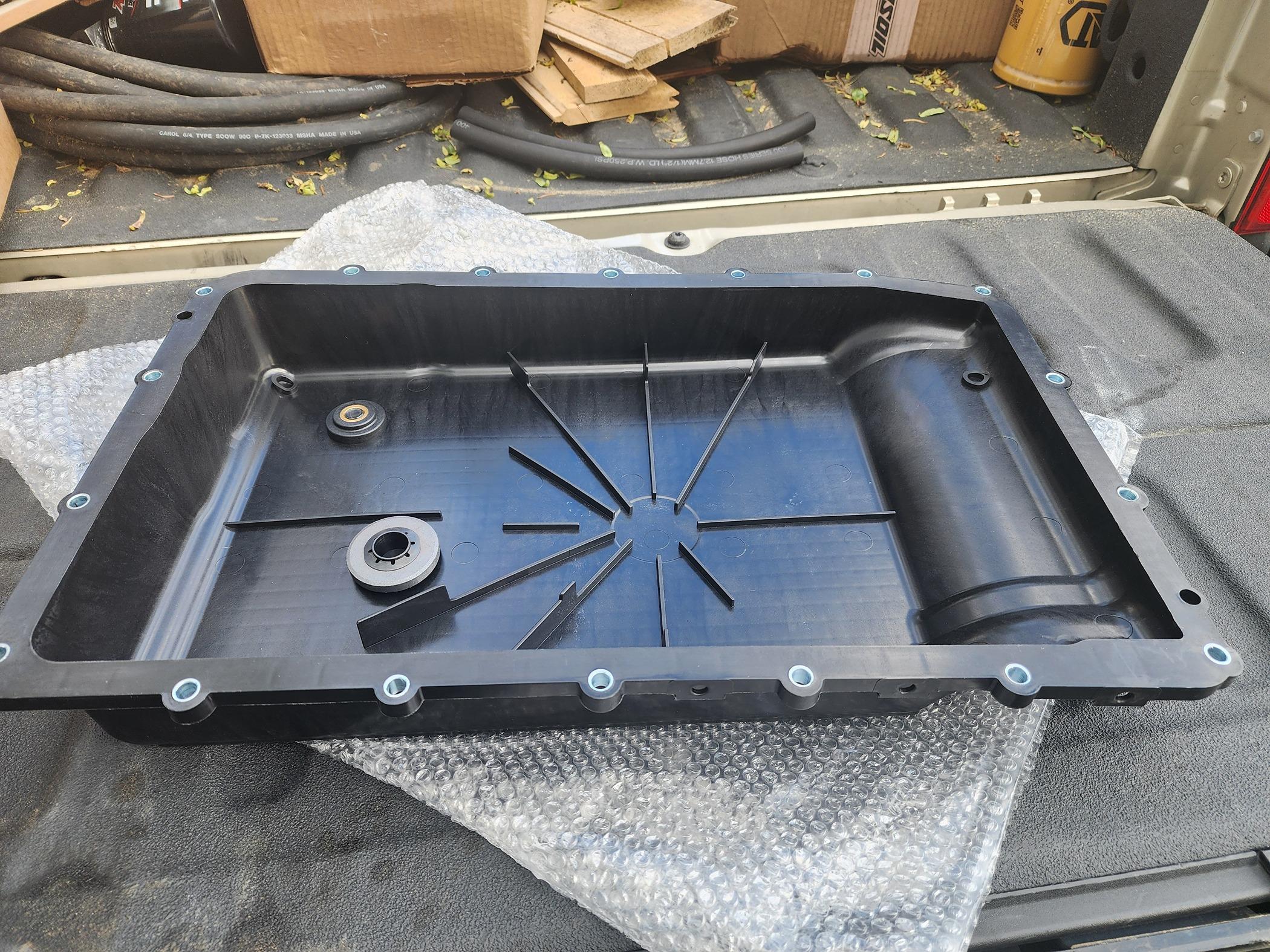

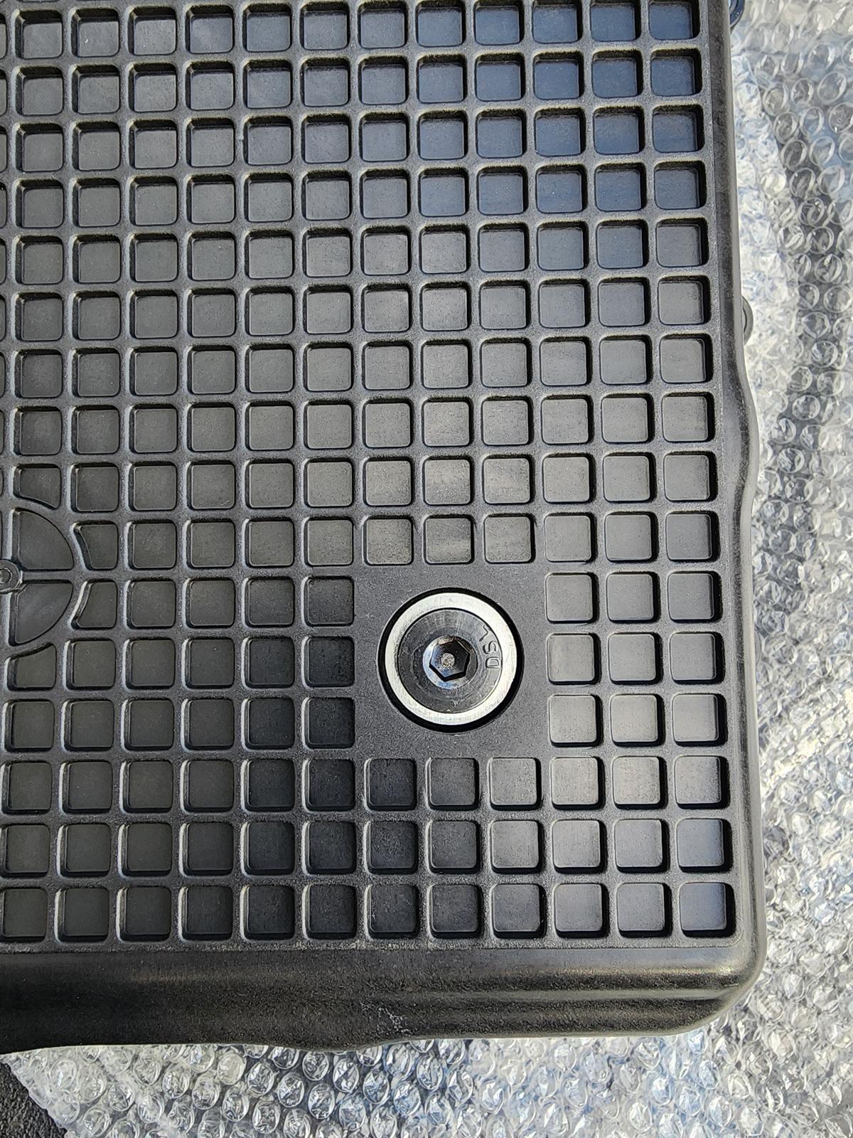

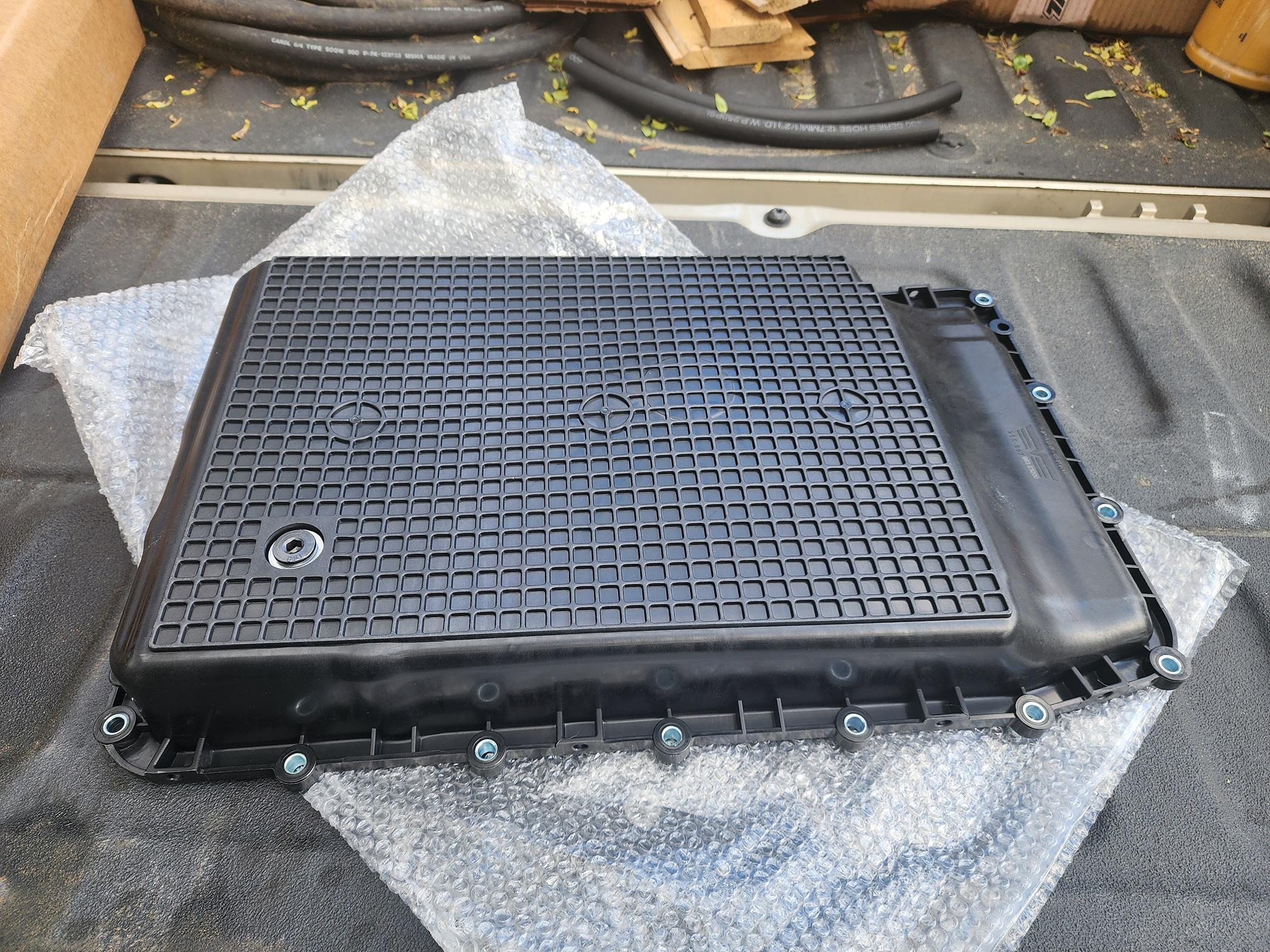

Got the $50 pan. Have to say I'm very pleased, no less quality than the original and the drain plug is very suitable, as the bronze/alloy is molded into the pan and the drain plug is metal with machine threads. I would say the only reason why the factory does not do this is cost savings.
The pan bottom is sloped so if the vehicle is parked level then the drain is in the lowest part of pan however the molded lip around the plug will cause fluid to not fully drain. I would guess ~1/4 quart of so would be left.

Did the mating surface seem flat? Or if you have it installed, any issues?
Yes it was flat, just like the OEM one, made by the same tier one supplier.
