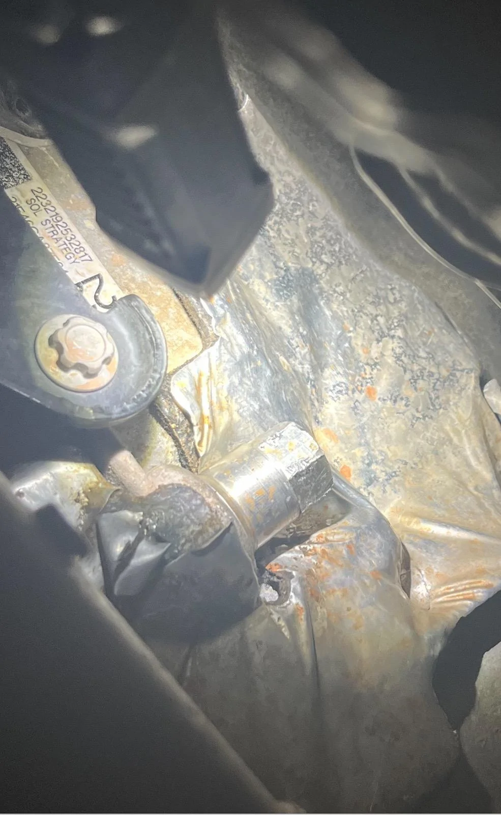

This beats the OEM plastic! I installed PPE pan the day after delivery, but regardless my new issue is how cheap the aluminum fill cap is, have you seen that? I checked my dipstick recently just for the heck of it and the head is already chewed up. Largely because it’s so hard to get a box wrench on and turn.
Ford Bronco Trans pan w/drain by Dorman IMG_8005
I hope Dorman or someone come out with a decent replacement.

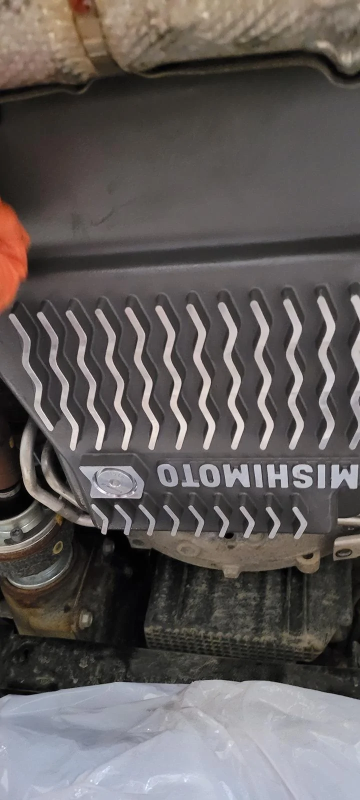

For me it's MISHIMOTO ALU PAN = MORE OIL+ PLUG+O RING GASKET+ RIB FOR MORE COOLING.
TRACKTOY
