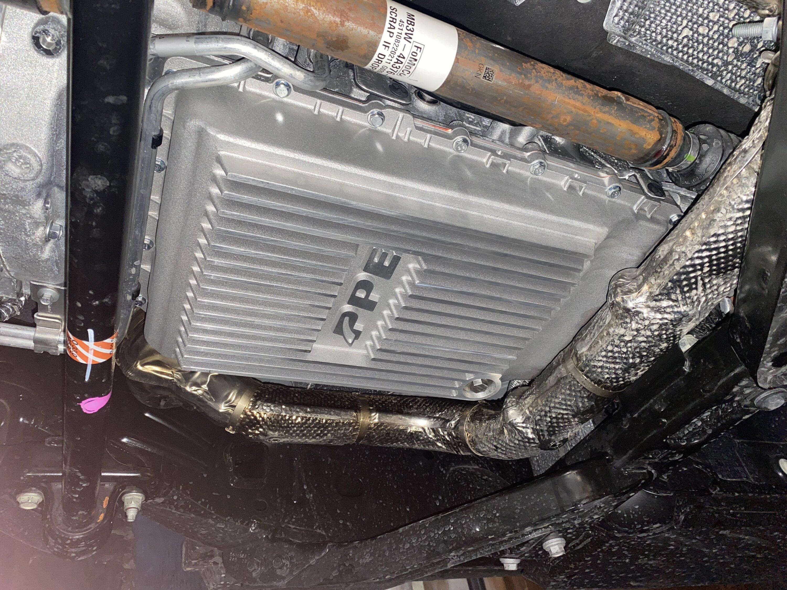

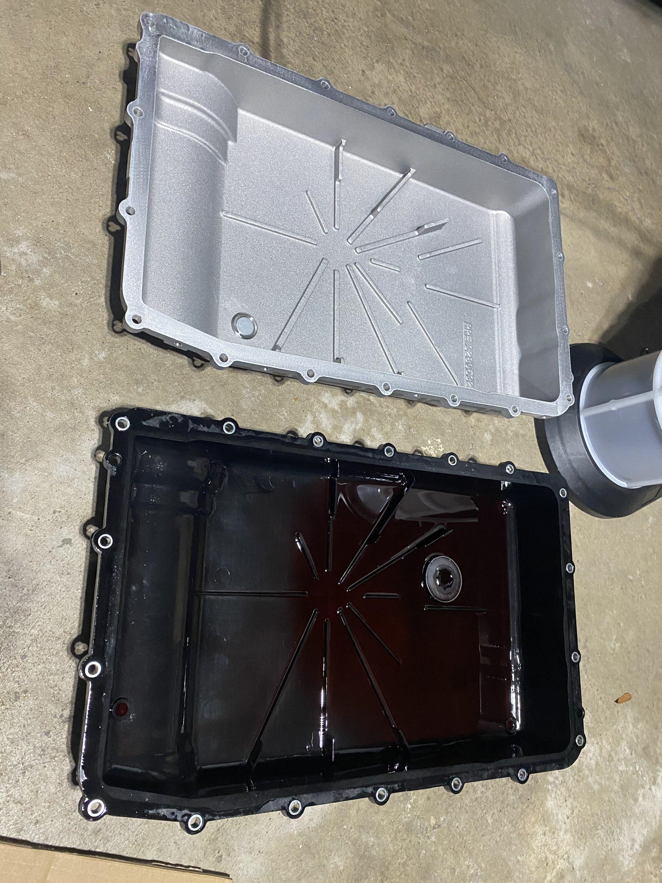

This pan is exactly the same volume as stock. PPE does offer a deep pan, but I am not sure if it will work on the Bronco due to decreasing the ground clearance.
I haven’t seen a reduction in operating temperature yet, but haven’t towed or driven it hard enough to exceed the capacity of the stock cooler. I will update as I put more miles on it in varying conditions.
Forgot to ask - is it dimensionally any taller than the stock pan? Curious how it might affect skid clearance...
It’s about 1/2 inch lower in the front, and 1/4inch lower in the back. Probably will not interfere with any skid plate.

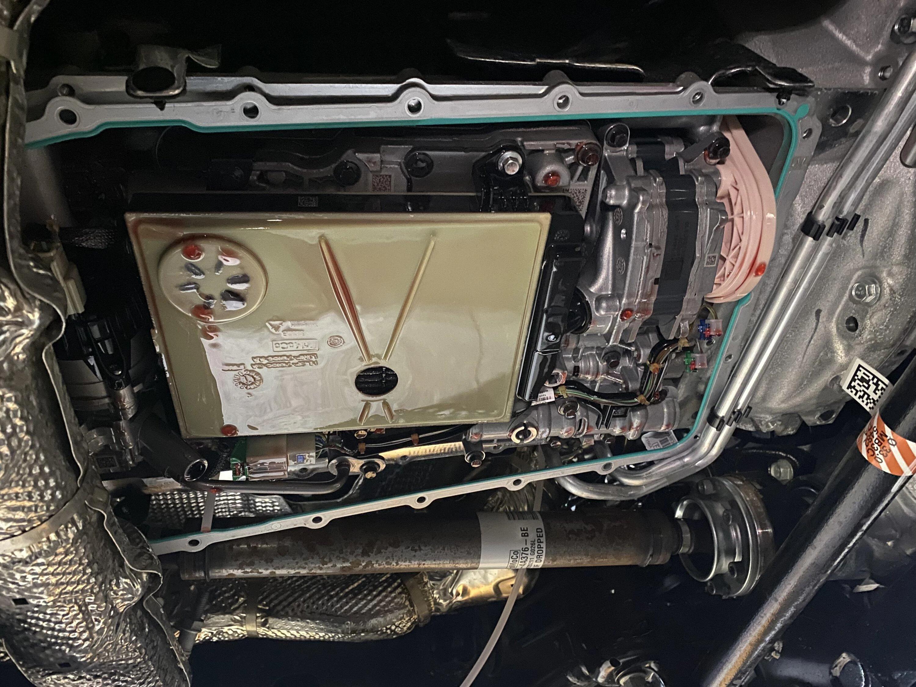

Actually, I can not. I used a Mityvac to suck the fluid out of the dipstick hole on the side of the transmission. The oil in the OEM pan in the first photo is all that was left, about 4 ounces. I removed the pan without spilling a drop. I measured the oil I removed in a graduated cylinder, and replaced with the exact amount. Prior to doing this, I measured the volume of each pan to ensure it is exactly the same. It ended up being 4 1/2 quarts, that was drained and replaced. I also discovered, as expected, that when cold, the fluid level in the pan remains below the pan gasket.
Of note, I had a new filter and gasket on hand, but did not use either. I only had 2500 miles, and there was no metal fuzz on the magnet in the OEM pan. I purchased a 12 qt. case of Motorcraft ULV from Rockauto. (Approx. $85 with tax and shipping)
My plan is to drain the 4 /2 qts. or so every 15 to 20K, and replace with fresh. I have owned 22 Fords, including 6 that were purchaed new. Following this routine, I have never had a transmission issue of any kind. This includes multi generations of Mustangs, Explorers, F150s, and a Fusion, and over a million miles combined. I don't have anything other than anecdotal evidence that it is beneficial, but I enjoy doing all of my own maintenance, and as a result, it is very inexpensive.

Do you know if that pan is available in a black finish also!

Yes. I reused the original gasket. 7 months later, it has not leaked a drop.
