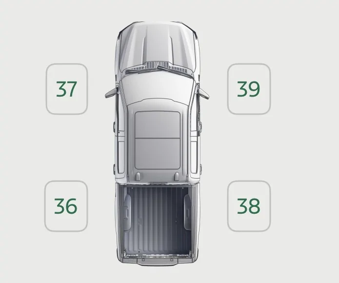

Every time I leave the dealership, my tire pressure is a crapshoot. Literally all 4 tires are on different numbers. Is this normal? Running 35” Nitto Ridge Grapplers.

I mean they're within 3 lbs of each other, so they're actually pretty close. But I get it - I'm picky as well and like them to be within 1 lb of each other. They are on my truck.
That said, if I check them after my truck has been sitting at work all day, one side will be 3-4 lbs higher than the other until I drive for a bit. Then they'll even out.
Depending on the tech who does your tire rotation, they might not even be checking the final pressure, or they might not be checking their tools to make sure they're reading the same. It is possible for a tire pressure gauge to be non-repeatable, in which case it should be thrown out. I have a couple old Miltons that are still repeatable and accurate.
The other side is that the monitors may not all read exactly the same - they are electronic, mass-produced items. I trust my Miltons over those, but I still like it when they all read close to the same.
Only real way to know is to get a good tire gauge and check the tires.

Normal if two tires are facing the sun. After work my tire pressures are staggered somewhat, but after driving theyll even out. Course I live in AZ so it's obvious which tires were getting more sunlight.

Pretty normal. When I add or relieve some pressure my tire gauge always shows my 37psi but vehicle shows 1 or 2 tires 1-2 lbs higher. As BroncoChallenger stated above, I think the tire monitors may have a bit of variation also.

Tire pressure easily varies by 1-5 lbs depending on temperature. Temperature changes from being driven, from sitting in the sun, etc.
This is nothing to worry about.

Common thing. The larger the tire, the harder it is to dial in pressure, so if it's close to the "street number" (39psi) at all 4 corners, you're pretty good.
If you want to get it as accurate as possible, best to check first thing in the morning when the tires are cold and not warmed to street temp.
At the dealership or even when leaving the trail, it's impossible to get it right because driving warms the tire and increases pressure by up to 3-4psi. So, the most accurate will be when tires are cold and not in full sun.
Hope this helps.

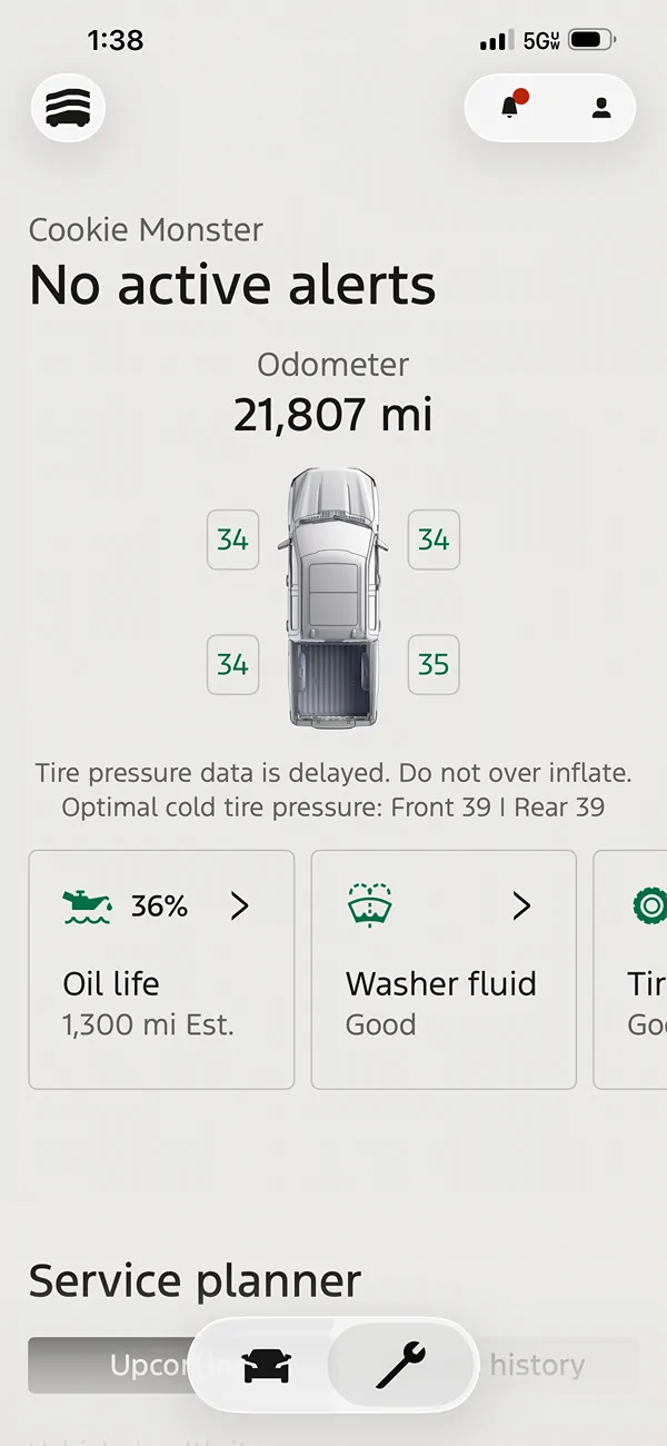

A little OCD for me, also. I bought an independent sensor package that attaches sensors to the valve stems. It tells me pressure and temperature so I can watch changes in real time. This little device backs up the weirdness I've experienced. I've checked the device against the internal sensor and they match (more or less, I have seen some very minor variation). I see this strange sensor phenomenon even when airing up with a 4-tire inflation system.

I think he's messing with you, 36, 37, 38, and 39? But I really wish he would have put 38 on the right front and 39 on the right rear. Come on Man!

I have the MoRRflate 4 way with just a Schrader valve on top not the gauge. I fill my tires with my compressor and check the pressure with a gauge at that schrader valve. It is usually within a pound of what the dash reads. But usually 1 tire is off until I Drive a bit. I just figure there is some slop in the sensor’s accuracy.
