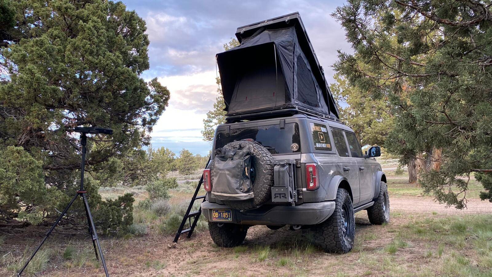

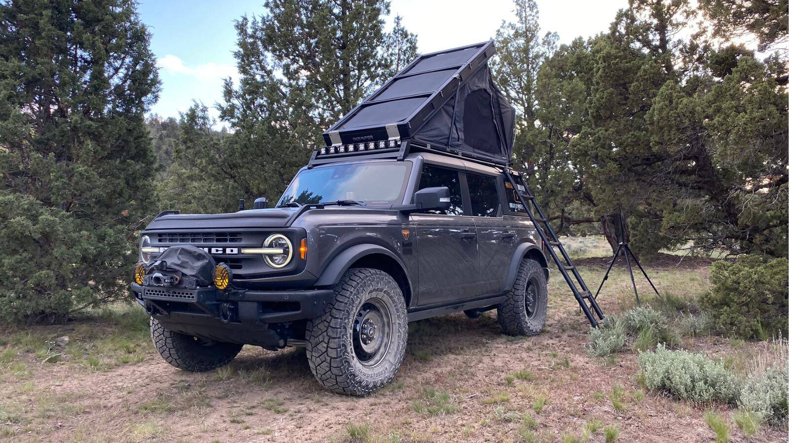

Attention suspension wizards,
I've already searched the forums, but want to get some current recommendations. 2021 Badlands Sasquatch. This is for the vehicle below so you can have some idea what we're dealing with. Goals:
  • Full 2" Lift (adjustable would be nice) leveling
  • 37" tires (want to get as much clearance as possible so I don't catch on fire....again
  • Smooth ride for miles of BLM roads
  • Daily driver as well
  • No rock crawling
  • Reasonably priced
  • Extra weight shown in photos
  • MAINLY CLEARENCE to not collect debris on the skid plates (avoid another fire)
Any ideas?

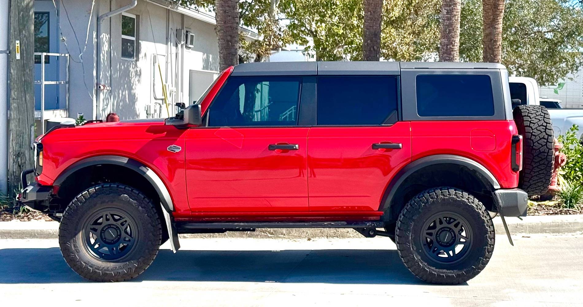

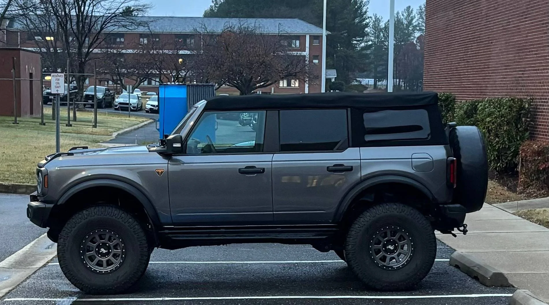

2023 Badlands Sas mod list:
*JKS Max Tire kit - this went on first
*Eibach coil springs- didn’t provide lift as advertised so I made the below modifications
Front- added Level kit shim spacers, one .25“ on top one .25” on bottom. Netted 2.5” total front suspension lift
Rear- added Broncbuster 1” collar to the Eibach coil. Netted 2” total rear suspension lift
*Custom 2.5” body lift. Added Broncbuster front & rear bumper relocation kits (their 3”)
*Vision rims with +12 offset
* Patagonia XT 13.5X38 tires no rub
*Stage 1 74 Weld steering upgrade with Icon tie rides
* Rockjock tract bar relocate bracket
drives great!

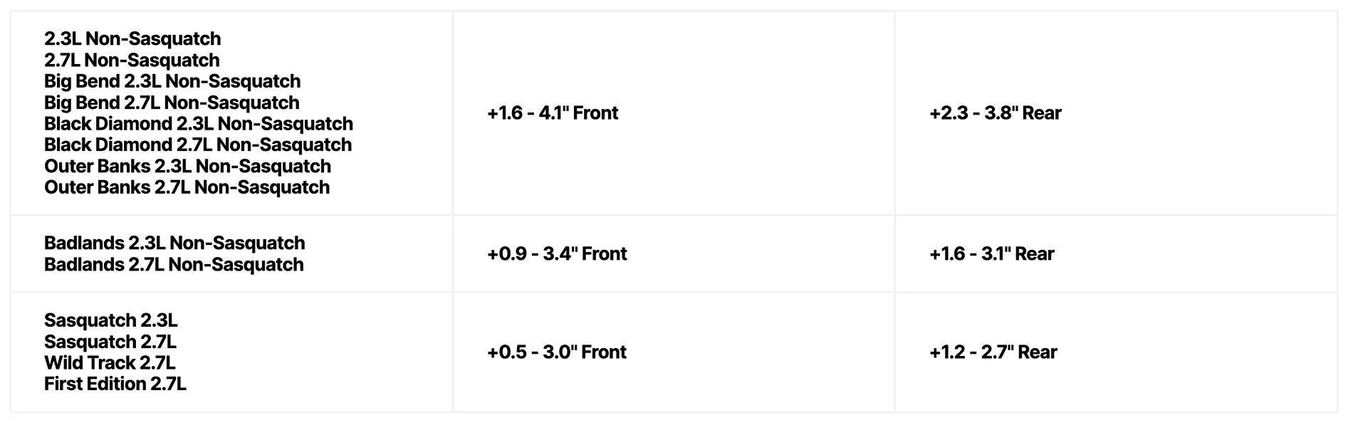

@panda motorworks, are these adjustable. I want to raise my BD about 1" not the full 2 inches.
artart88
Art
Feb 26, 2020
59
Santee CA
2023 Black Diamond
Am I reading this correctly, the minimum lift for the BD is 1.6 front and 2.3" rear?
That is correct as they based this kit to have a base height of slightly over the SAS suspension as you can see above. Overall with leveling its about the min you need to properly do so and allow fine tuning!
I think you would be very happy with this setup!
