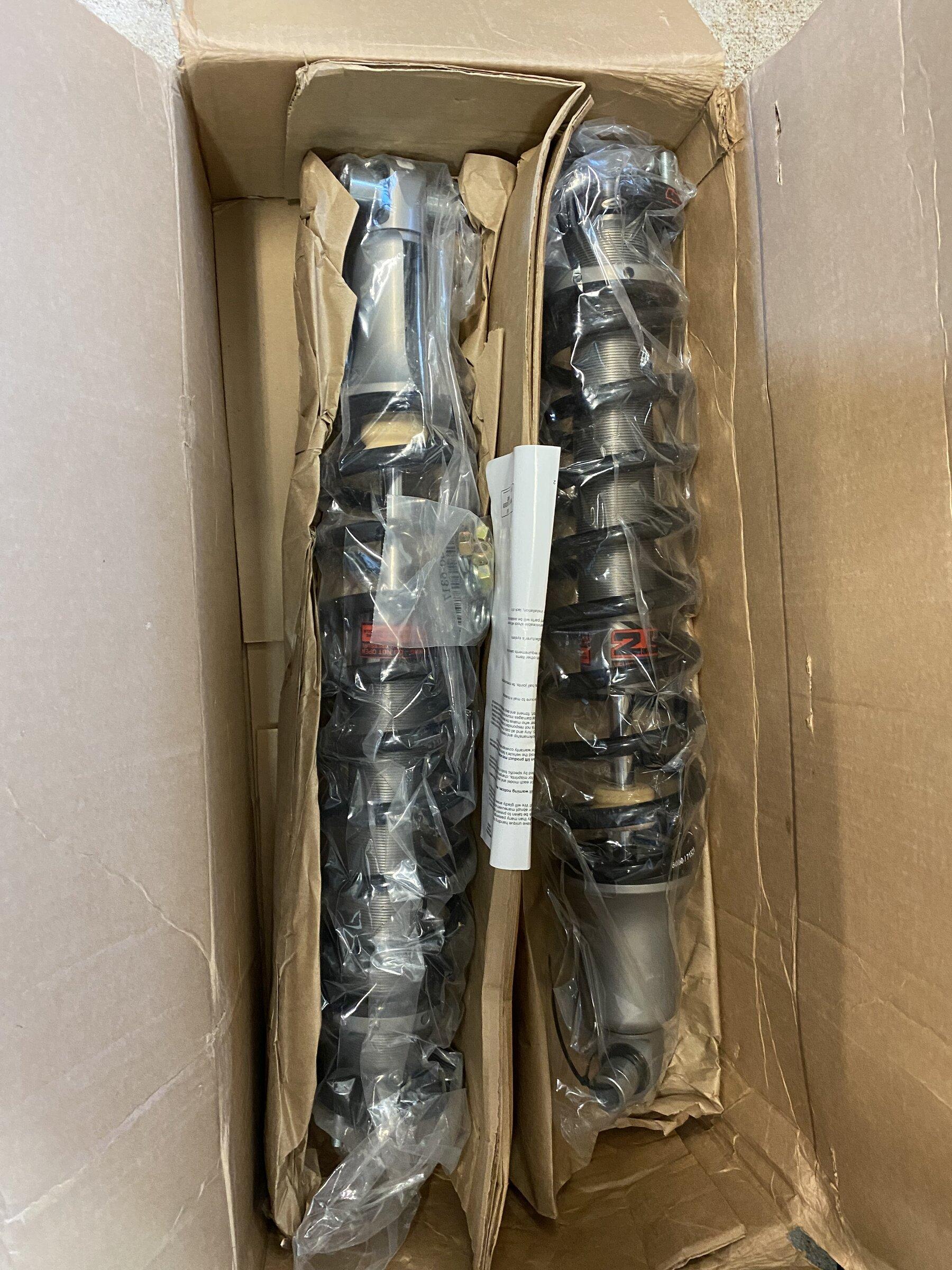

These came in last week. Ordered Wednesday, delivered Friday.
These are the 4WP Coil-Overs. Paired with the Adjustable Rear Track Bar, Camburg UCAs and Rear Lower Links the suspension should be pretty solid.
The Fox Coil-Overs I have on order are still a couple months out, so I am told. They will go on another Bronco I have on order.
Looking into getting these coilovers to add 35's. Are the aftermarket UCA's a requirement?

My understanding is for the new Bronco that any lift over 2" an Upper Control Arm is recommended.
Then an alignment after the install.
These Coil-Overs out of the box are set at a 3" Lift. You won't need that much lift to clear the 35s.
I would install the Coil-Overs, mount your tires, then adjust the Coil-Over height as you like. You may be able to get a good alignment with the stock UCAs with about 2" of lift???

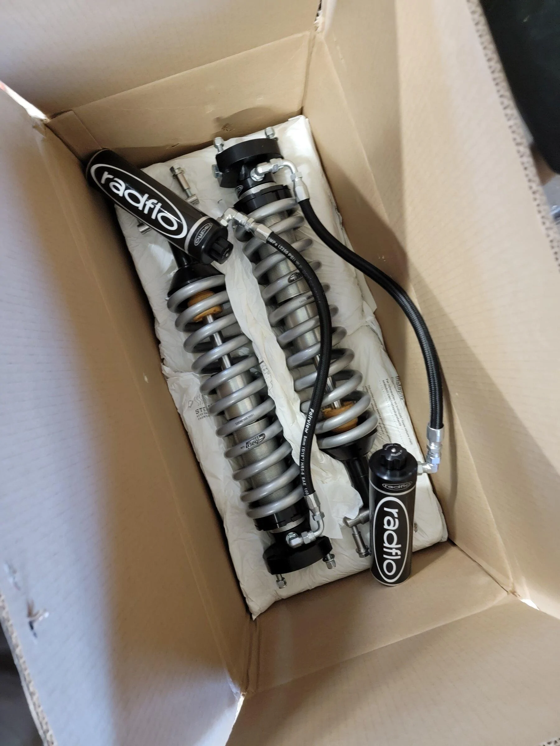

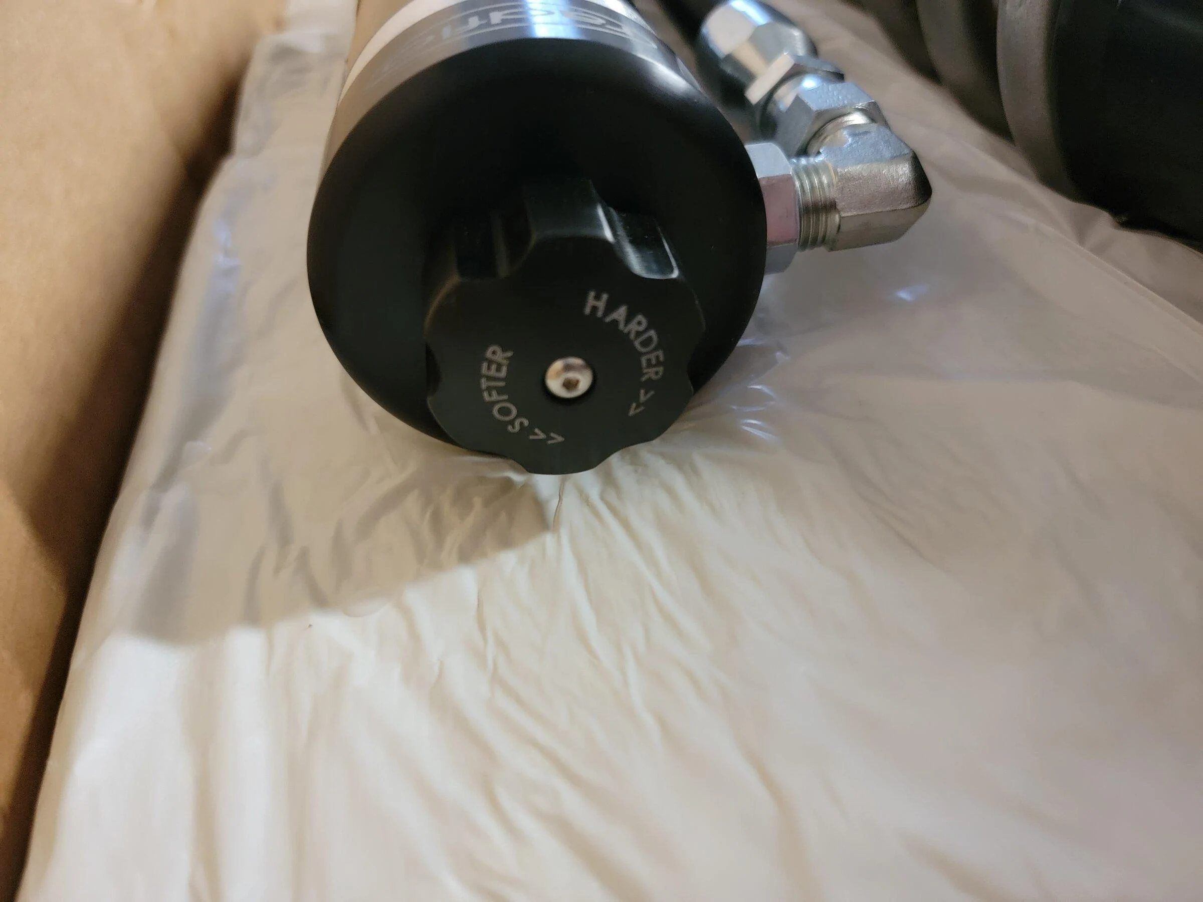

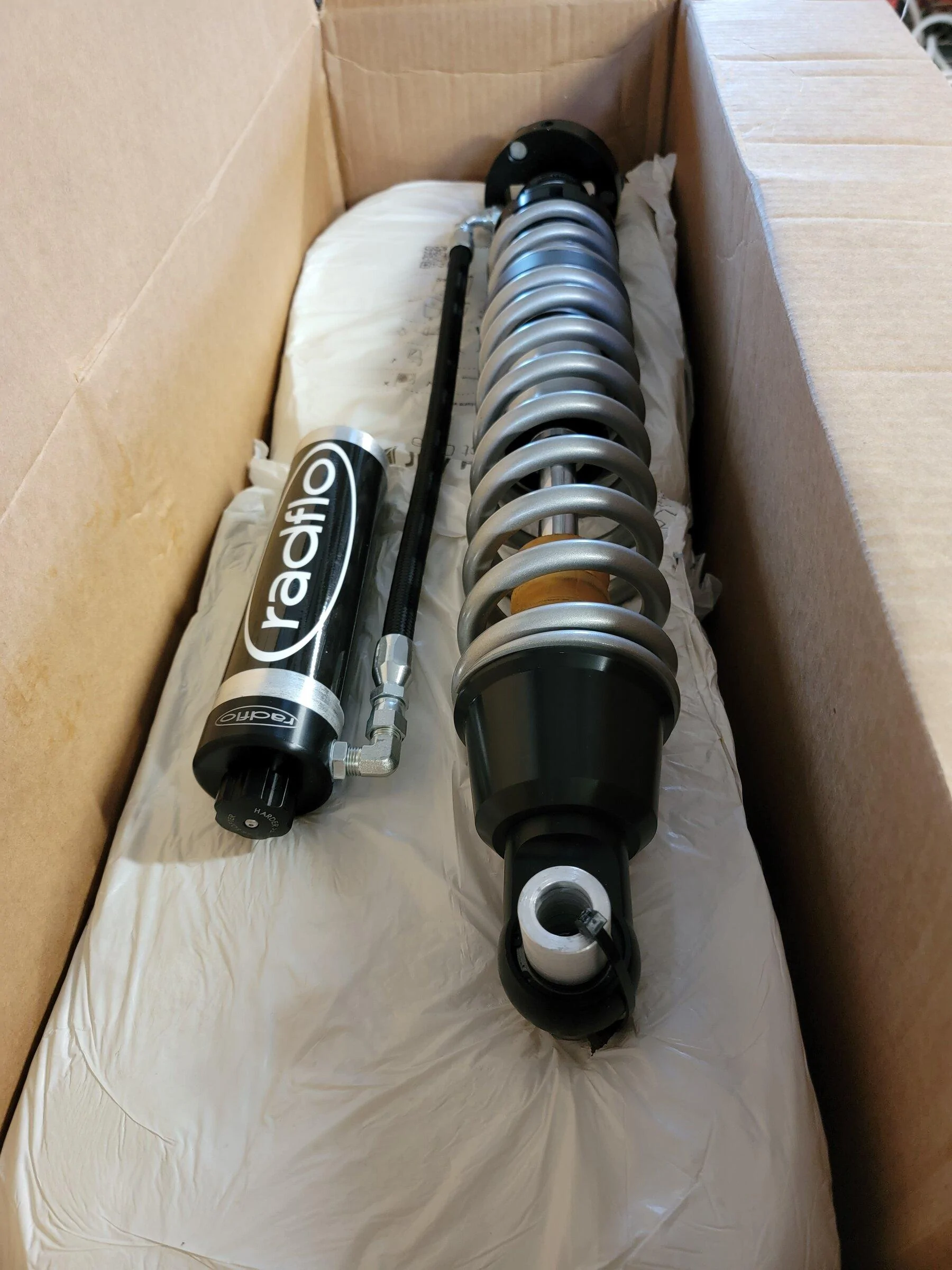

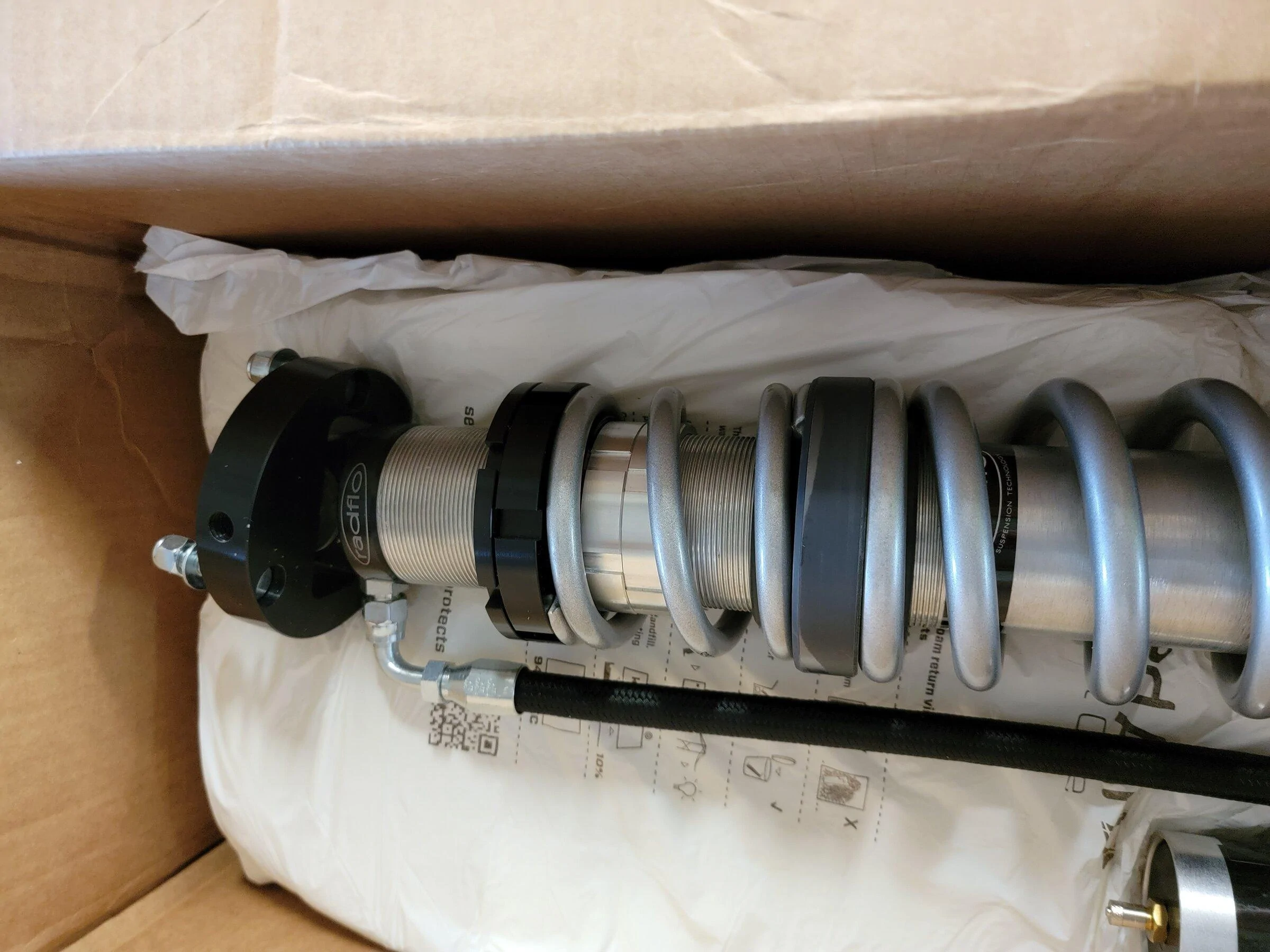

Radflos are readily available. Just got mine, now gotta figure out the ucas and track bar.
Ford Bronco Current Coiliver Lift Options? 20220328_165117
Ford Bronco Current Coiliver Lift Options? 20220328_165121
Ford Bronco Current Coiliver Lift Options? 20220328_165125
Ford Bronco Current Coiliver Lift Options? 20220328_165237
Ford Bronco Current Coiliver Lift Options? 20220328_165344
