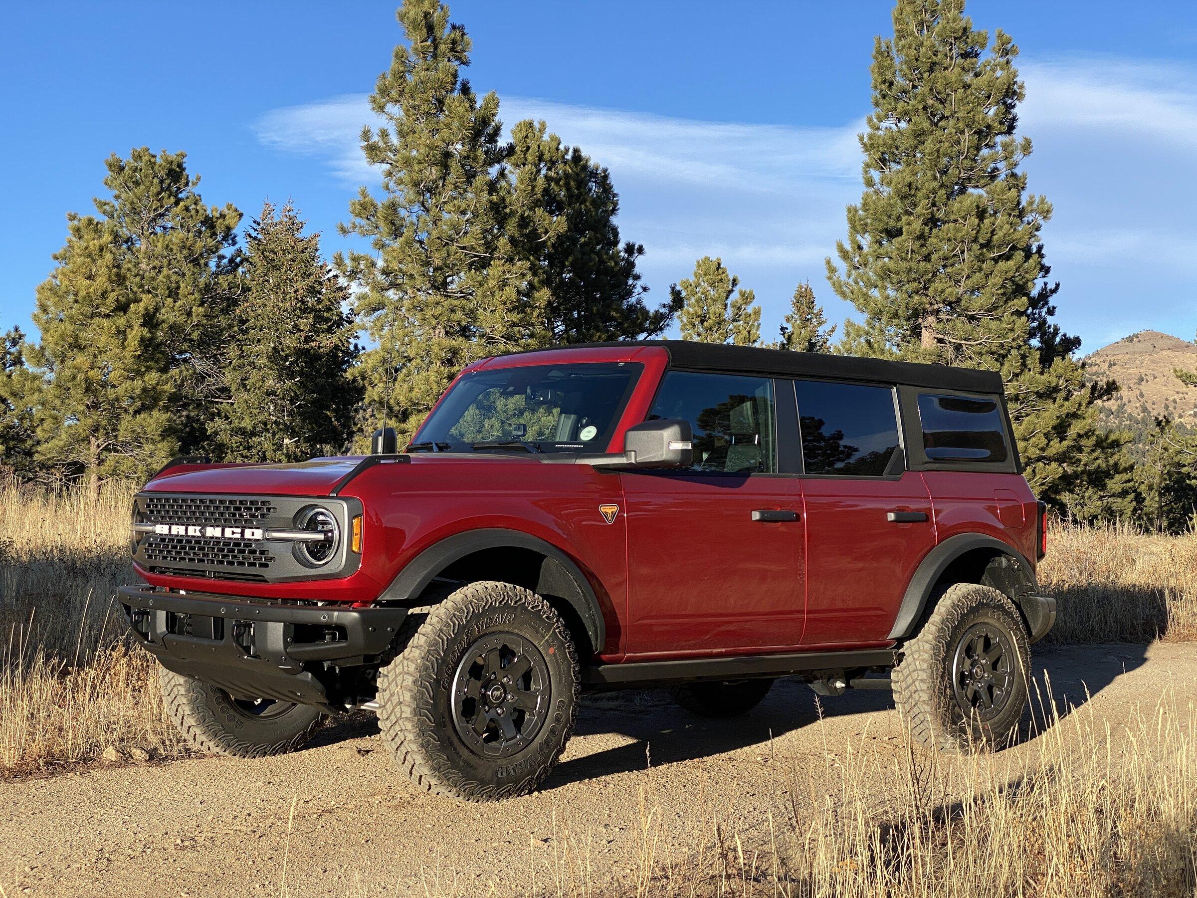

I was torn, wanted a manual because it’s more fun/interactive to drive. At first I felt that I was forced to “settle” for puny 33’s. The lockers and SBD on the badlands make it wonderfully adequate for what I’m looking to do in the first few years of its life. Happy with the look, and may add leveling kit to bring the front up an inch…eventually.

Ford Bronco Badlands non squatch lift options 627CB69B-CF2A-41FE-BB4A-FED91BA4757E
