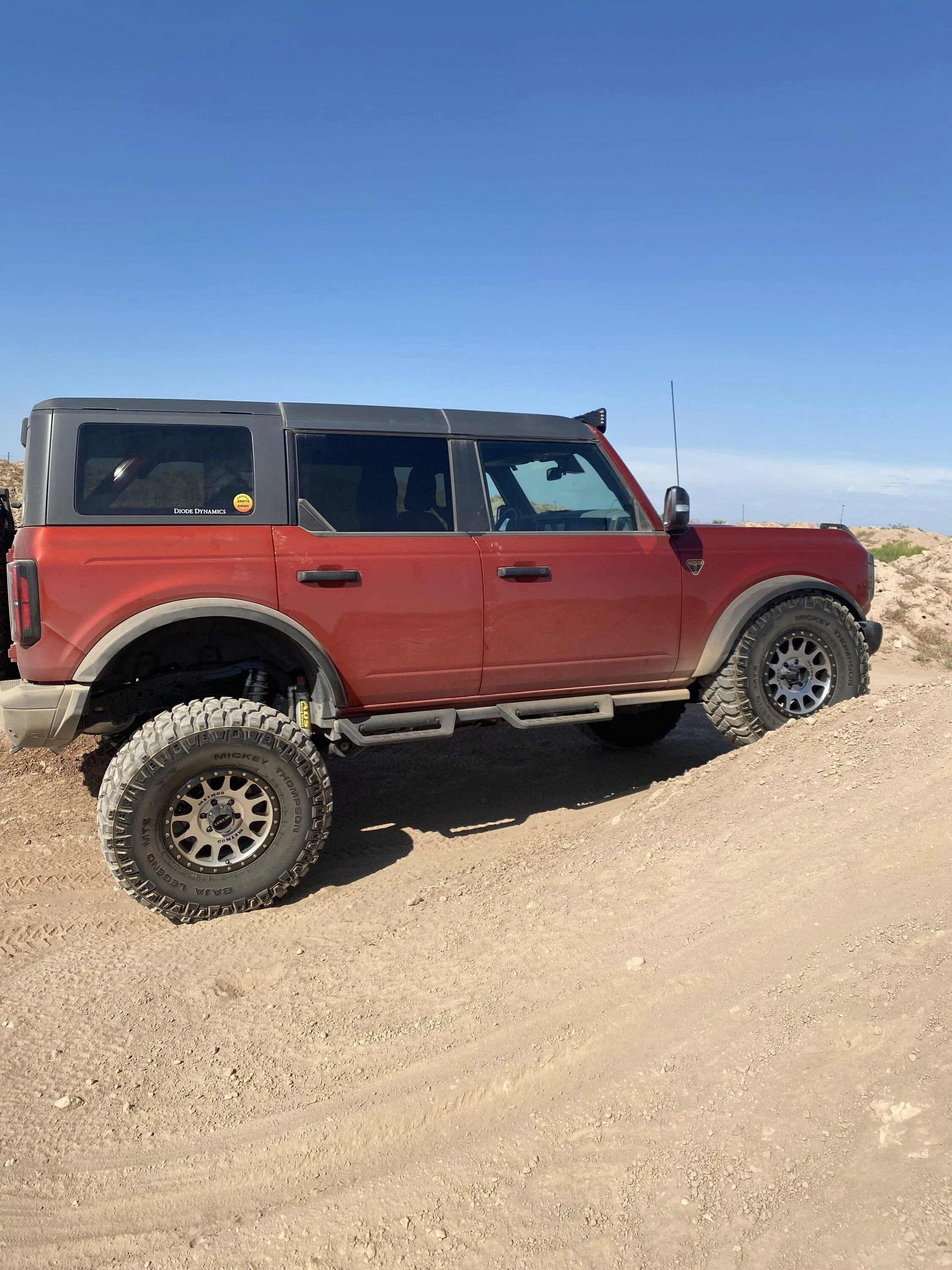

The proof is in the pudding. Here is our Badlands with ADS kit and 37s.
Ford Bronco 2023 Badlands Non-Squatch lift options IMG_5389
