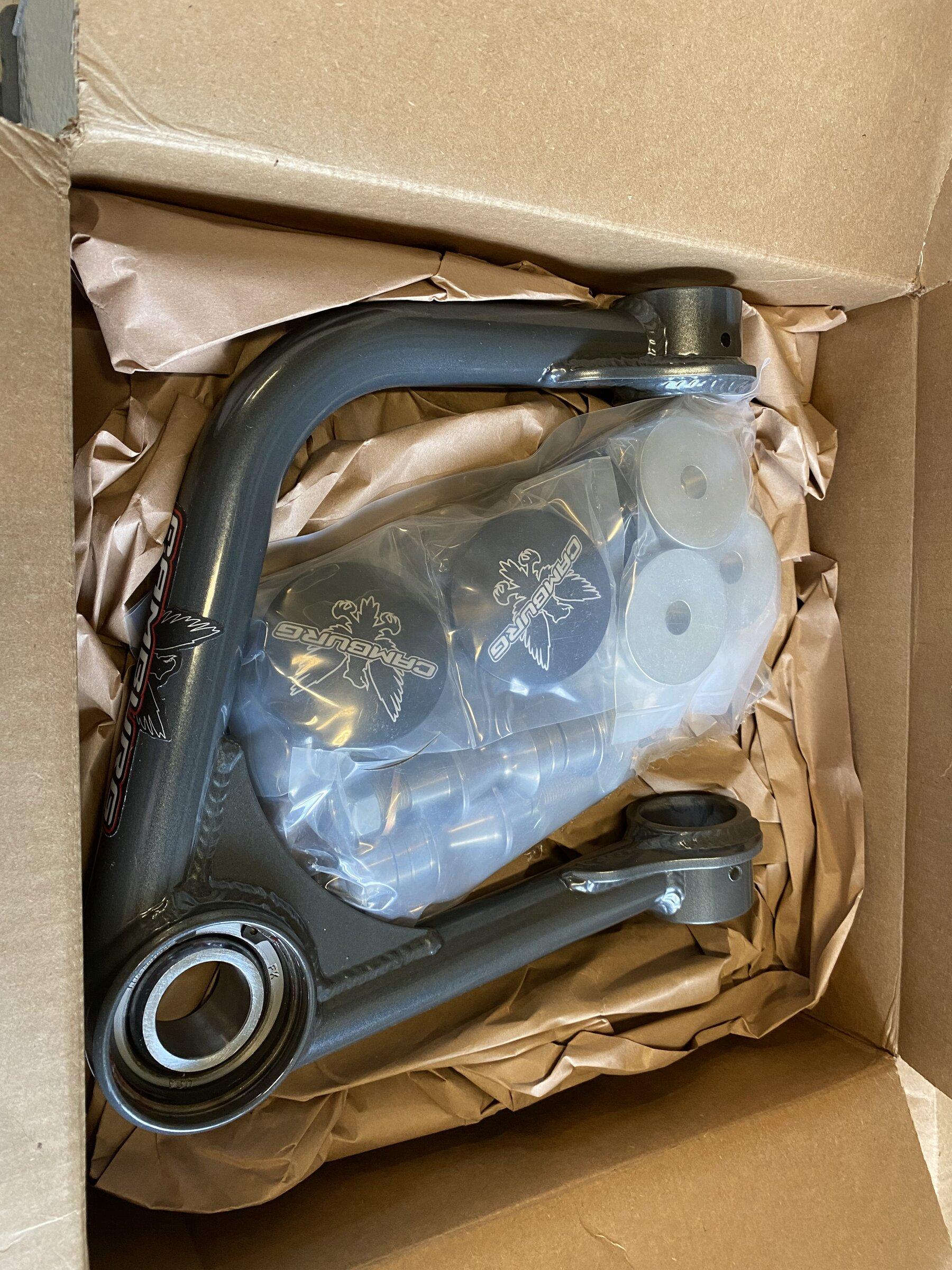

Camburg had the Tubular Upper Control Arms in stock last week. Mine get delivered Tuesday.

I just got these in Today. Ordered from Camburg early last week. Same Uni-Ball as the Billet version without the price.
