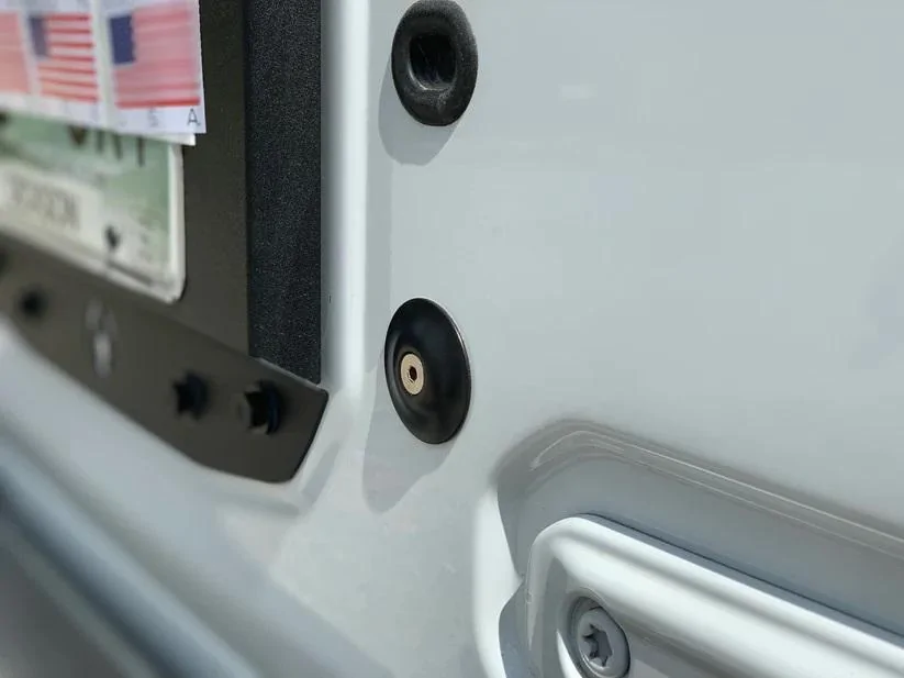

Did those small hole plugs come with the kit? I don't like how most kits don't address the tire bumpers. CMM Offroad makes cool aluminum hole covers for Jeeps and I reached out to them about the Bronco yesterday. Pretty sure they hadn't considered it until I asked the question but don't see why they wouldn't work with different hardware.
My second thought is using bumperplugs.com. They make make paint matched plugs and looks like they have race red as an option.
Yep! The plugs came with the kit.

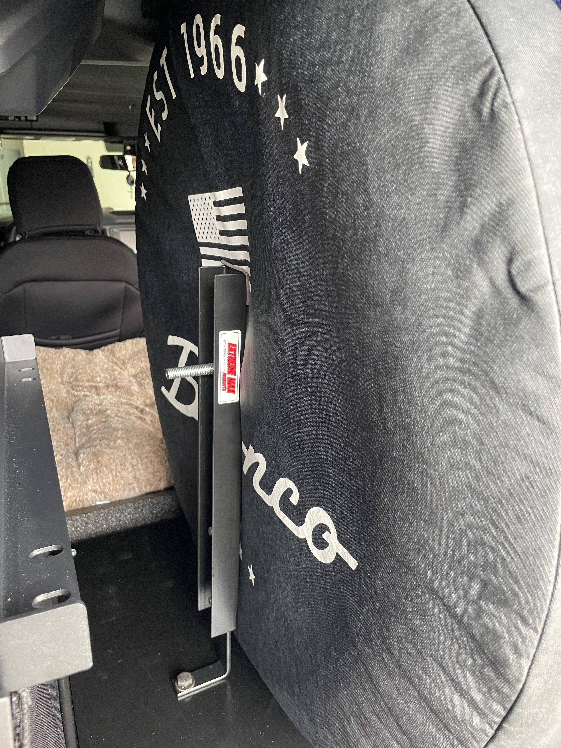

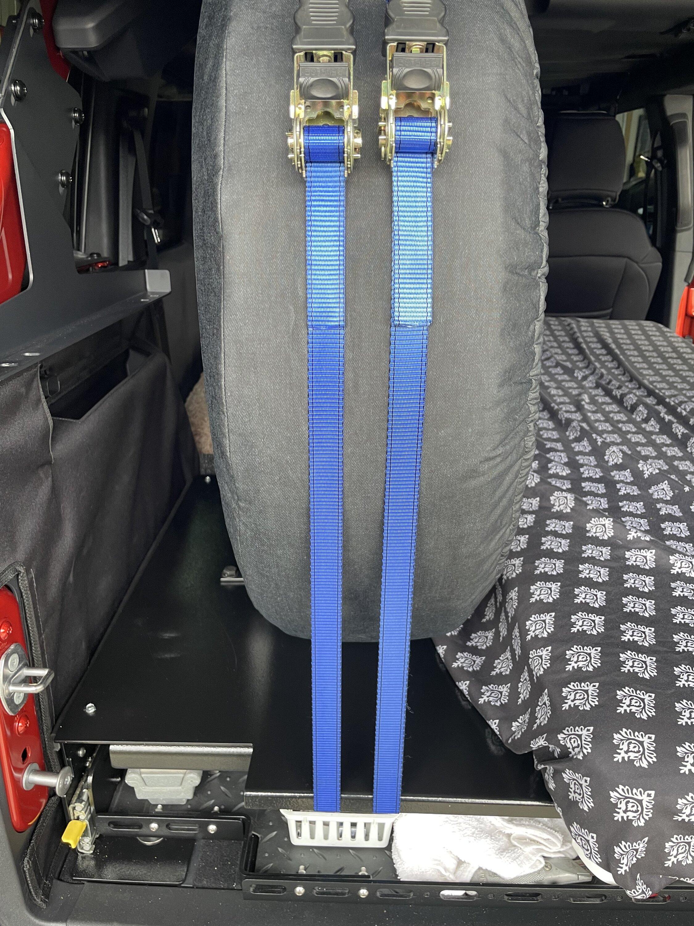

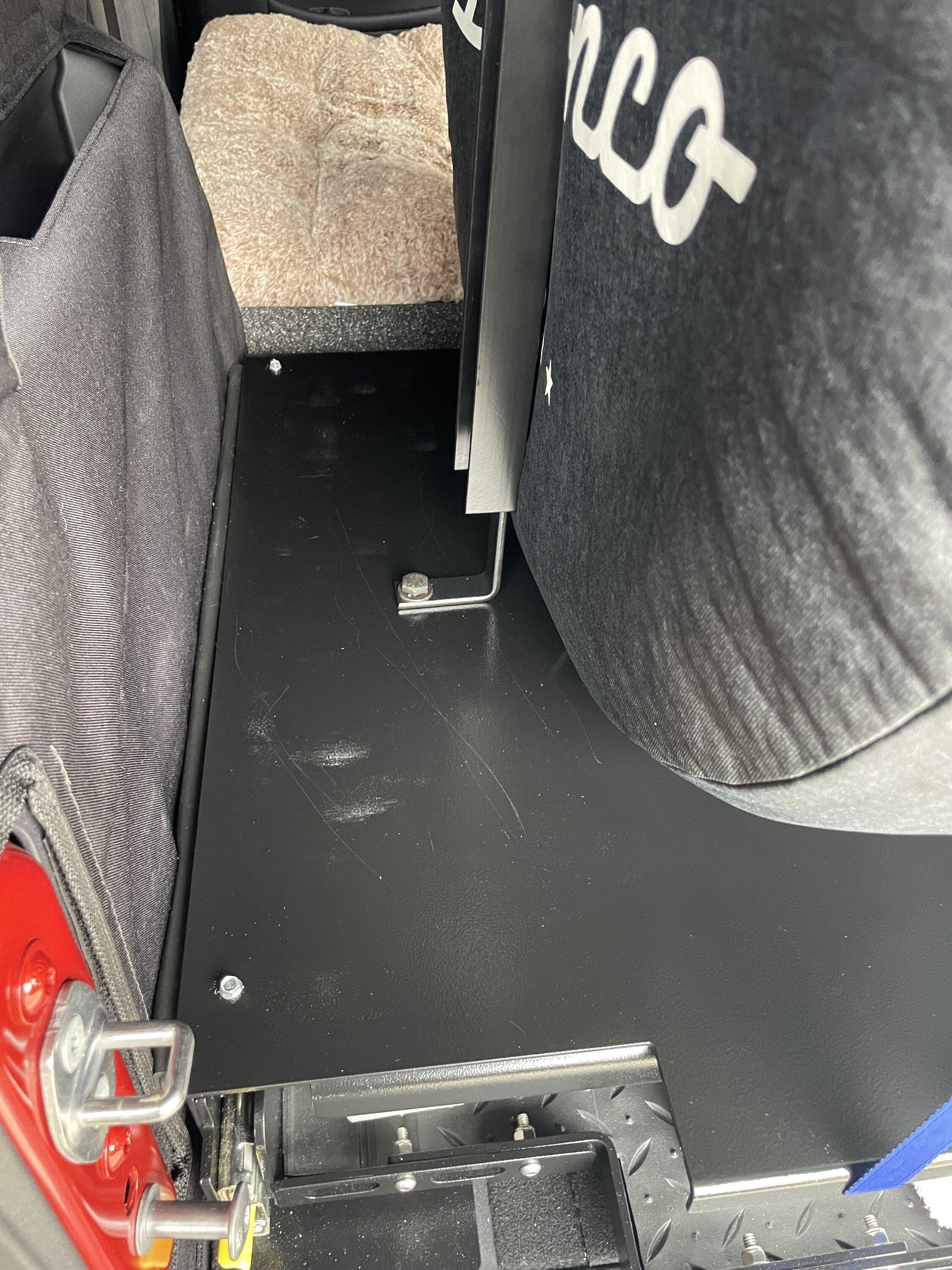

and this is how I carry the spare when I need it on longer trips: strapped-down on a Wicked Relics Packhorse with rear seat delete:

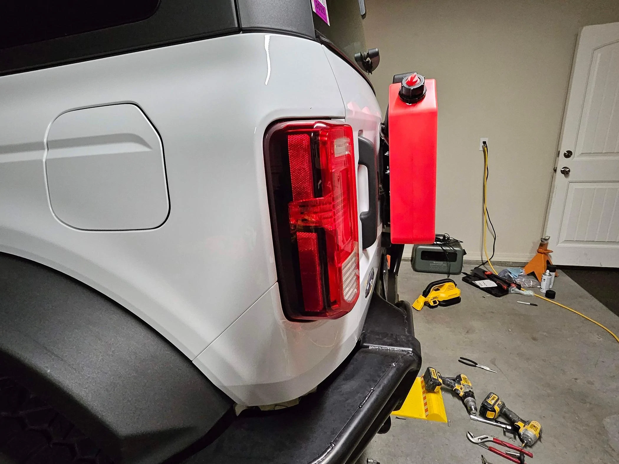

Went with the fab 4 but the 1 gallon cans were not big enough for me... so I modified the mounts (angled) so I could mount 2 ea. three gallon cans.

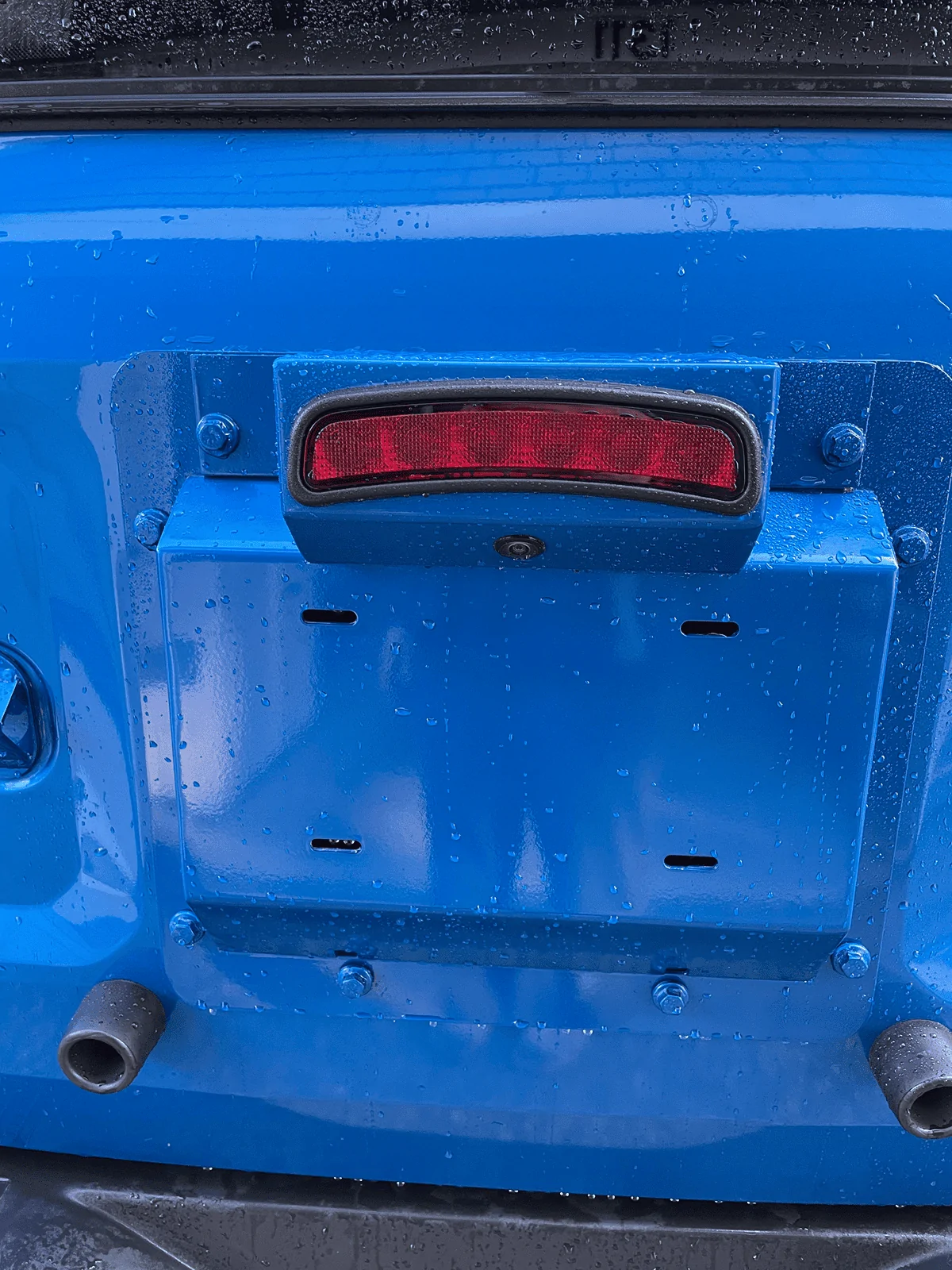

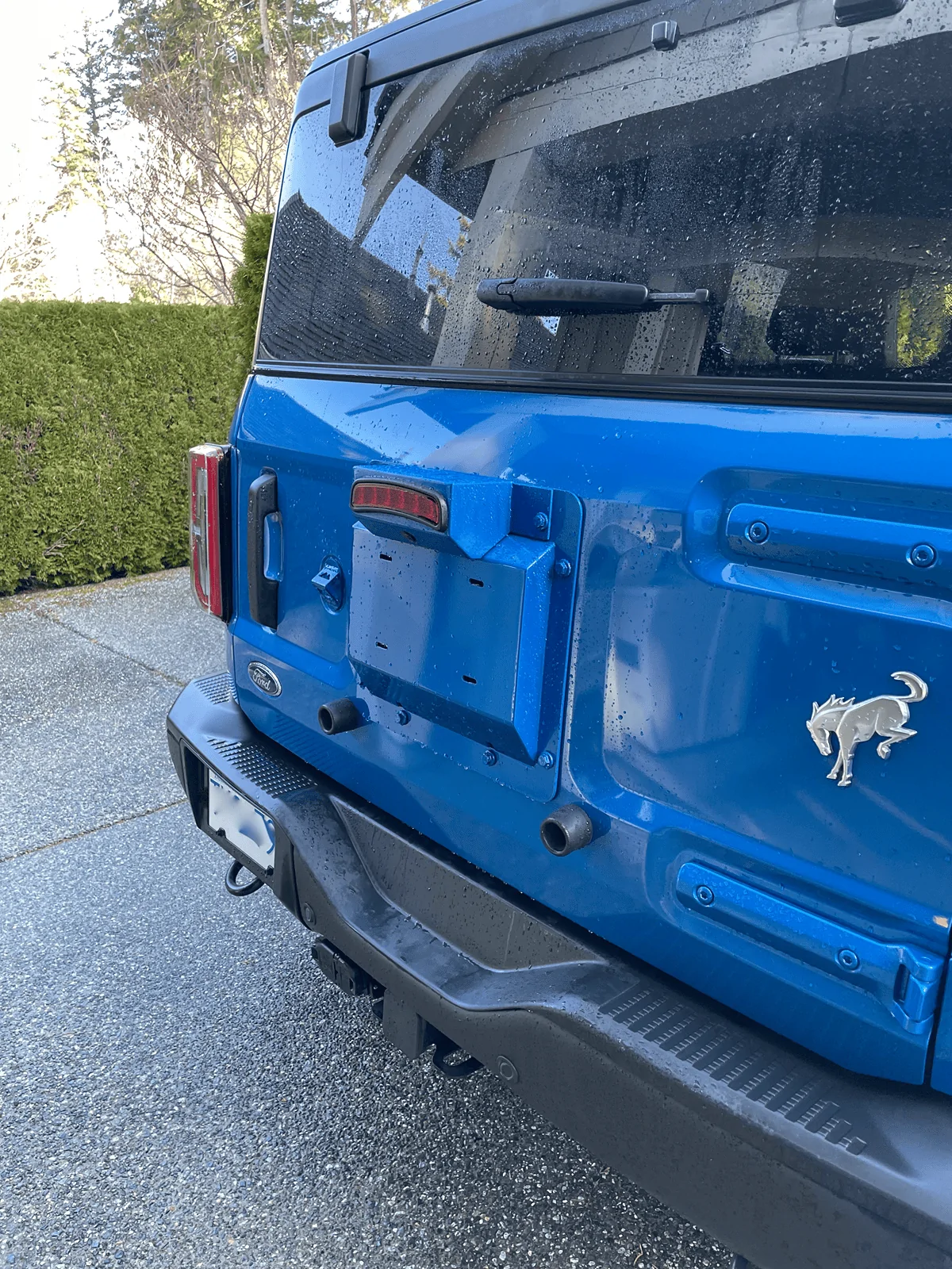

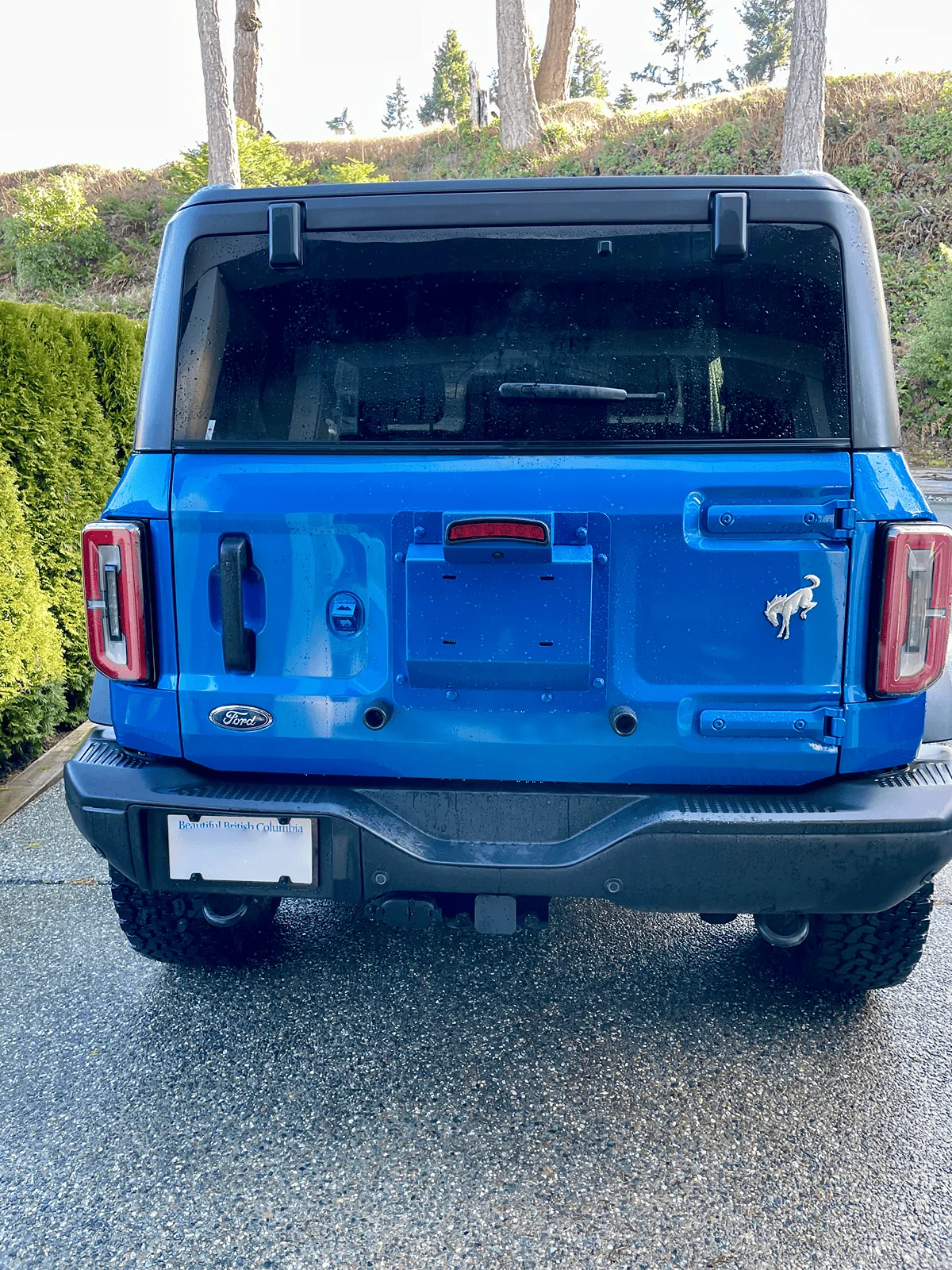

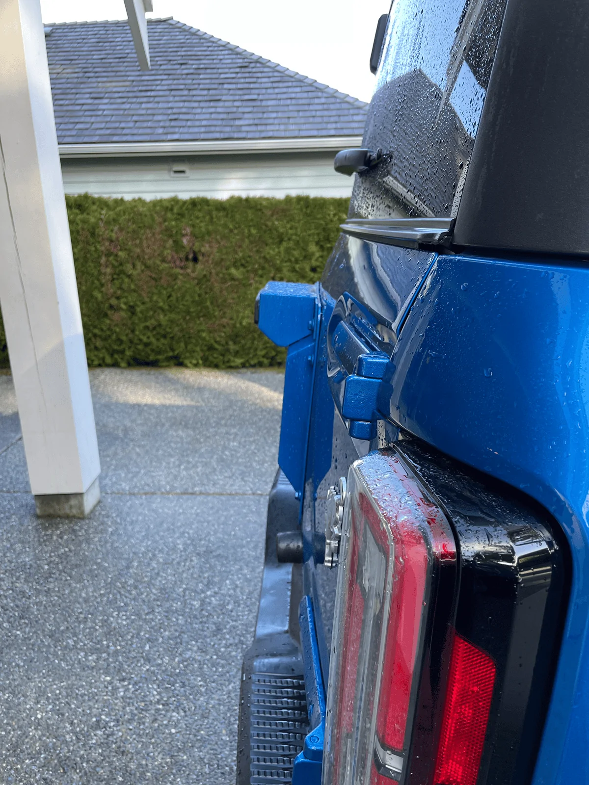

I am ready to report in. The installation was not straight forward in the sense that I was also juggling two other Mods - the JCR tailgate table along with the AAL tailgate compressor. Needless to say there is an order that everything must be done.
The most difficult part was the frustration of receiving incomplete deliveries from both SRQ and especially AAL. Most of the installation time was figuring out why nothing fit, then realizing I was missing items, and then waiting for subsequent deliveries. I was even missing the SRQ instructions. Fortunately, the one YouTube out there was very helpful. Unlike that fellow, I had no issues with the tailgate aligning and closing properly after installation.
We decided to match the SRQ delete with the body paint colour. SRQ did a great job with this custom request. We are pleased with the matching colour and happy we did it. Admittedly the colour match is slightly off but that is more the change in my truck’s colour. Another good wash and wax should take care of that. As a bonus, the colour matching was actually my wife’s idea - she is now more engaged with the Bronco journey with “skin in the game.”

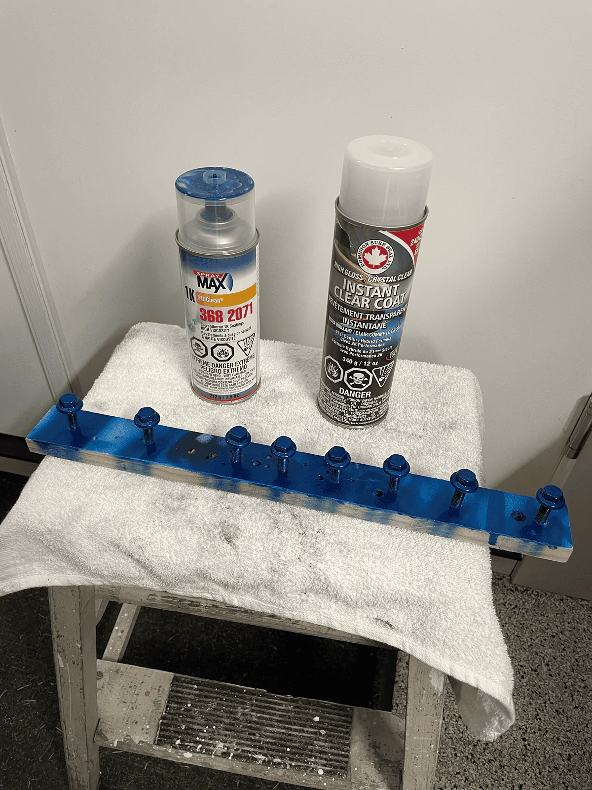

In order to match the 8 black (stock) mounting bolts, I went to the local auto shop and the kind lady colour matched a spray can for me off the Ford colour code. Two coats and then two coats of clear. The paint was strong enough to withstand the socket as I re-installed.
The spare tire bumpers do not bother me. In fact, I like them. If I ever change my mind I would figure out some kind of plug.
The slots for the license plate obviously appear black. I will not put my license in that spot. I’m not sure what I will do with that section, if anything.
Water - I live on the “Wet Coast”. SRQ sends some adhesive foam tape to help with the metal on metal attachments. This tape is a good idea (and necessary) but it creates a slight gap. The water will run straight through on the main body including straight through some built in drains. For the bottle opener I chose to apply some silicone caulking to mitigate the potential water intrusion. I also applied the silicone around the 3rd brake light as that is not a perfect fit.
Most of our driving is local so a spare tire is not a concern. I love the fact I do not have a big tire in the way of everything. Another bonus is that my traditional bike rack fits. A spare will be thrown in the back when venturing further away and off-road.
Hope this helps.

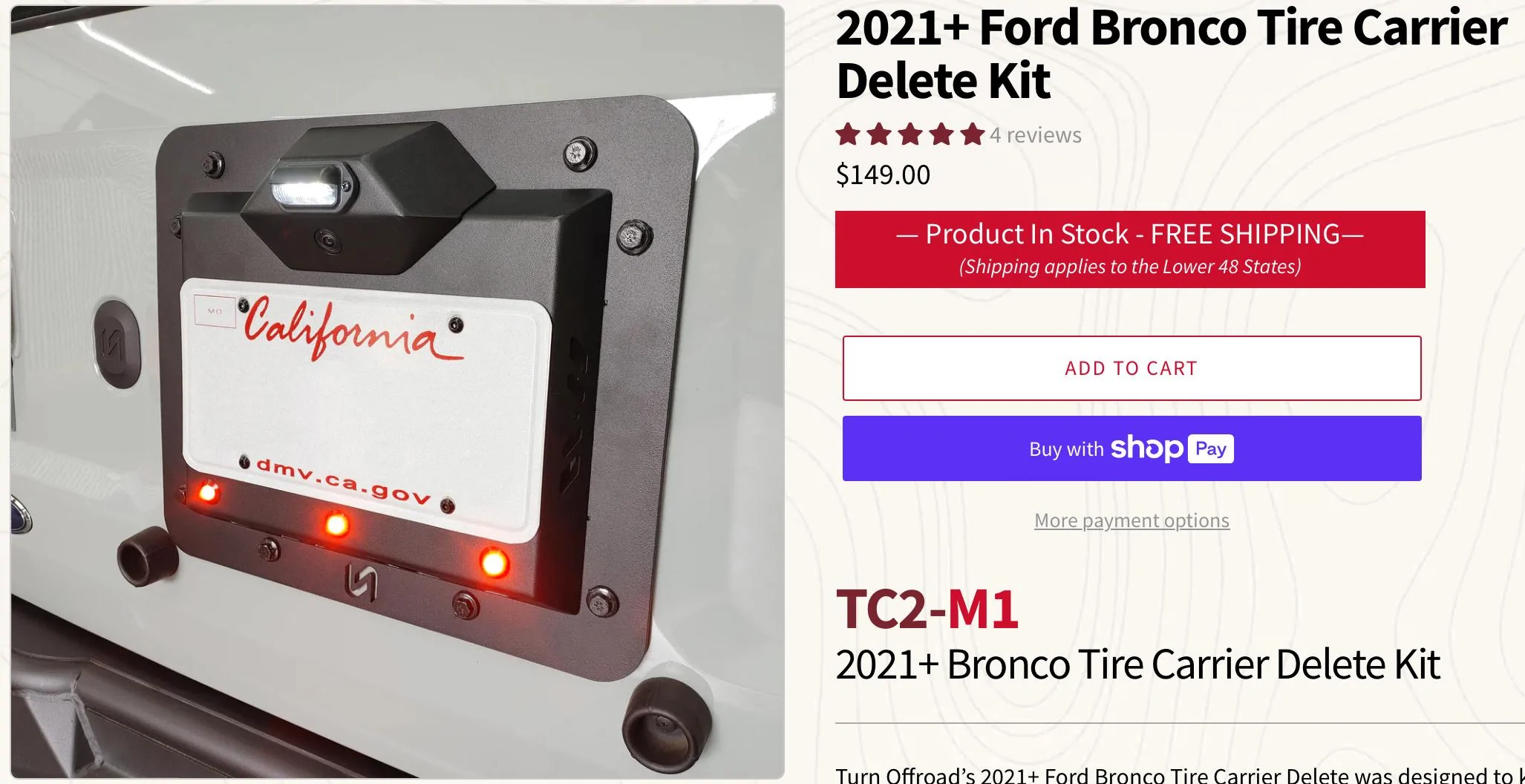

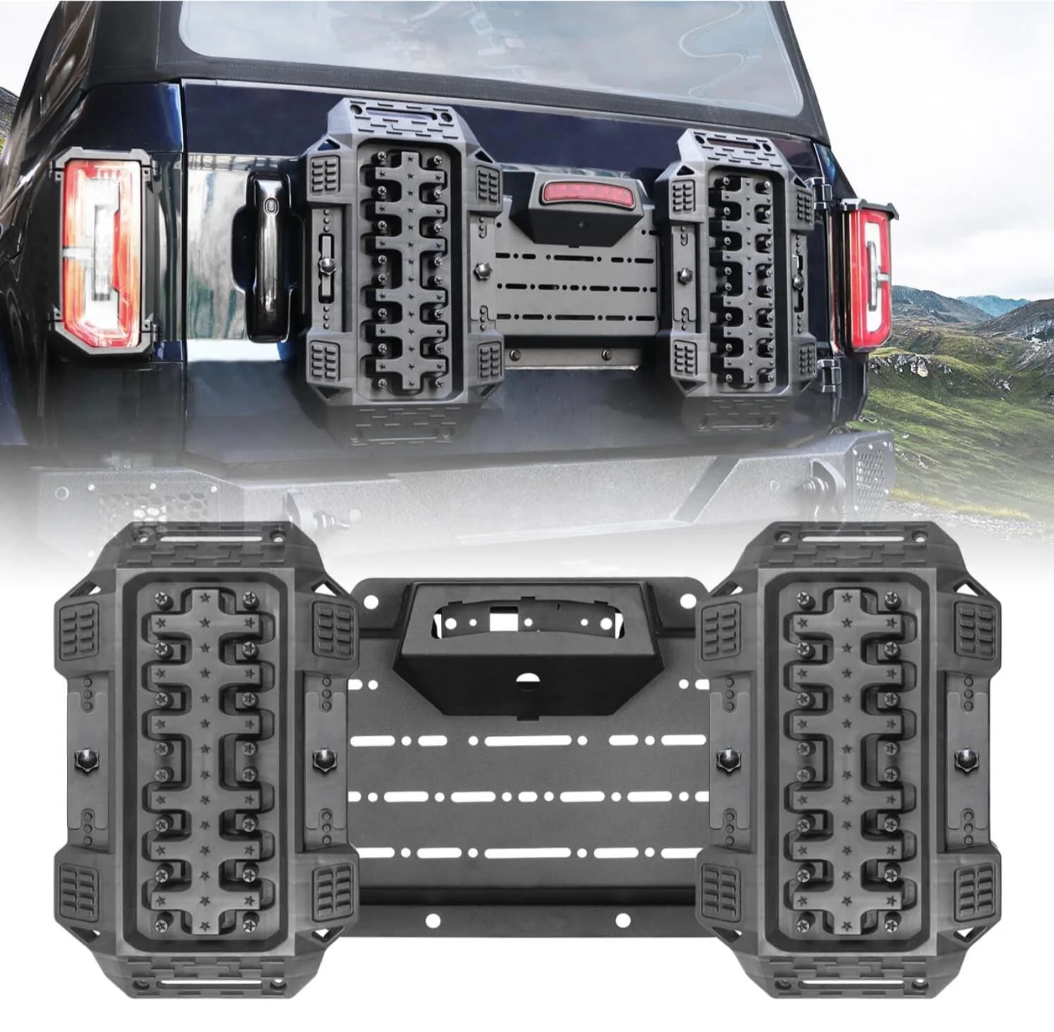

I have not seen anyone using this spare delete mount yet. I've ordered one and I should receive it in about a week.
At some time, I'm planning to remove the traction boards and mount 2, 2 gal. gas rotopax units. My Badlands is a 2 door and it's nice to have the extra fuel. It's also nice to have additional mounting options. I currently have a 5 gallon metal jerry can in a RTR mount connected to a Hammer Built tailgate reinforcement plate with the stock 35" spare. All this is pretty heavy on the back. I also get a few rattles when the jerry can is full. I hope I can keep the Hammer Built reinforcement plate with this setup and also eliminate the rattling too.
In regards to the license plate, I do not plan on moving it up to the mount. I also do not see a light for the plate area and I don't want any issues. I will put a black molle pouch in place of it for tire gauges, gloves and other misc small items.
When I go on long trips or off road, I will strap the spare onto my Wicked Relics slide out tray. I will keep a tire repair kit and small air compressor incase of a minor tire issue. My last two vehicles did not have spares, so I am not too worried when I don't have one and I do have road side service.
I will post pics after I receive the tire delete mount and install it. I will also report on the installation, metal gauge thickness, powder coating, and overall quality of it.

Good job. I haven't seen that particular delete kit before.
I am just looking at the Wicked Relics slide out tray now. I'd be curious what your plan is for strapping down the spare.
Looking forward to photos after your install!

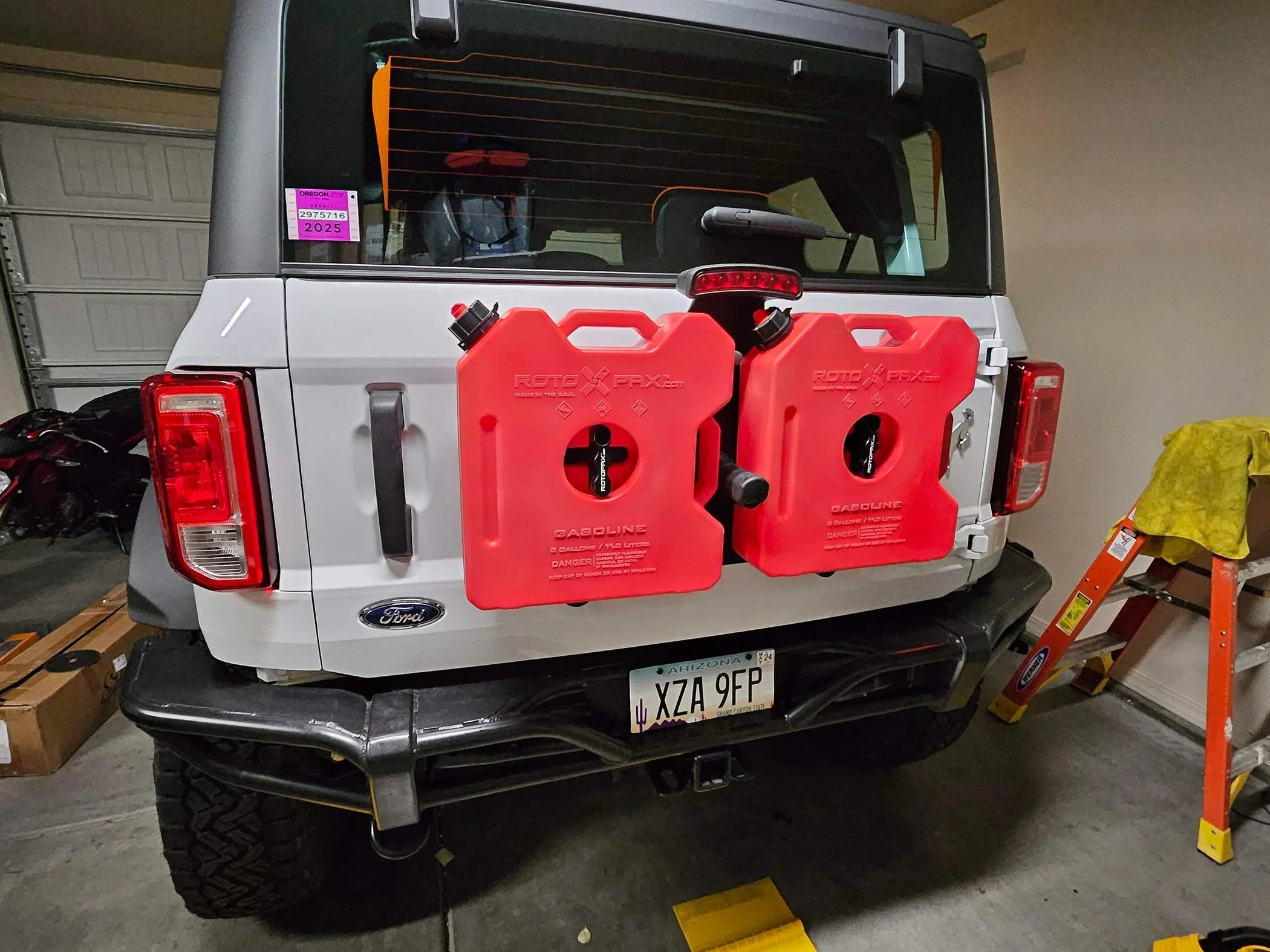

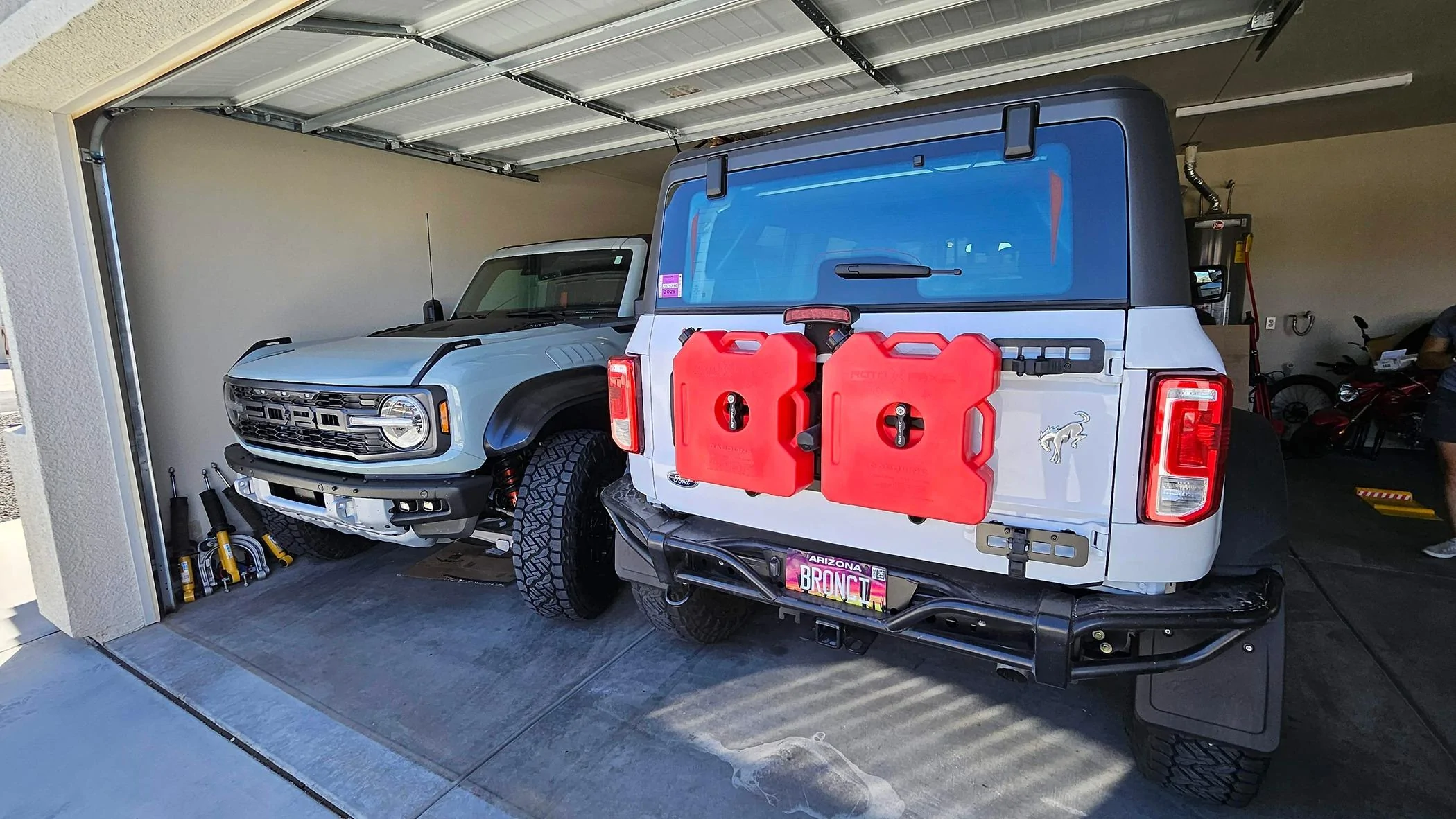

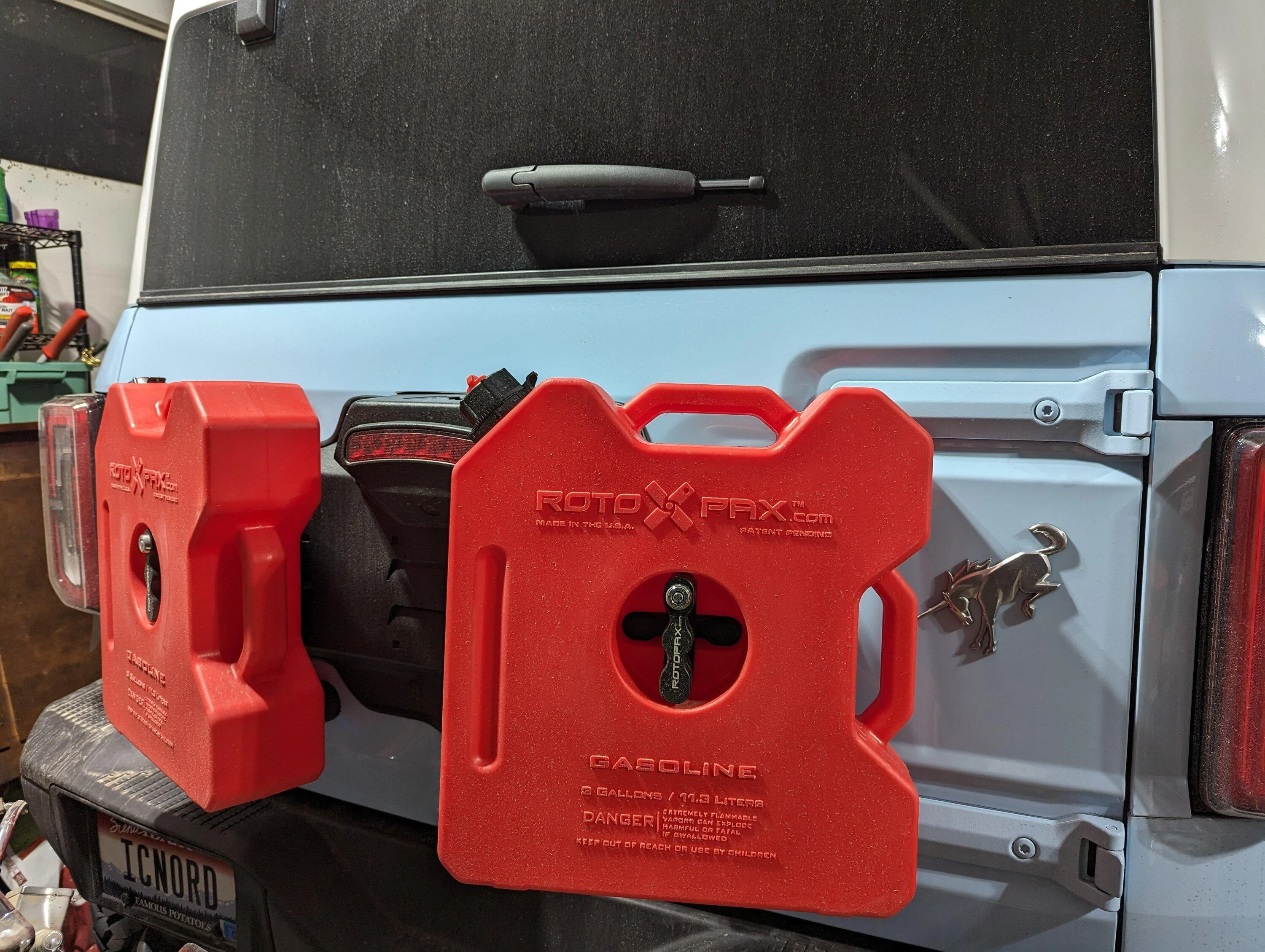

Don't know why a good delete with fuel cans isn't available!!!
JCR Plate - Cut up the factory tire carrier. Used the camera snorkel to get the best view. Modified the factory light and attached to the plate. Factory wiring harness.
TWO 3 Gallon Rotopax! Anything smaller isn't worth the cost/effort.
Hing mount is a cut up molly plate with quick fist extensions. It holds a standard (useful size) digging shovel. Gate will fully open and clear the light. Shovel is upside down and only slightly visible from rear view. Rather good solution. Folding shovels suck for rear digging.

To secure the spare, I plan to use a SpeedStrap 2" 3-point tie down with swivel hooks. The swivel hooks will be anchored through the tray. I know the 2" strap is a bit overkill and I can use 1.5", but I like to over build when it comes to safety inside the bronco.

Nice, you made your own setup. Thank you for sharing. I am happy to find a delete plate that may work for me.
I would like to use the 3 gallon rotopax as you suggest, but I already have the 2 gallon fuel and a 2 gallon water ones. I will be mounting 4, 2 gallon rotopax. I'll be able to pack 6 gallons of fuel and 2 gallons of water with this setup or 8 gallons of fuel. I do like the 3 gallon ones you have much better.
