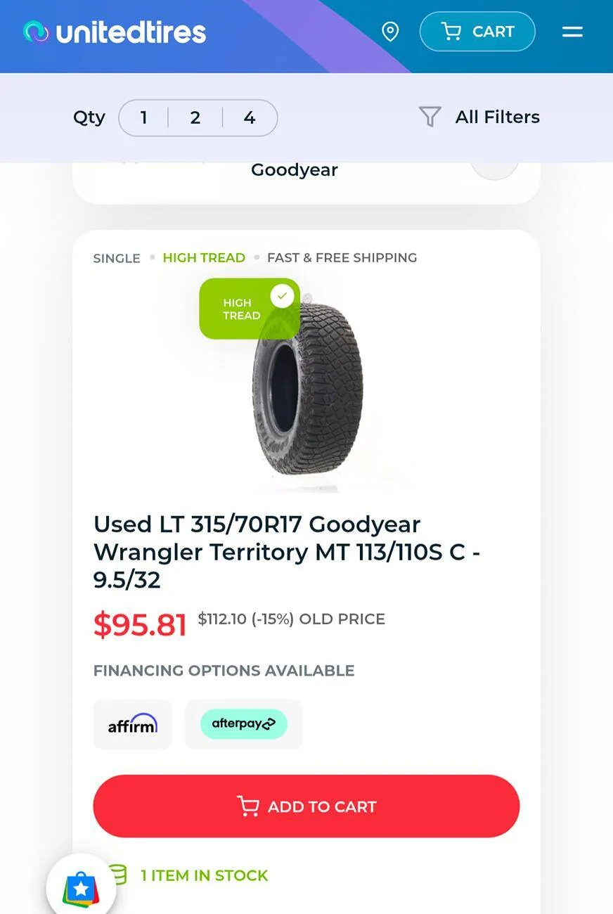

I've mixed in new with as low as 75% and been fine, but I think you're pushing it at 50%. But this isn't some super advanced AWD either and isn't that sensitive.
For anyone dealing with this in the future, take a look at United Tires. For pretty cheap you can get a tire with some wear on it already and mix it right in.

Something Wild
Something Wild
Jul 22, 2020
114
254
KC, MO
2023 Badlands
Appreciate the input. Good to know about United Tires also.

Berkeley, CA
2023 Badlands, 2013 Toyota Highlander, 2000 Miata
Thanks for the United Tire validation. I tore a sidewall this weekend. Had to cut the trip short as a result. Found United Tires on eBay and bought a KO2 with similar tread wear for $70. Hope it works! It’s E rated but the other 4 are C rated. But shouldn’t matter as a spare with similar tread wear. I’m down to 5-6/32 (depending on tire and where I measure). I need to limp along and move to 35” tires soon along with new suspension. Heh.
