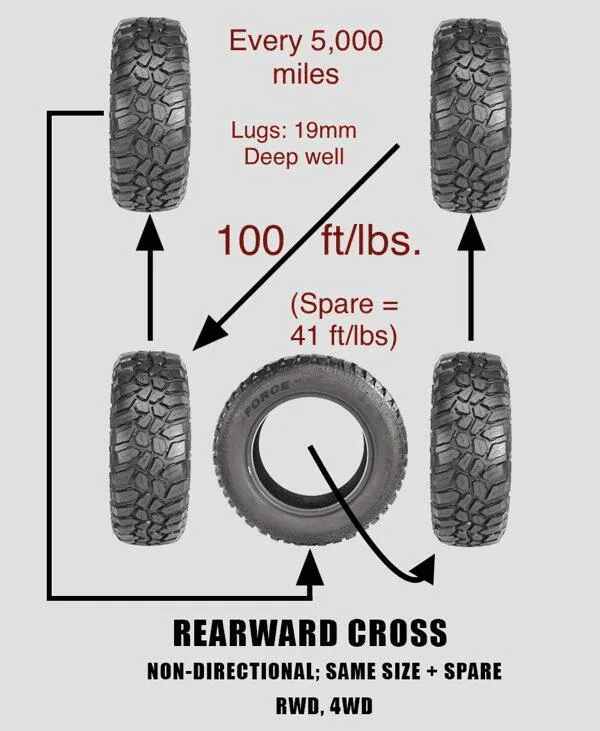

Hey I’m due for a tire rotation my guy at the shop said we just rotate the 4 tires but I have seen a lot of threads of people talking about the 5th wheels going into action and to me that dosent make much sense cause that’s a brand new tire and the rest have been used so If we throw it into action won’t that be a bumpy ride? Let me know what yall do and inform me

I rotate all 5 of mine every 5k miles. Gets you extra life out of the set because you are running 5 tires instead of 4

If the place that rotates your tires only does 4-tire rotations, you can always swap the spare with the right rear tire, which is the same as what would happen with a proper 5-tire rotation.
Besides, if you do that you'll now know how to deal with a flat tire if it ever happens. When my Bronco was still fairly new I at least got the jack out and figured out how to get a front tire and a rear tire off of the ground, so now I know where the jack goes and how it works. But my dealer does a 5-tire rotation for me, so I haven't had to bother with the extra step.
