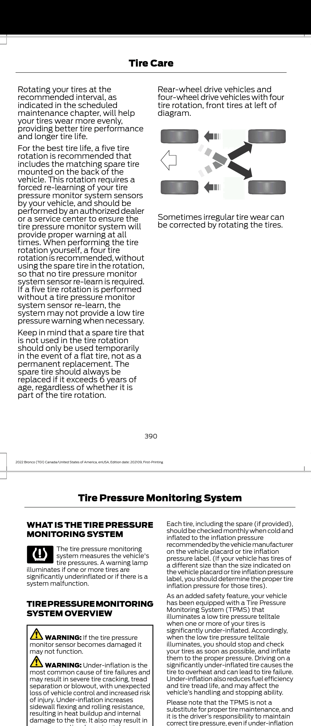

A page from the owners manual. When I bought the bronco, we had a deal for 2 oil changes and tire rotations. They changed the oil, but would not rotate the tires, so I'm on my own because I took the man's word, and I can't find it in writing.
Ford Bronco Spare Tire Rotation Question Screenshot_20221103-010631

I looked at both rotation diagrams - I thought you were not supposed to reverse directions of the tires. In both diagrams, when you criss cross to the front the wheels will rotate the opposite direction. Always heard this messes with the internal belts of the tire? (Or) are you actually supposed to remove the tire from the rim and remount so it is going the same direction? I don't ever remember any shop doing the latter.
I have always done front to back and then back to front on the same side and usually get over 50k BFG At's with pretty balanced wear.
Old wives tale....cross rotate to the non-drive axle is the norm.

I'm in the 5 tire camp for many reasons stated above. But I'd use this diagram (G) for the sequence (Rear/ 4 wheel drive vehicles).
The spare has a tpms but you have to program them following the rotation. The unit is <$20 from Amazon and is easy to do.
