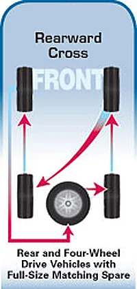

Use the Rearward Cross pattern...

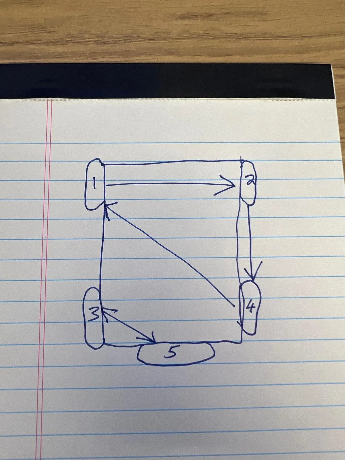

My dealer messed up the five tire rotation, and it sure seemed like it was their first time doing one. This is a direct depiction of what they explained via text (after the fact). I don’t know why they thought directly swapping the rear driver tire and spare would make sense. I should have mapped it out for them. Now I have to see if they’ll correct it to one of the patterns above (or just do it myself).
It sure would be nice for Ford to specify the 5-tire pattern for uniformity across service departments (considering the manual recommends rotating in the spare).
You have a good point about having a “standard” rotation in print from Ford. I’ve seen a couple of different recommendations.
But
I don’t think it really matters how they get rotated or in what direction, so long as you are doing it frequently enough and you are consistent in what direction/pattern they are being rotated in.

Good news is my dealer is offering to remedy the problem. They said it should have just been a clockwise rotation of all 5 tires. That would only require two tires to swap places (in my current situation). For the sake of ease, I’m just going to stick with the clockwise pattern for this set of tires (OEM Goodyears). Will reassess with the next set, but makes sense that as long as you one pattern and stick to it, it should mostly be fine.
