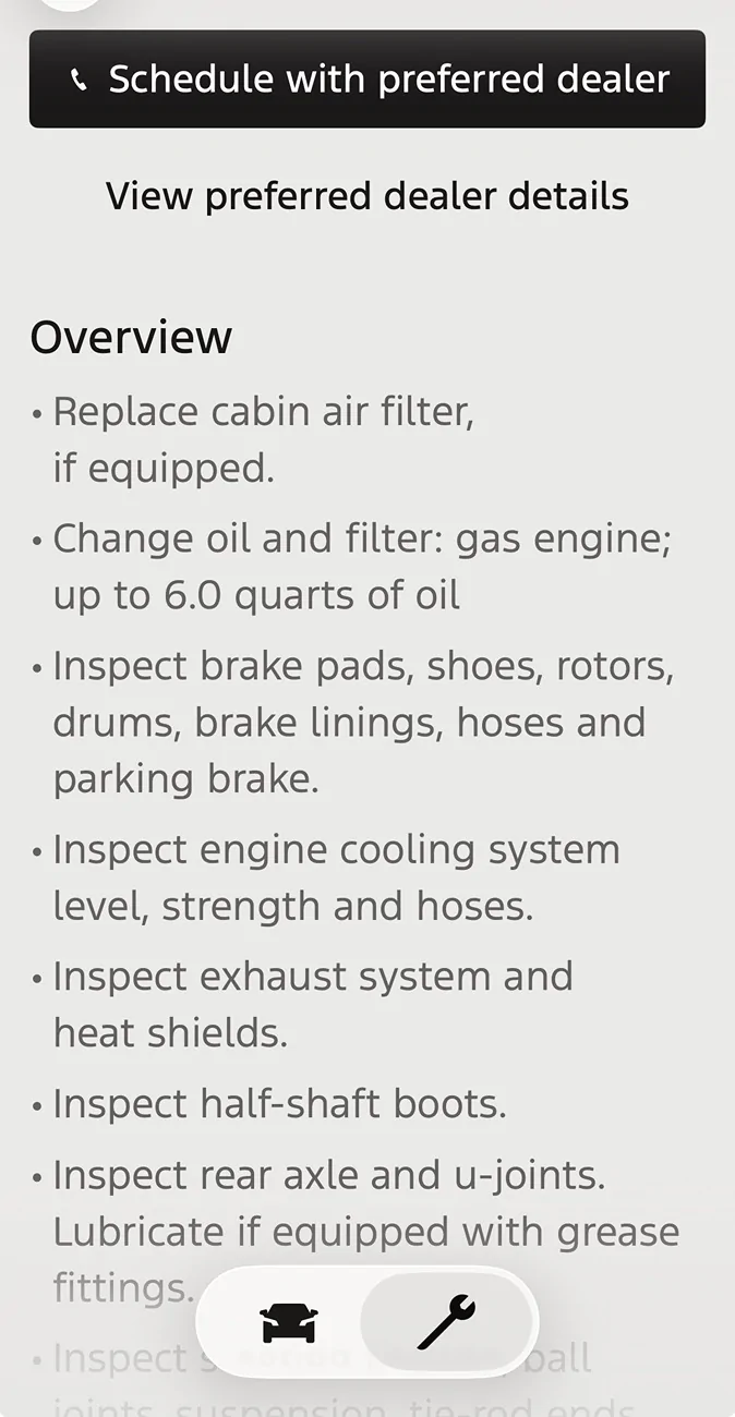

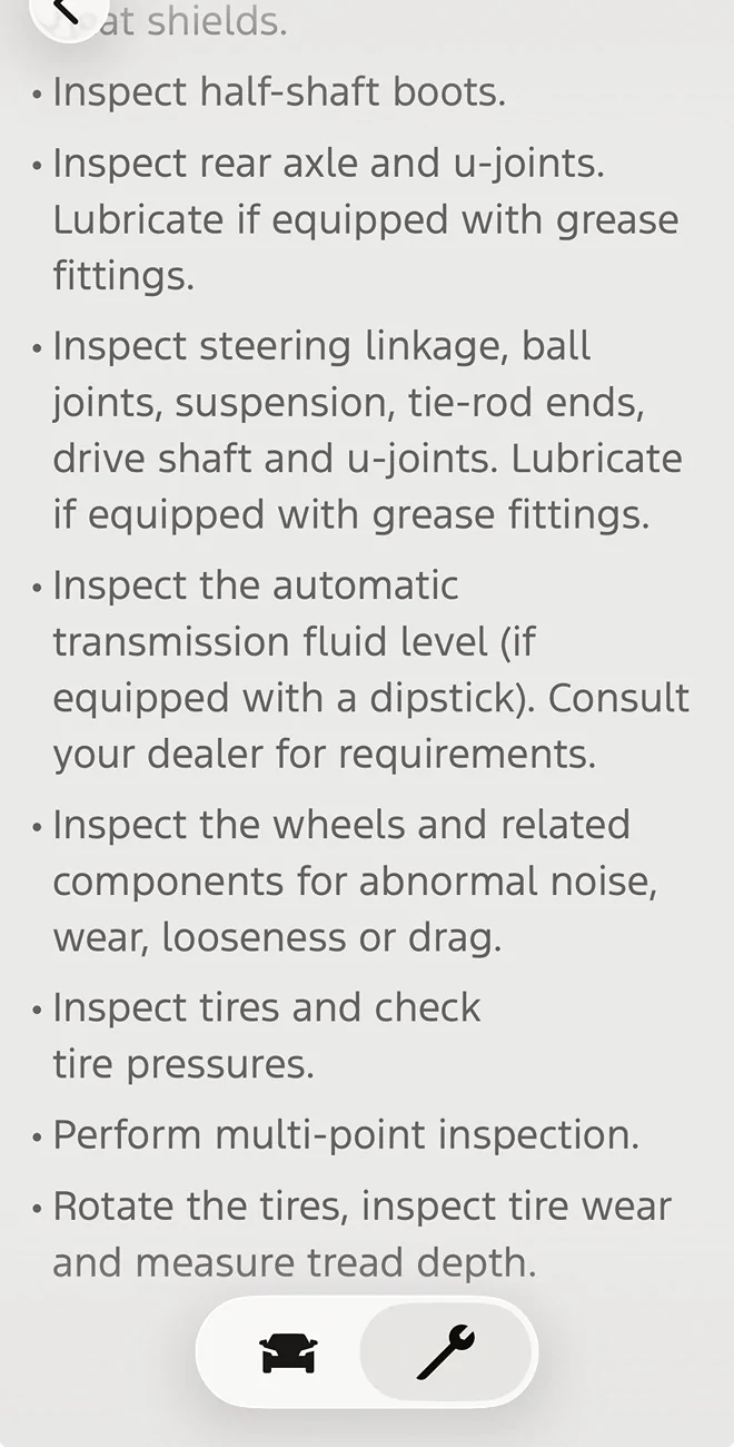

Would that be in the owners manual, or somewhere else on Ford .com? I find it difficult to find in the manual.
It’s in the Ford app, under maintenance (the wrench icon at the bottom).
Ford Bronco Recommended 20,000 mile service items? IMG_0411
Ford Bronco Recommended 20,000 mile service items? IMG_0412
I got full synth oil change & 5 tire rotation and all the “checks” listed. Hopefully, anyway. They recommended an alignment and brake flush. I said no thanks and I’ll do my own engine and cabin filter.

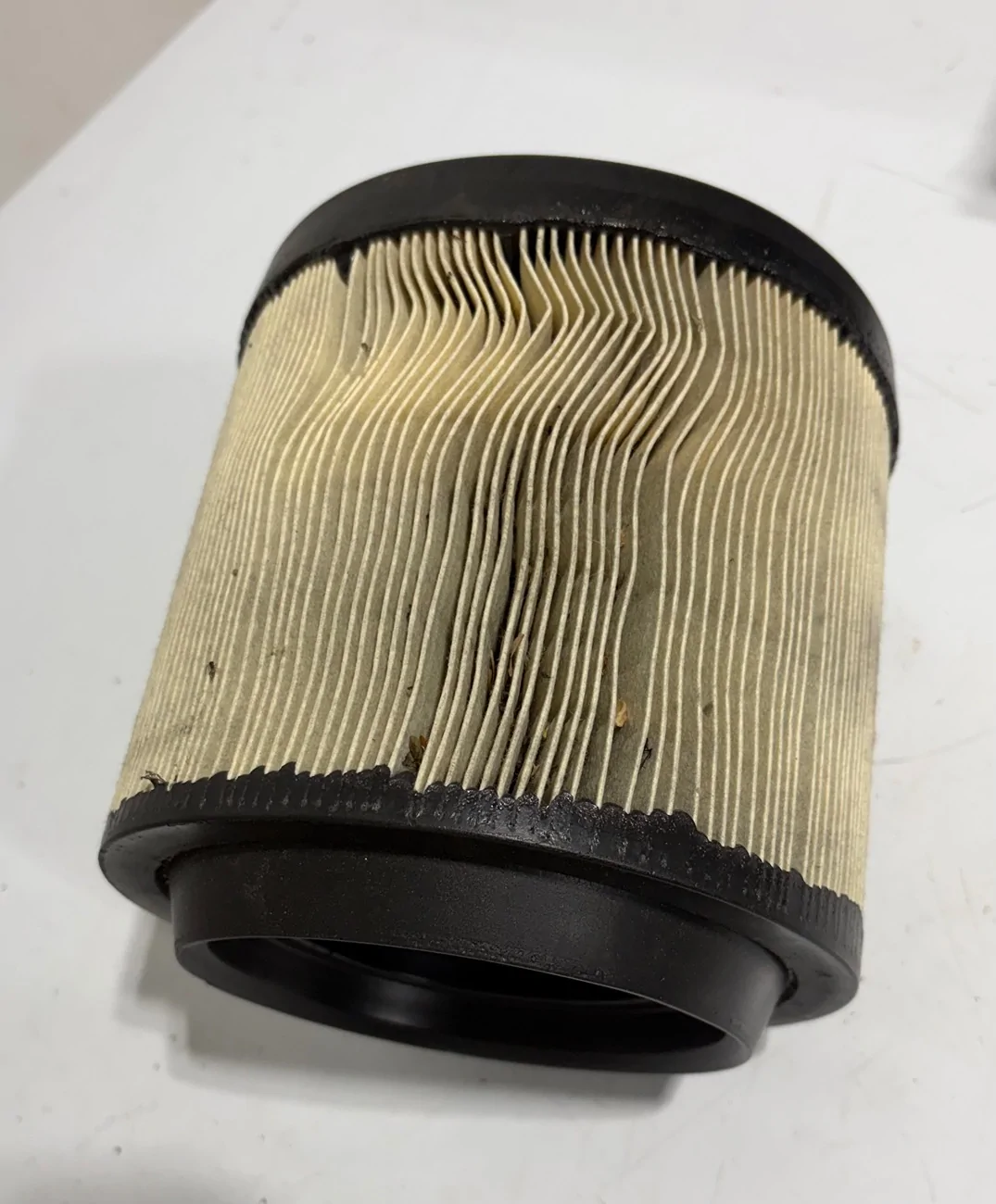

Based on how my original engine air filter looks at 20k miles and 11 months, I’m going to cut that interval in half going forward. I’m in some dust every time I come and go from home.
I’ll inspect it every 5K at oil change and replace it every 10k tops. Hopefully my turbos appreciate it.
