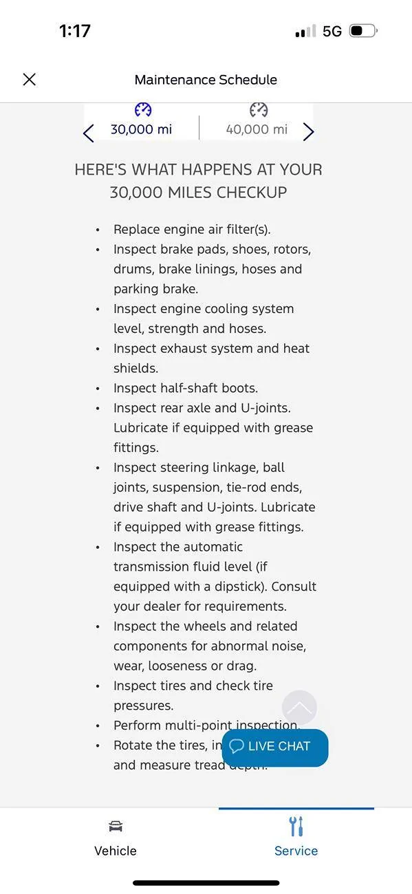

Yeah... so... that's not the standard Ford 30,000 service visit.
30k is basically a comprehensive inspection along with an engine air filter change. Which, to be fair, they did. But the brake fluid, transmission fluid, alignment, HVAC system cleaning, fuel corrosion inhibiter, etc. etc. is all extra service items that particular dealer tacked on as part of their package.
