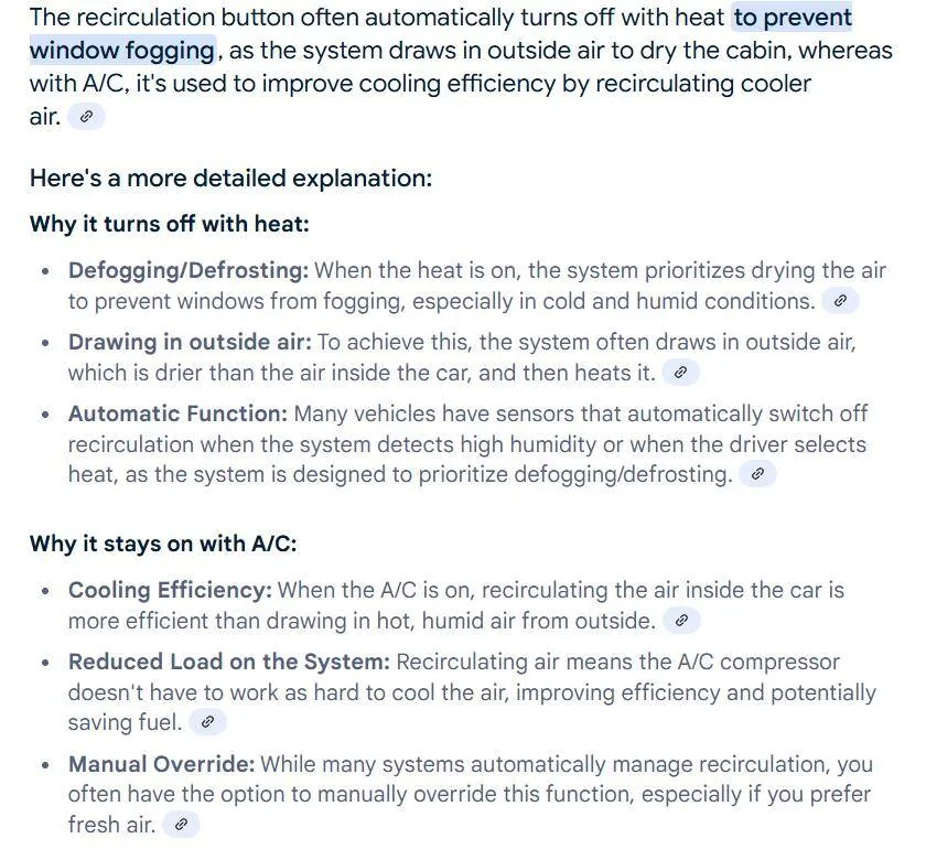

Both of my Bronco's ,23 and 24 year models, will randomly turn off the recirculation button and allow fresh air in the cabin. Fresh air is great unless you get behind a stinking diesel! Any ideas why they do this?
I gotta admit, I've always known it to be this way when using heat and not this way with A/C, so I decided to trust Google and here's what i found.
