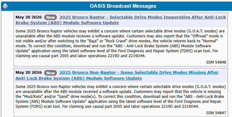

2025 OBX Sasquatch, took it in a few weeks ago for routine service and all the recalls(Brake Booster, child lots, and screen blacking out. I never had issues with any of them.) Last week I was down in the actual Outer Banks, went out on the beach and my Sand, Mud/Ruts, Rock Crawl have disappeared, street modes, Normal, Slippery, Eco, and Sport are all still there. Anyone else had this issue after a recall software update? Brought it back to the shop and they couldn't restore them. Apparently it is a known issue for Ford. Would have had them skip the recalls if I had been aware.
Shop emailed me this:
"We received a response from Ford hotline and they noted that engineering is currently aware of this concern. There is no solution available at this time, but an SSM is being worked on and will be published soon. The are asking us to monitor Oasis which is the Ford information site for Ford dealer's letting us know of current updates and other information. At this time there is no further action that we can take but we will continue to monitor Oasis as requested and once a remedy becomes available we will get your vehicle back in to perform the remedy from Ford. I'm truly sorry about the inconvenience and as I said before, I have not encountered this concern before and we have performed over 300 of these recalls."
So, I suggest you hold off on any recalls that require software updates of you need the off road GOAT modes.
Don't know if you've had this fixed or not yet, but Ford just released this:
Ford Bronco Recall software update wiped out my GOAT Modes 1779279409968-0v

Thanks Ducati1098 - not sure if the ABS update was applied but this sound like exactly what's going on. I have FDRS so I'll jump on this later when I get home. Thanks again
